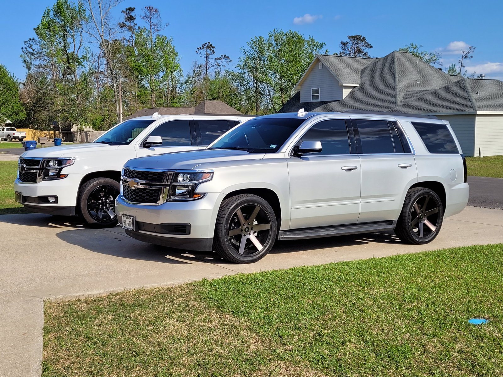

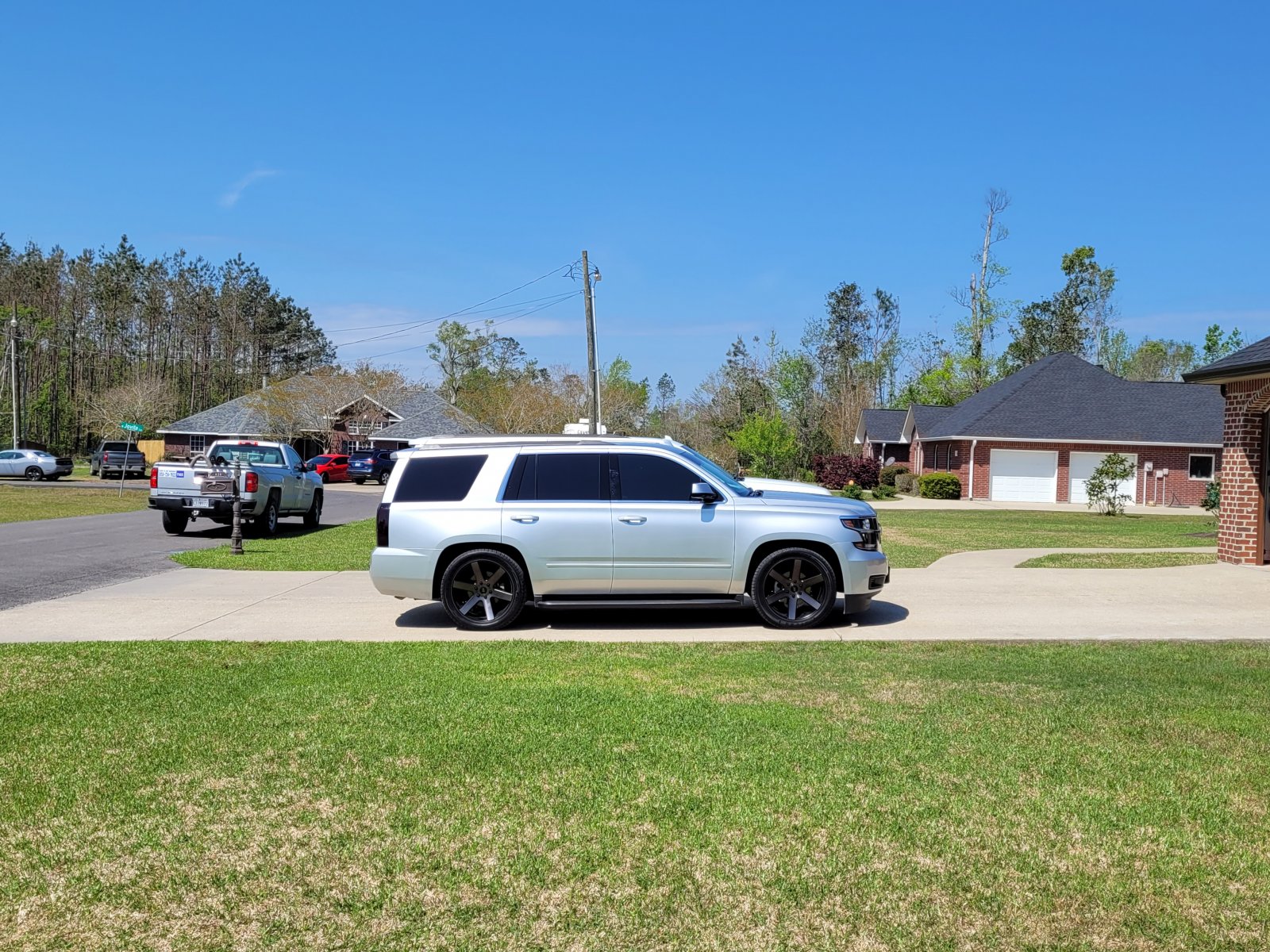

2018 Tahoe LT ( premium smooth rides suspension )
the original intent was to lower the vehicle to a level stance, slightly above the tire.
this is a MaxTrac 2" front spindle w, 4" rear coil and shock extender 20210404_112325.jpg 20210404_112632.jpg

the decision was the rear was to low for a leveled look, the coils measure upon install at 5" drop...knowing they would settle slightly, this ad to be corrected. after a few trips around town, i decided to add a 1.5" rear lift spacer ( had it on hand for another project)20210404_170509.jpg
over all, this made the look we were after. this setup is a 22x10 on a 305/40/22
the ride is as expected, more feed back and a slightly stiffer rear ride (not harsh, but sporty) and could probably use a new shock ( i could easily manipulate one handed)

That stance is perfect!!!!!! Great job....

It looks good. I liked the first set of pictures , clean! Either way , nice ride.
