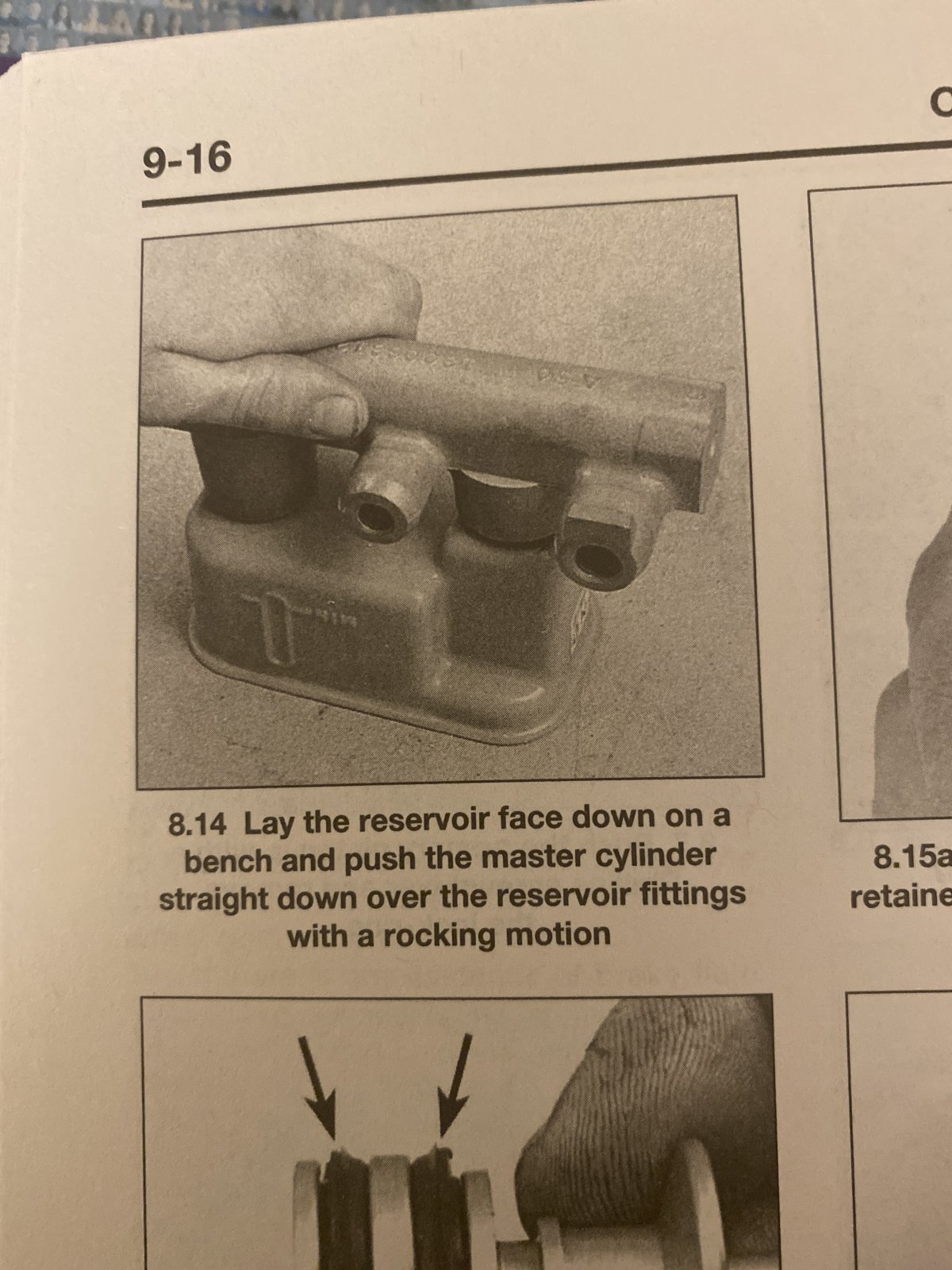

Sorry, wasn’t tracking with you.
You can swap the reservoirs, but will need to support your master cylinder when you press the new one into it. My manual says to do it with the reservoir upside down on a table and press the master cylinder into it.

the most ive ever gotten from autozone or advance auto was a 2 second open box glance close box. ive only ever changed 2 reservoirs on vehicles. first one i had a hell of a time getting it on. second one was similar to that repair manual screen shot. i had a smooth block of wood under it tho. goes in easier if you have something pushing directly against the ports. its plastic so it will try to ned and flex on you so if you have a block of wood or sockets to push again the port holes it wont flex as much.
