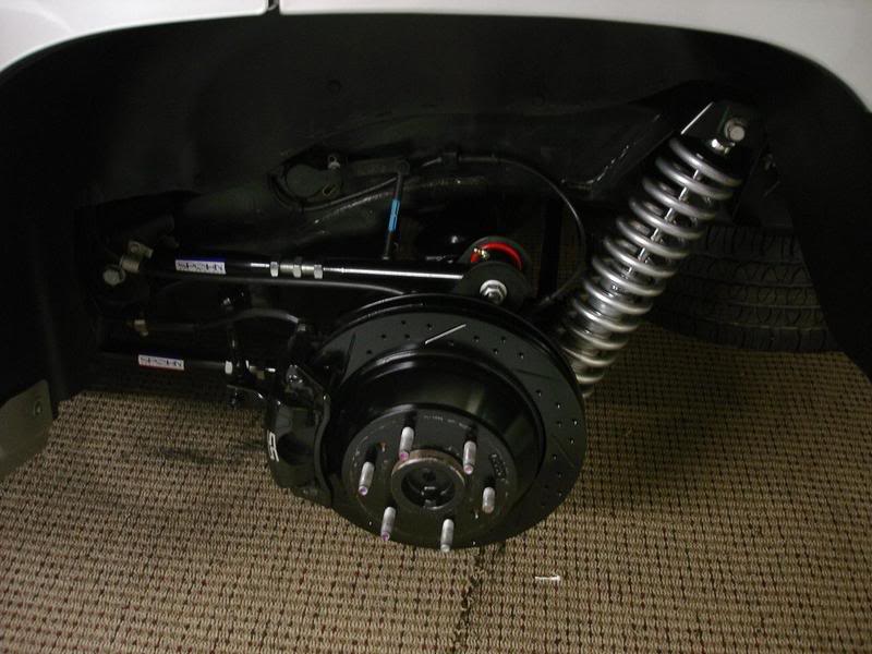

that bumpstop looks like its under pressure... Serge, is there ANY play in the rear suspension? I mean, can you stand on the running board towards the back of the truck and move up and down on it and see if there is any travel? If there isn't, or its still bouncy, your problem is easy. Cut the bumpstops.

I stood on the rear bumper and bounced up and down and the max I can get it to go down is an inch or two. :think:
Btw, are those coils supposed to be squashed like that?

its sitting on the bumpstops just pull the bumpstops out and take it for a quick ride will be much better. You can also cut them down more if you didnt do it at that time

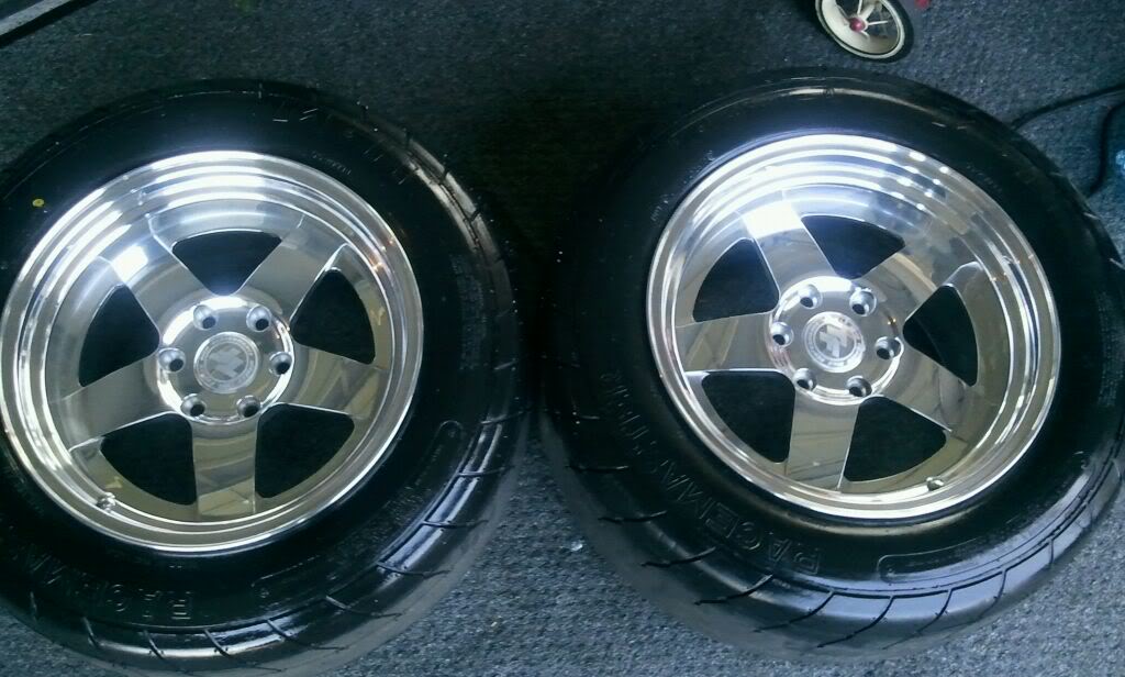

BTW here are some new pics for testing some new tires/suspension mods Im doing to my ride. 17x11 rear with 325 45 17 mt drag radials. Im just waiting for the front 17x5s to come in.
