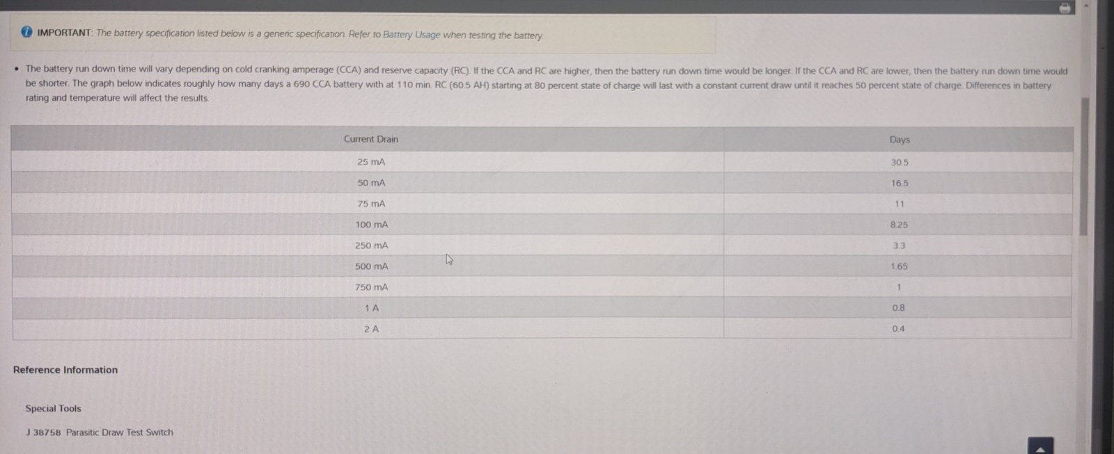

B1527
if the state of charge is 30% lower than last time the engine was running or the 12v battery drain is greater than 2 amps.
the bcm doesn't seem to care until it kills the battery by 30% from the last time your drove it, or the drain is over 2 amps. I'll attach the current drain chart. I'm not 100% sure this is hybrid specific but I did put the vehicle type and year in. but I do find this software sometimes brings up form general info if it doesn't have anything else to display haha.
