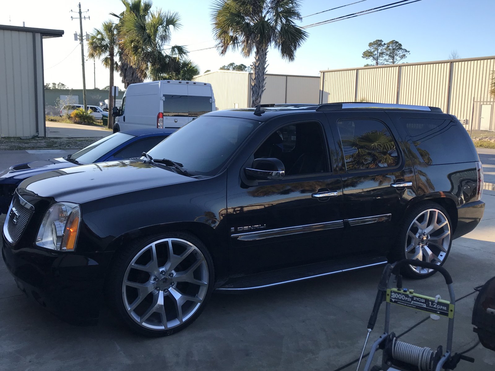

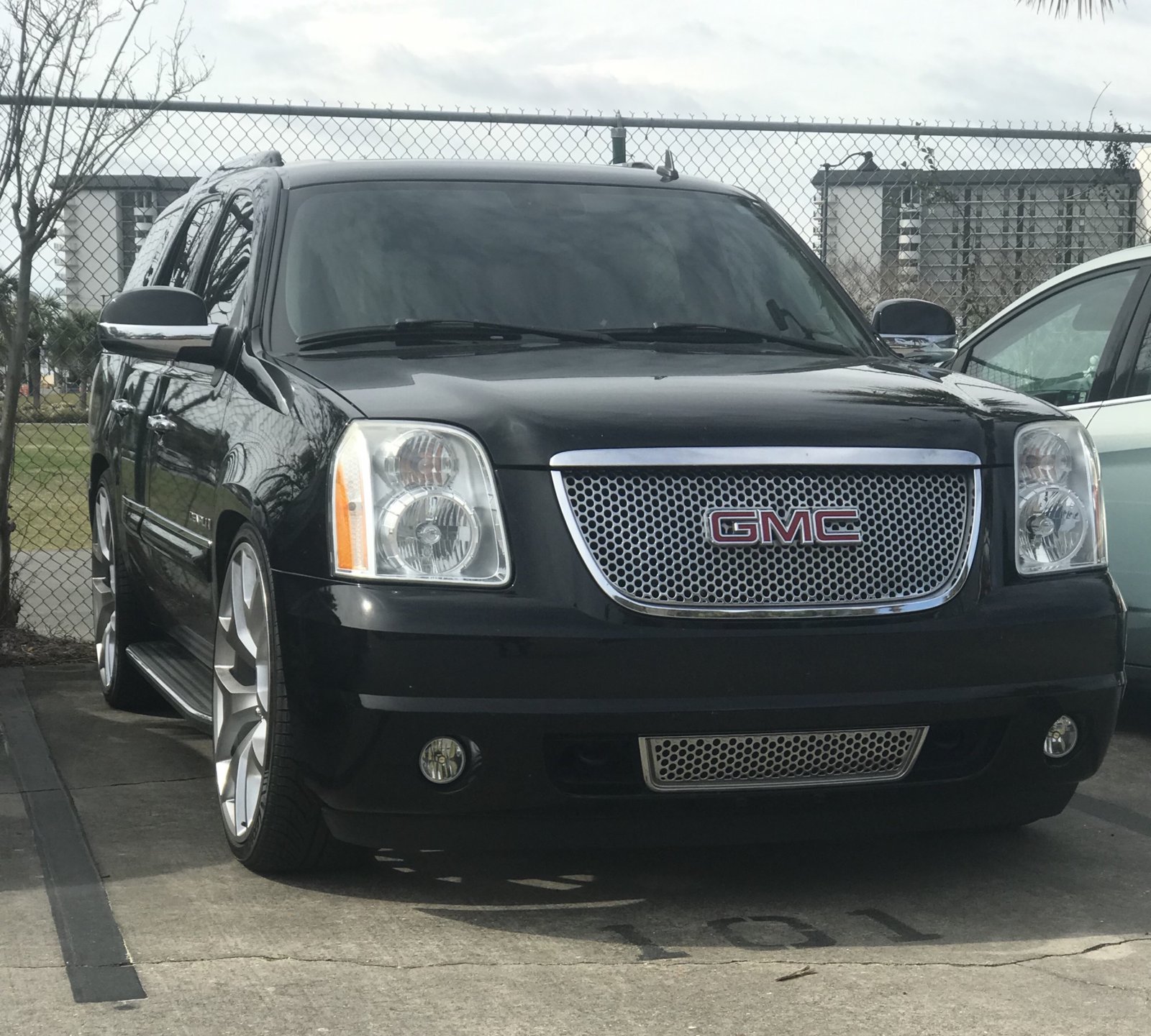

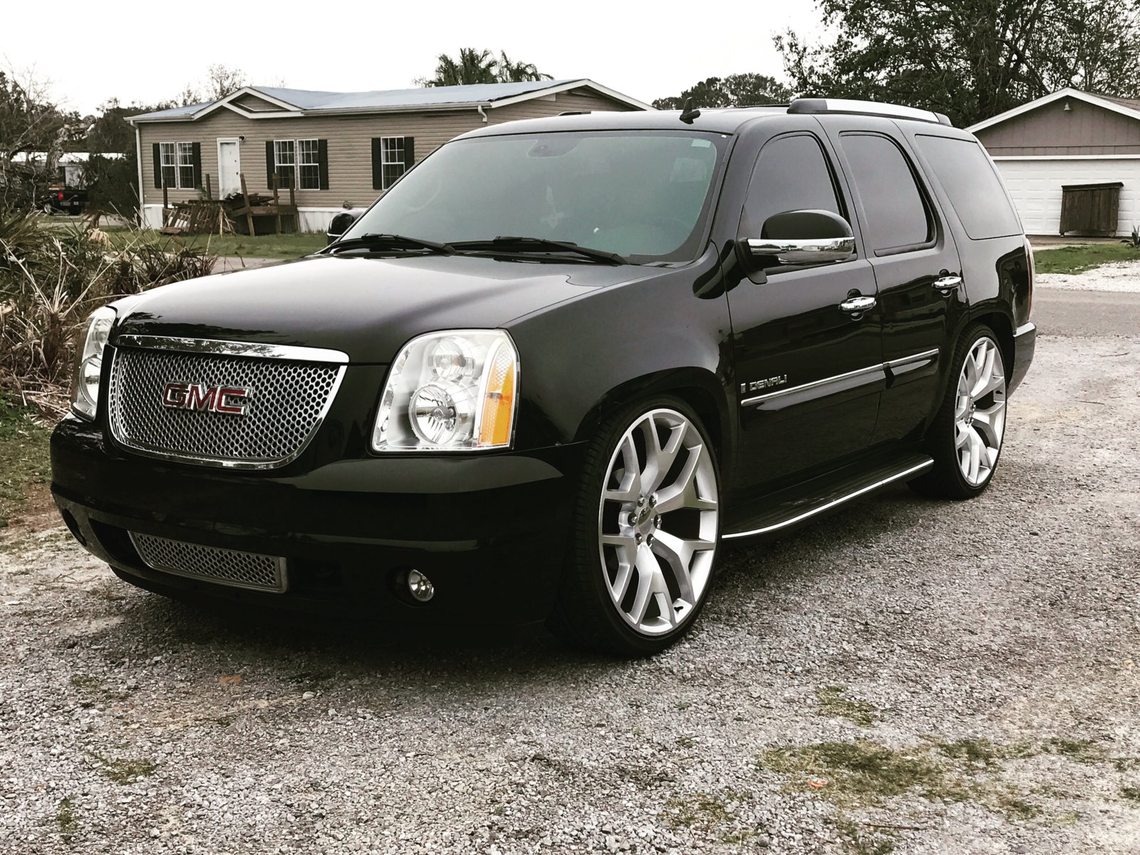

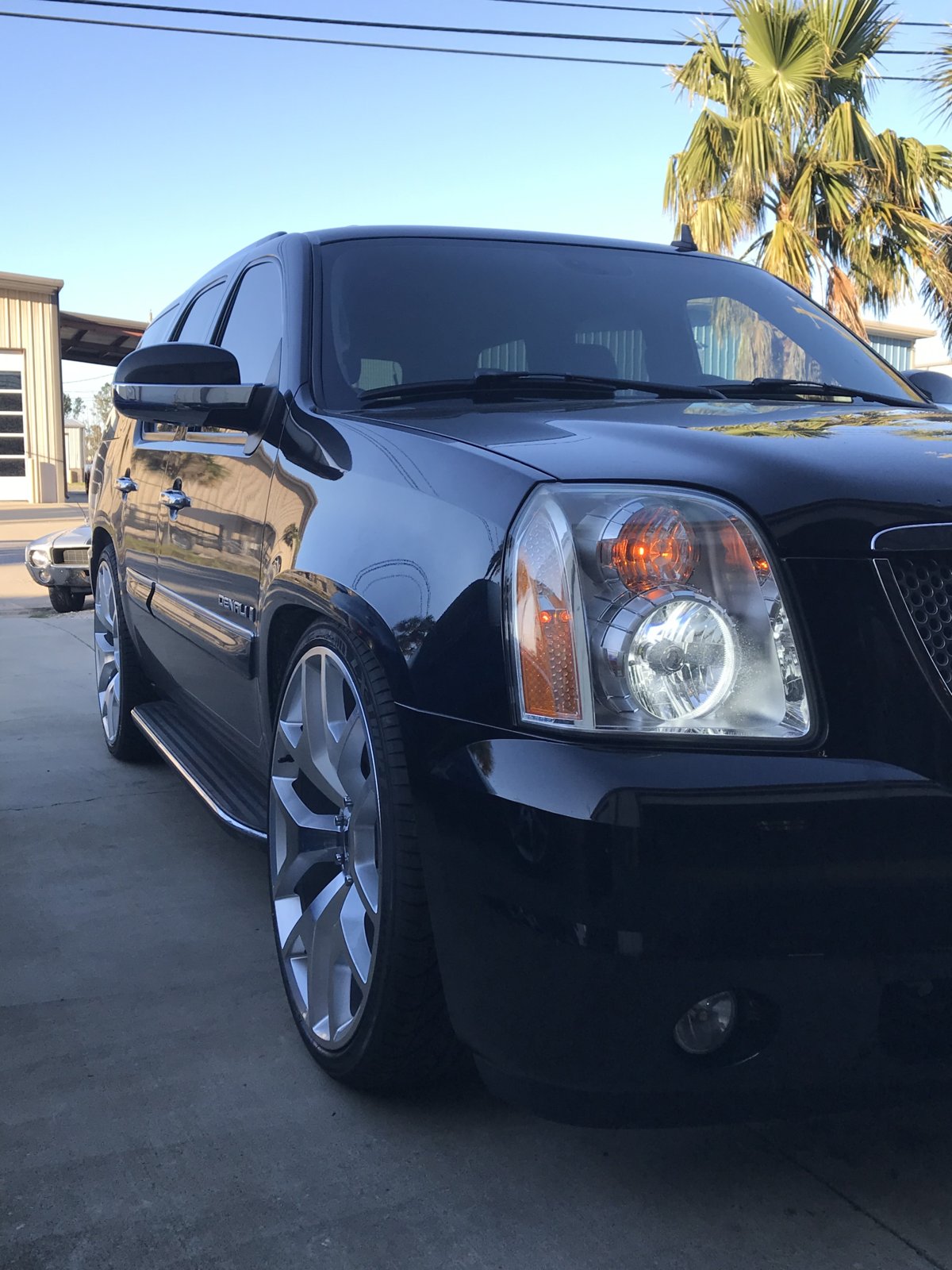

I went with the 3/4 Street Edge Lowering kit. The kit was actually a 4/4 lowering kit if I didn’t use the supplied 1” spacers for the front.
Got the kit put on today, this was the result..
3/4 lowering kit, 26” GMC Snowflakes w/295’s

It took A LOT of inner fender plastic trimming to accommodate the 26’s on the AWD Denali. I don’t know if that’s the case on 2wd’s or 4wd’s.
I second guessed myself 1000 times if I wanted to make the jump to 26’s, I had 24’s on my 06 Lowered Escalade prior to the Yukon. The 26’s are YUGE! Seriously they are big and I’m glad I went with them.

Looks awesome man

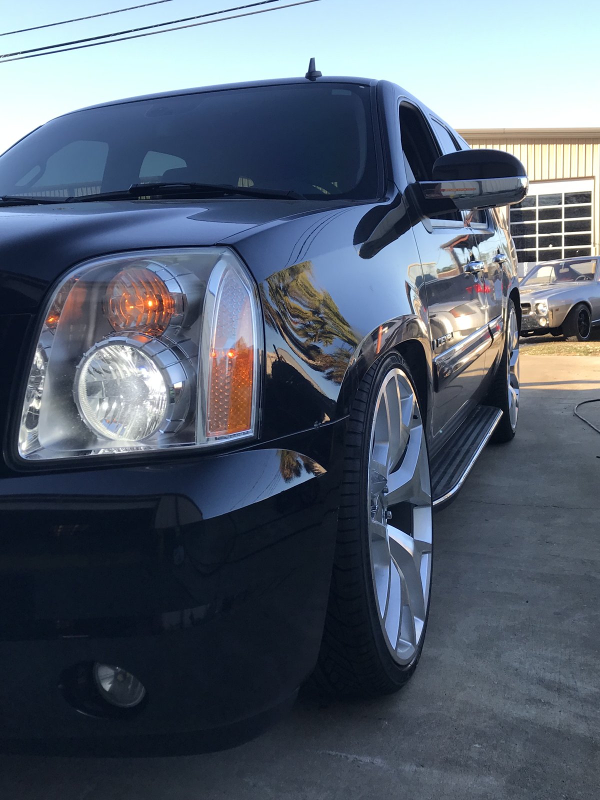

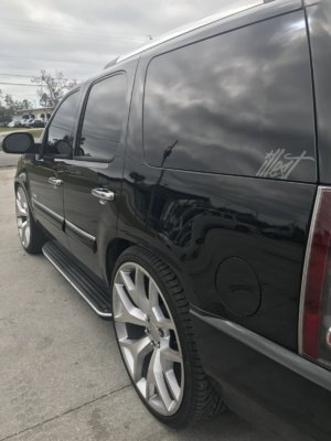

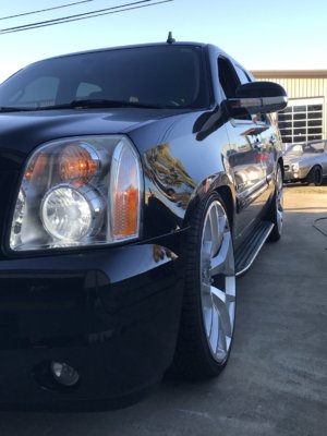

Thank you for the compliments..
So this morning I did the alignment and I prob came up with 3000 new 4 letter words.
I would advise anyone considering 26’s to do a 2/3 drop maximum esp if you’re planning on any daily driving.
On the alignment rack I added a ton of camber and got the wheel pretty well upright, which lead to clearance problems... I’ll come back to this..
When it came to the caster I had to pull the wheel towards the front of the truck to even it out in the wheel well which gave me way better turning radius.
Back to that camber I ended up adding a 1/2” billet spacer on top of the strut hat to make the wheel clear without ripping off the inner fender plastic. Thank god we have a CNC Machine that I could mill the spacer or else I would have to do some serious improvising to accommodate the 26’s.
For a novice reading this thread and considering lowering your Yukon/Tahoe or Escalade... a big thing to consider in calculating your inches of drop, is the inches of wheel and tire your adding above stock.
Example the factory 20 w/tire is like 31.9” total diameter. The 295 is like 33” and change which the added circumference will make a difference in the suspension mods

I was wondering if you had done the alignment after the pics because it looked like quite a bit of camber on the front. I love the 4/6 drop on 26s though.

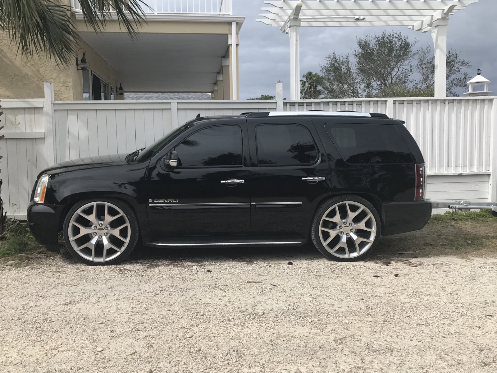

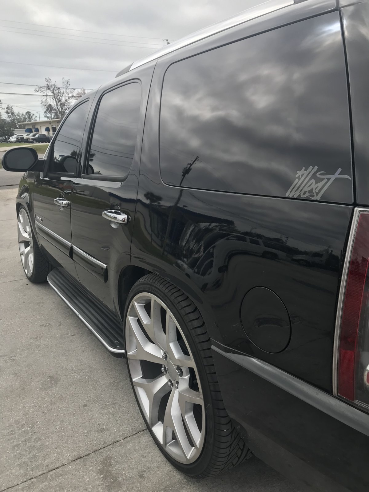

Sweet stance but yes those 26s are like stuffing 10lbs in a 5lb sack. At least you had the means in the shop and skills to make it happen. Not a novice install at all. Post up some more shots from the quarters. Good choice on the machined snowflakes.
The camber didn’t change enough to notice. Even with the billet spacer when the wheel goes up it has to have room to go. With perfect/near perfect camber it would tear off the outside of the fender.
So I left some negative camber in it, rolled the inner fender and called it a day. $500 set of Lexani tires every 2 years is a smal price to pay for that look
I hate chrome wheels bc the first time you have to put tires on, the cheap China chrome peels right off... black wheels are cool, but I was going for a pretty stock look.
I wanted someone to see it and kind of go wtf they made Yukon’s like that? Lol..
