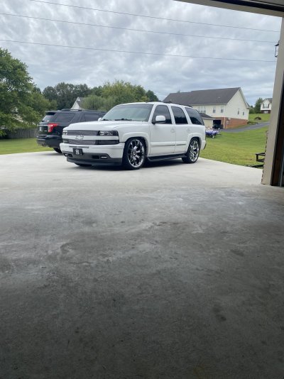

This is how she sits now. Shes in the shop getting raptor lined charcoal gray.
45,014
18x8.5 Silverado reps with 235/55/18 tires is what I'm going to run.

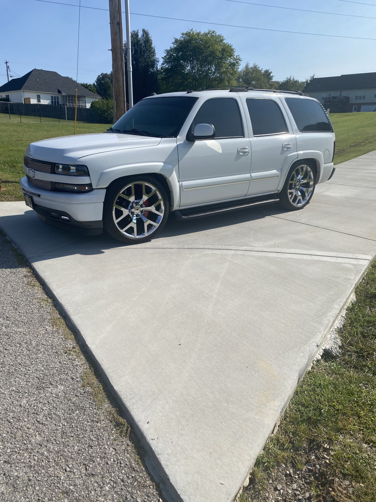

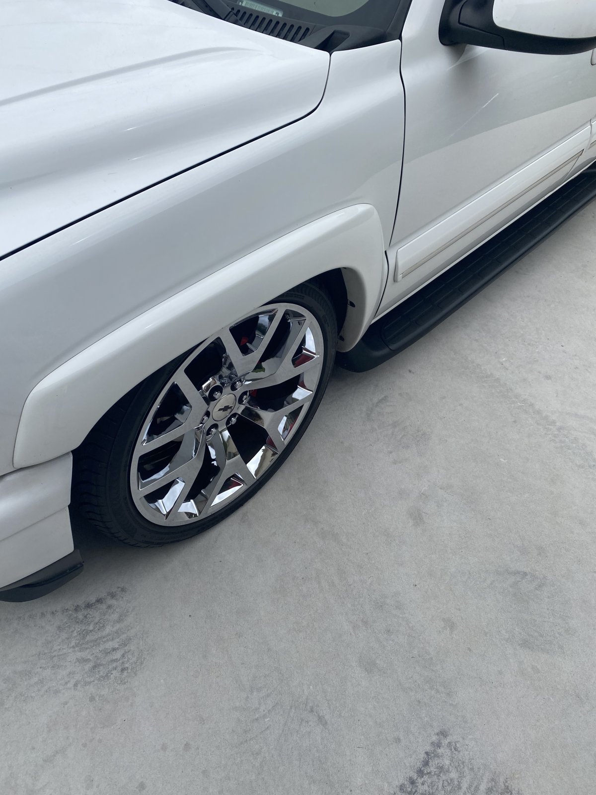

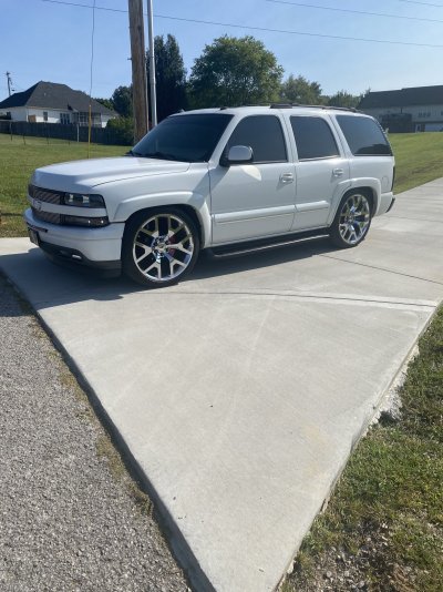

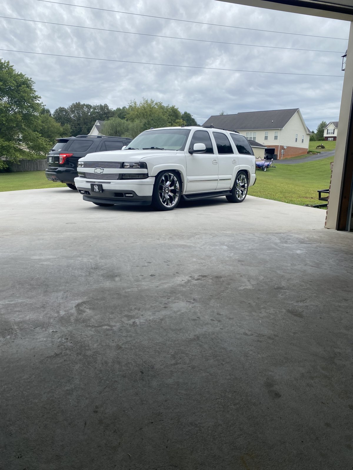

Here is mine. Mcgaughys spindles. I’ve tried many different coils In rear to get the right ride. I’ve probably done more experimenting than a lot lol. I’ve had crown, mcgaughys, and belltech coils. Trailblazer 4230 coils an the best so far 5305 also by belltech. The front has 3/4 ton purple keys and mcgaughys spindles. I’ve also tried 3 different shocks. I just sold my bilstein 4600. I had belltech sp. sold them an got the bilstein. Well I was to low for them. They had no travel hardly so I went back to belltech. I also have Spohn Panhard and fully adjustable upper an lower trailing arms by Spohn. Also did all new ball joints. Upper control arms. Pitman idler an inner an outter tie rods. New bushings. Drilled an slotted rotors. Brembo brakes. They were to dusty so I switched to akebona an that cut the brake dust way down. Also have helper bags in rear also. In case I wanna adjust rear. The set up I have now is the best. I have spent a lot of money getting here. also my alignment is in spec but he said If I went any lower it would be a issue. So I’d have to get the upper a arm bushings or get some upper arms from djm. I may do that anyway cuz the upper ball joints look like they are in a bad angle. But so far they’ve done good.
