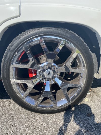

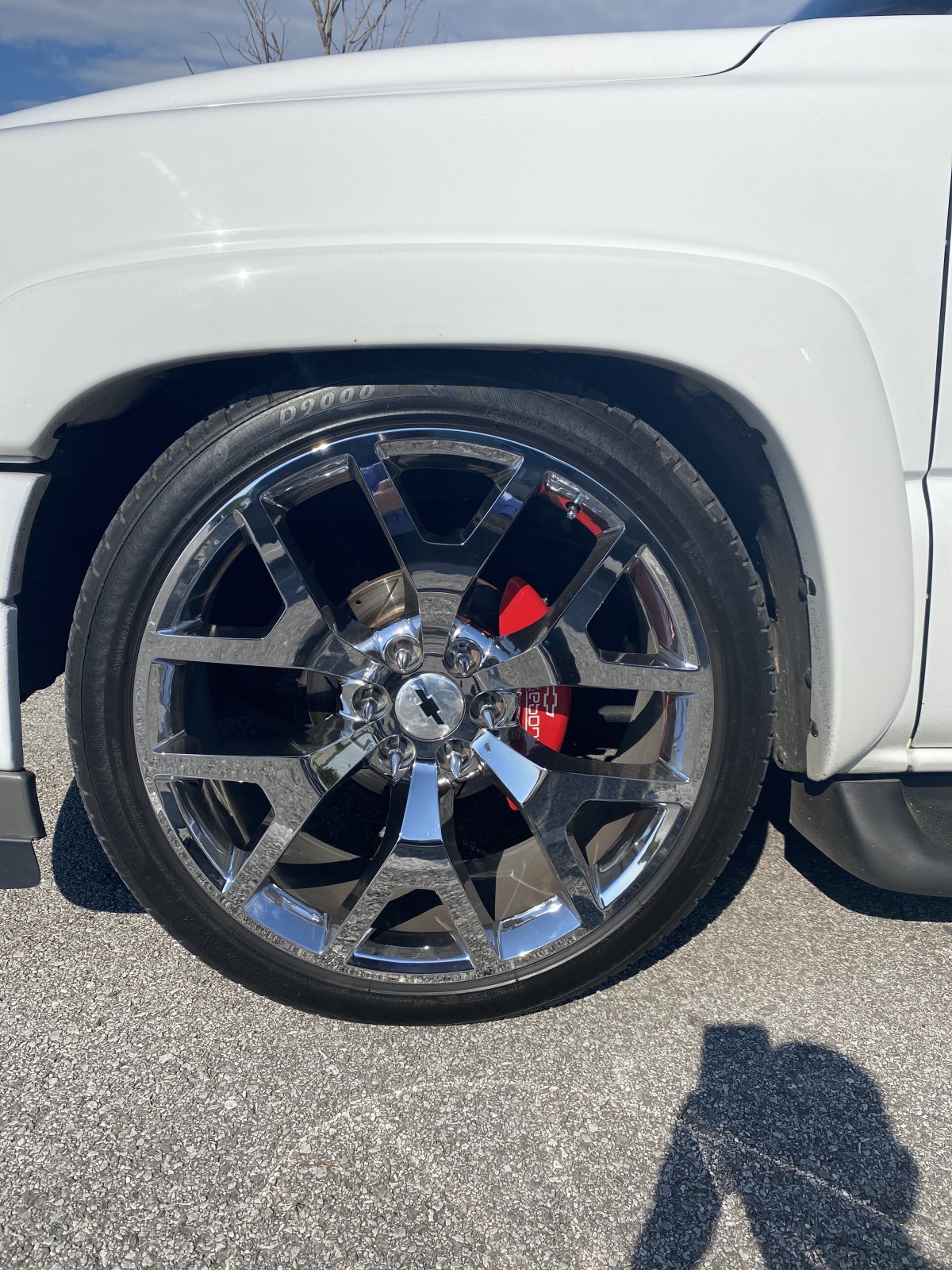

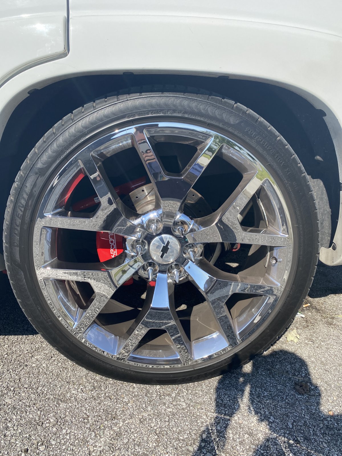

I think I've decided to use mcgauhys drop spindles up front with belltech front and rear street performance shocks and struts. I guess I'm going to try and get the 5305 springs some how.
Here it is. I ordered these an they say 5305 on the coil itself. These are what are in my Tahoe in the picture. I even cut a coil off of the dead coil side. The side that has the coils almost touching go to the top. When they are in an tahoe is on the ground u have about 5 or 6 loops that touch. Those are the dead ones. I cut one out or one an half an that’s where I sit now
