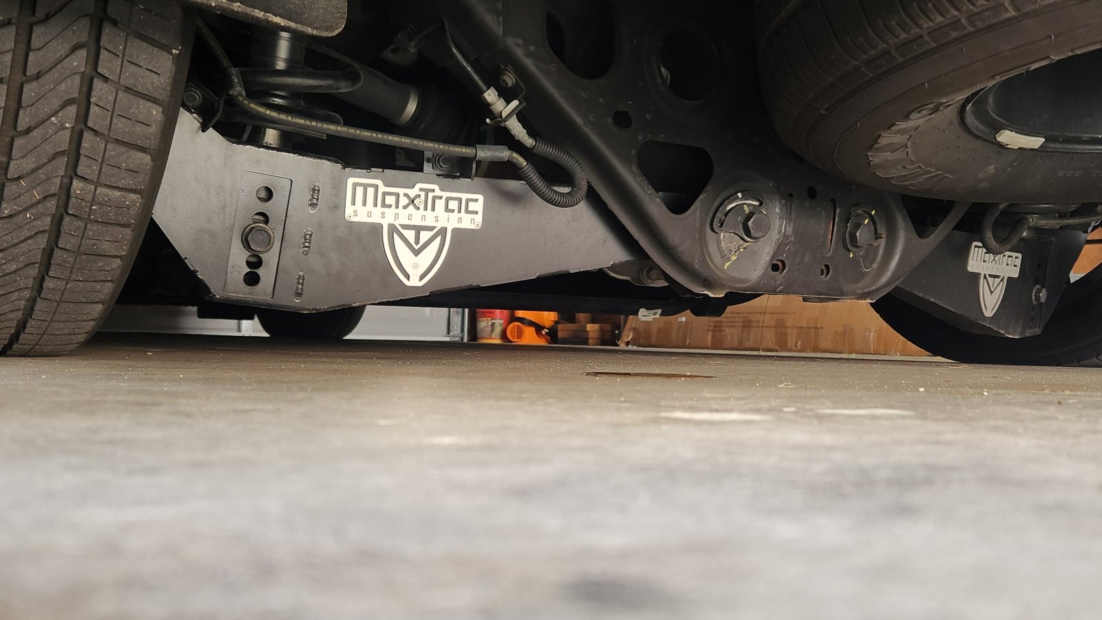

I've strongly considered lowering my 24 Tahoe RST 4WD ( non mag ride ) 2" all way around and have been told to use Belltech drop struts, then was told not to use those because it would hurt the ride to go with Maxtrac drop spindles/adjustable rear lower control arms. Can anybody confirm which would be the best and not hurt the ride?:D

Hey man, the maxtrac rear adjustable lower control arms are a nice ride but they sit too low and you will scrape on everything (know from experience) maxtrac drop shocks will give you 4 in drop in the rear and rides pretty smooth

Hopefully you're somewhere warm where you never get snow. Otherwise, it looks like you could plow my driveway with how far those MaxTrac components hang down!
Whatever the case, the truck looks GREAT.
Unfortunately chicago area they do sit very low but I switch them to stock in the winter, raises it about 2 inches. Thank you

If you get a chance, could you measure the clearance between the trailing arm and the ground? LOOKS like about 2".
I only want a 2/3 drop. Will this result in the trailing arm being higher off the ground than what you have in your setup?
I don't remember the exact measurement but it was a little bit over 2". The arm will sit a little bit higher if you do not go that low but not by much.
The lower control arms will change a little bit, but they only go up and down with height changes on the differential side…at the tires they stay the same height (unless you change tire size).
