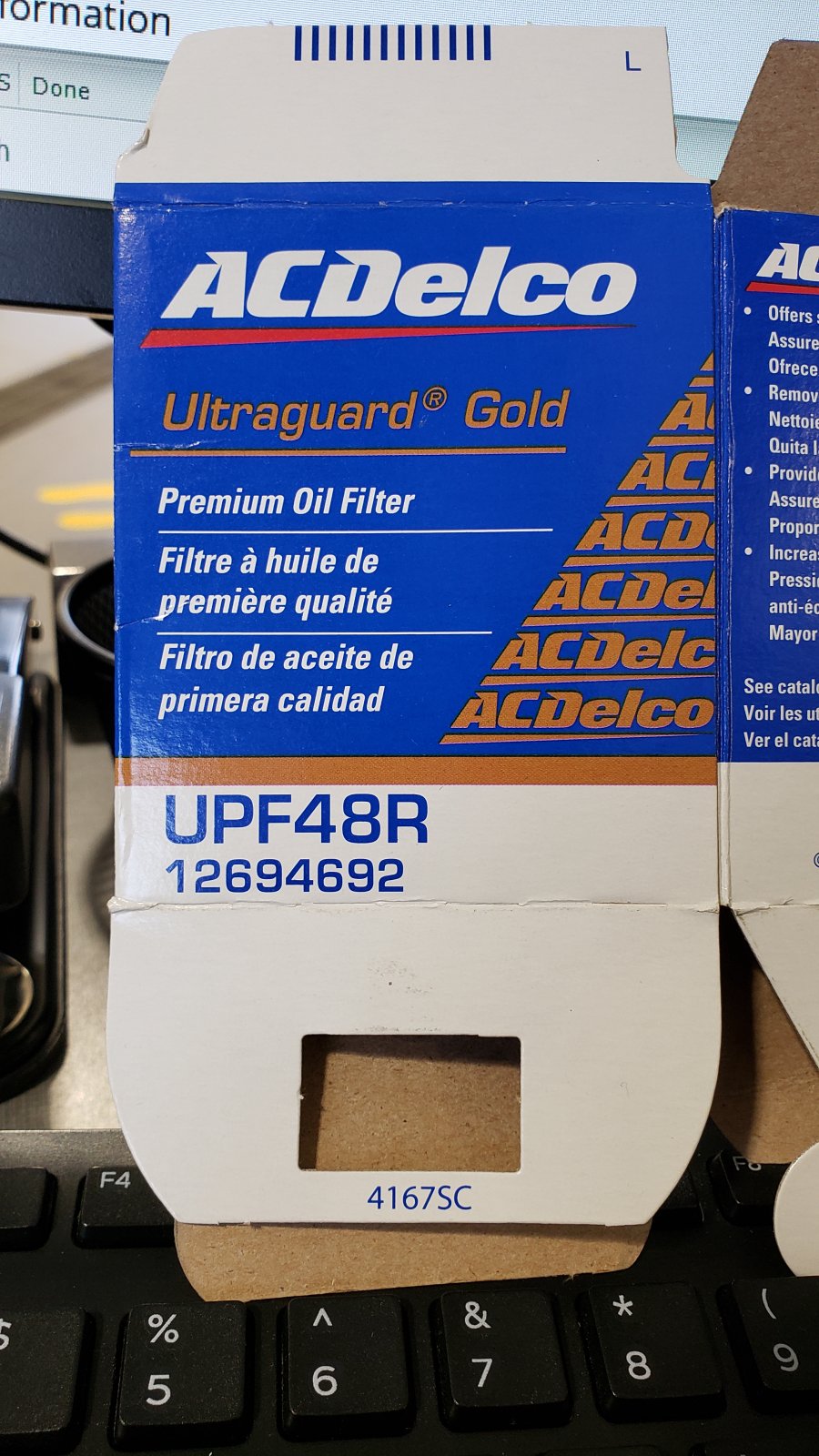

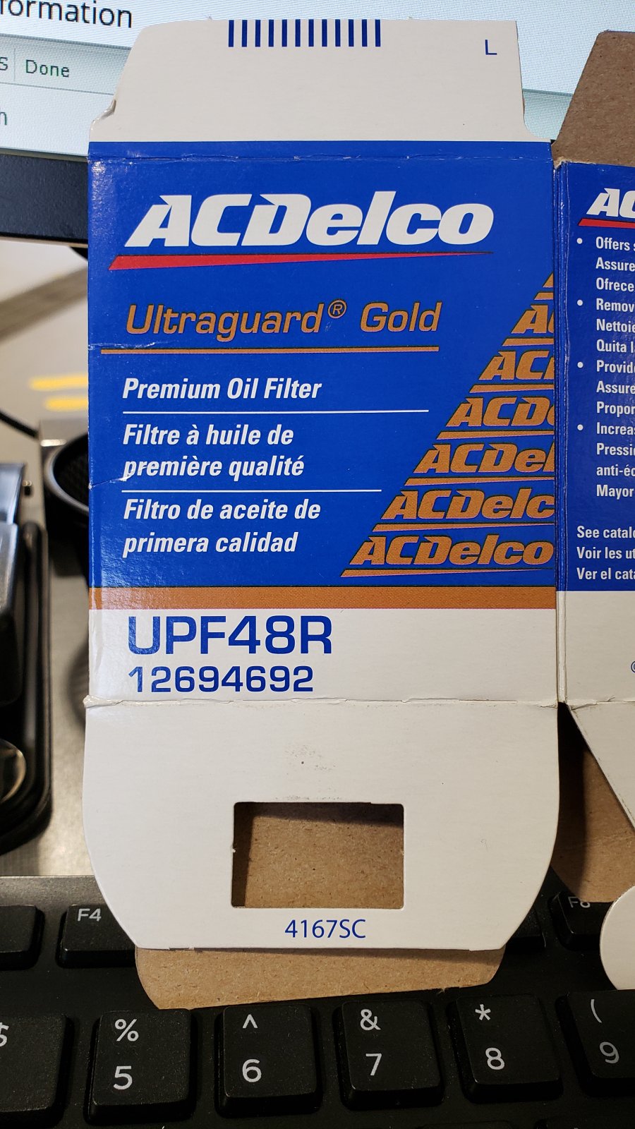

This is the part # my GM Tech stated is the updated oil filter for my 2007 Denali.
