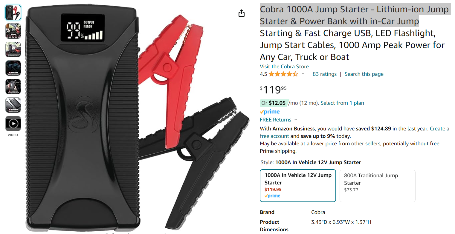

FYI - The Cobra jump starter that didn't work with 6.2L is - https://www.amazon.com/gp/product/B09YMW18CV/ref=ppx_yo_dt_b_search_asin_title
Showed 85% when hooking to battery and engine might have budged an inch but didn't turn over and then nothing during a couple of tries and showed 35% after a couple of minutes. Basically - did not work!
