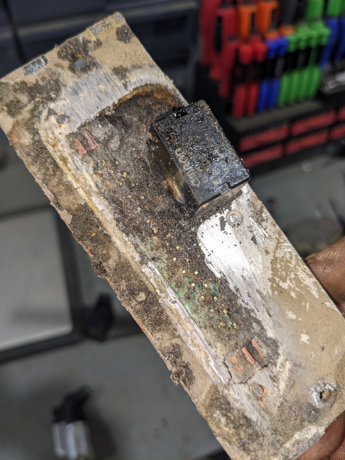

Fuse box under the hood had water under it, where the connectors are. Pulled the fuse board apart and cleaned some minor surface corrosion. Fuse box cradle also swapped from another truck and same issues.

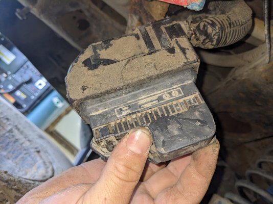

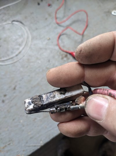

Now the fun part. Standing at the workbench going through schematics... wtf is burning? Look around, smoke rolling from exterior passenger wheel well. Yank the battery negative and dive underneath to follow the smoke. Previous owner had z55 autoride deleted and resistors at all 4 corners were installed where the shocks should be. Well the resistor for the passenger rear was cooked. Melted electrical tape and all. Cut the resistor out and no more smoke.
This is as far as I got. Next step is pull out the suspension computer over the spare tire and maybe that module is gone. If anyone has any useful information please let me know. I think I got the major points but I may add more to the story later.

2 inches of rain in 2 days I guess, big puddles? Really not sure how water got under the fuse box. I cleaned out the board it wasn't that bad really just surface corrosion, I've seen much worse. I'm worried about what may have been exposed to voltage it shouldn't have. I think everything fused in that box is 12 volts so once corrected it shouldn't be too bad. I drilled holes so the water can't collect anymore.

I dried the fuse box out and tried another fuse box cartridge altogether and no change. I'm going to check the suspension module next chance I get, maybe in the morning.

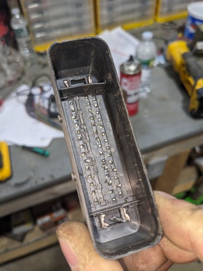

I would check the ecm also, usually those somehow manage to get wet more than a fusebox
