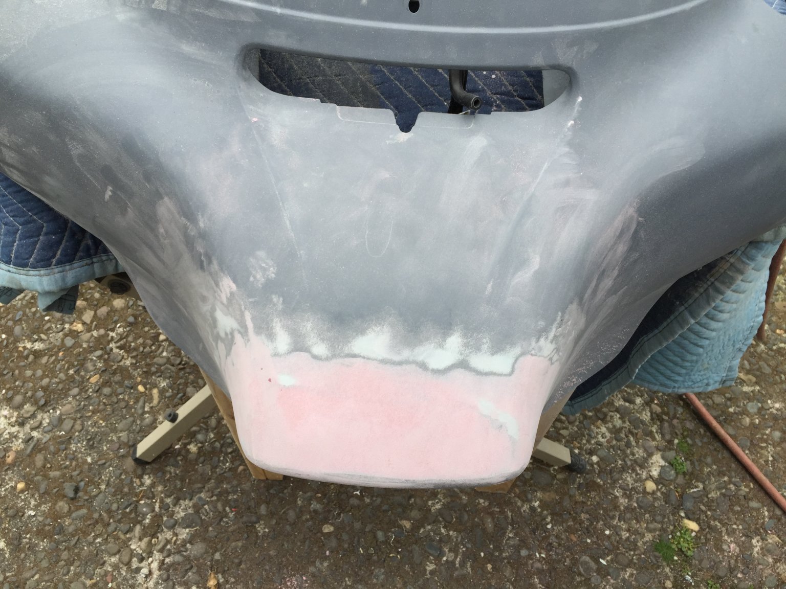

Panel bond should only be used to hold the backing piece in place; something like SEM Carbo Fill would be a good choice to fill and sand out after grinding the edges down to allow feathering. 3M makes the most well-known panel bond however I have used Lord Fusor for panel bond, on recommendation, with excellent results when modifying Harley-Davidson fairings however I found when using the wrong fillers, there was a reaction between the incompatible chemicals and the panel bond was affected.. My understanding is that panel bond is the method recommended by manufacturers for replacing certain body panels in cars and is in fact what is used in the factories for attaching certain body parts. I believe if used properly, it should be a great choice to bond a backing plate to the aluminum or steel of a rear hatch however a compatible filler would be necessary. Here's a fairing on my Street Glide I cut apart and stretched to rake it. It was spread 1 1/2" at the top and panel bond was used along with fiberglass cloth to bridge the gap and bond the pieces together, then Carbo Fill added after and sanded out. It's extremely strong and has help up well for 2 ye IMG_2941.JPG IMG_2946.JPG IMG_4340.JPG ars so far.

Yes, that's what we do - panel bond is used for the filler metal - not to be used as a body filler. Skincoat of poly putty on top and you're good to go.
Bikes look good by the way!

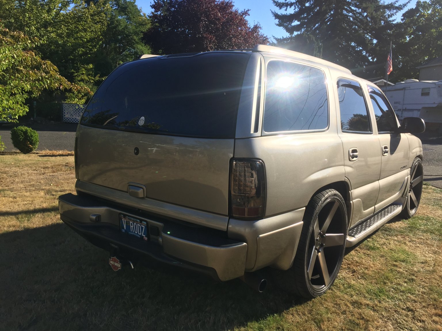

Thanks guys. Now if I can just get the courage to shave the rear wiper on my Denali myself! It's kinda different since I need it as my DD.

I know this isn't a "true" shave by removal, fill and fair, but figured I'd post it up for you see in the meantime.
I've seen a couple other guys on here shaved completely smooth, but no reports based on what you are asking. Even with the plugs, it has not let me down since last fall and achieved removing that dangling branch wiper right now to satisfy that urge. Good luck
What type of plugs did you use, where can I find them love that look. And I don't have to do any welding or body work for the time being
