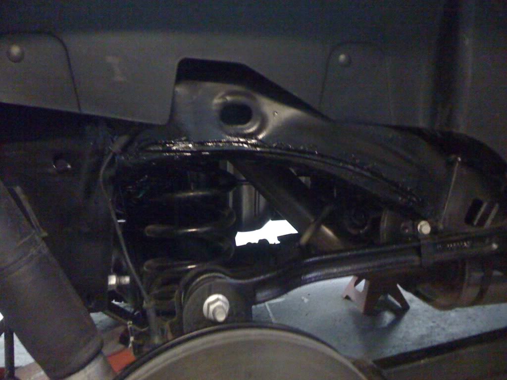

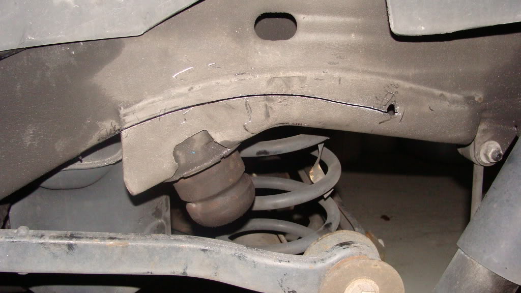

so the free travel mod is cutting the stock bump stops off and replacing them?

here you go after pic
and before
