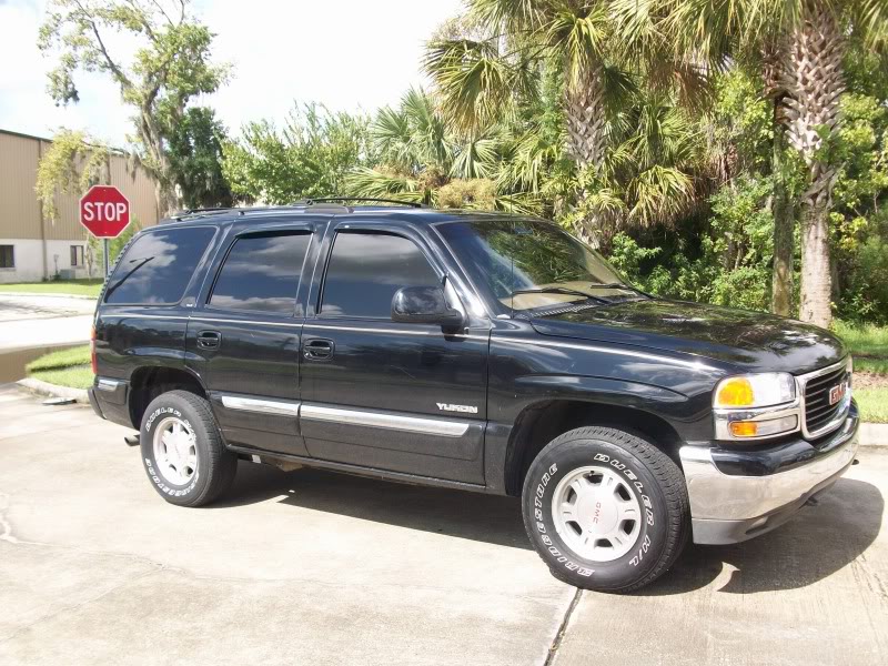

I picked up these parts off craigslist. Are there any other parts I'm missing? Guy I got them from says it's a 3/5 drop????
STOCK:
RIMS:

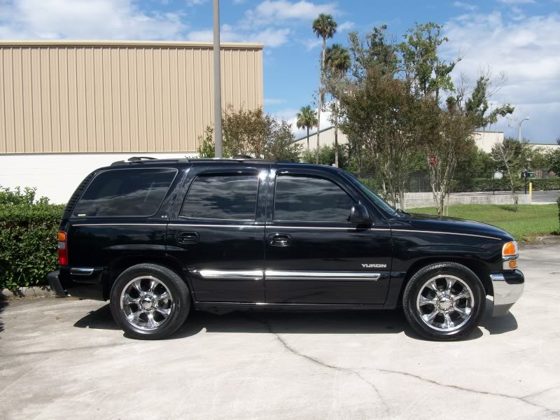

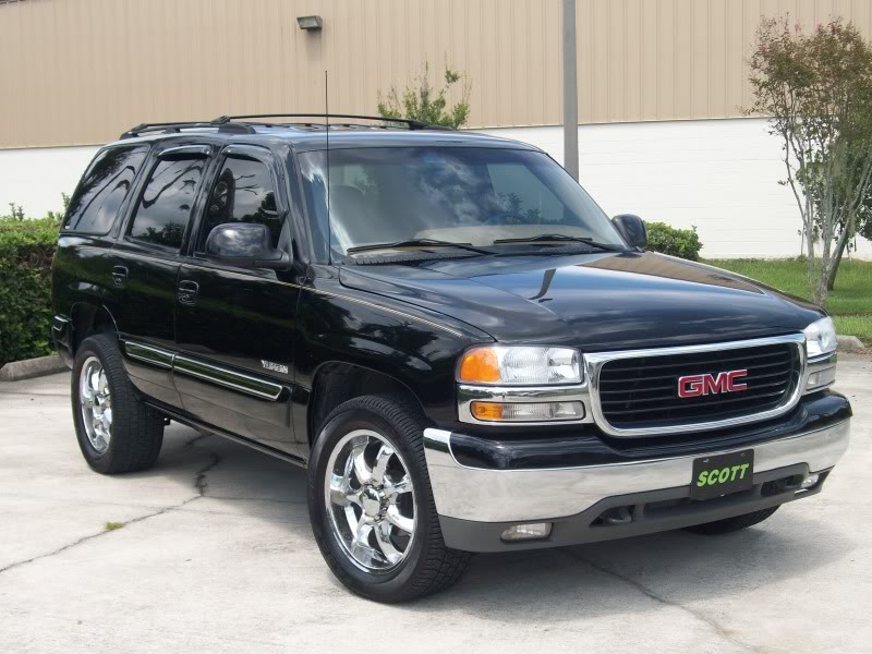

RIMS AND LOWERED:

Looks like it's all there. Keys for the front and coils/extenders for the rear.
JKmotorsports
Rollin the boosted grocery-getter
Apr 29, 2009
2,417
157
Austin, TX
You can do a 3" front w/o spindles, but your camber and toe will be way off, and mayb even enough to where you might have a hard time getting your camber back within spec if you use just keys. 3" is right around where some people can get their camber back to spec and some can't. IIRC, Max got his camber back, but when I had just keys in the front dropped around 3", my camber was maxed out and I couldn't get it close enough to neutral so I went with spindles later.
B
benztrk
Sep 8, 2009
121
Central FL.
cool, I guess I'll put it all together and see how low I need to go with the front to match the rear. Do you know what the overall measurement is for the rear coils. The ones I got are around 9" overall, so how much of a drop is that from factory?
