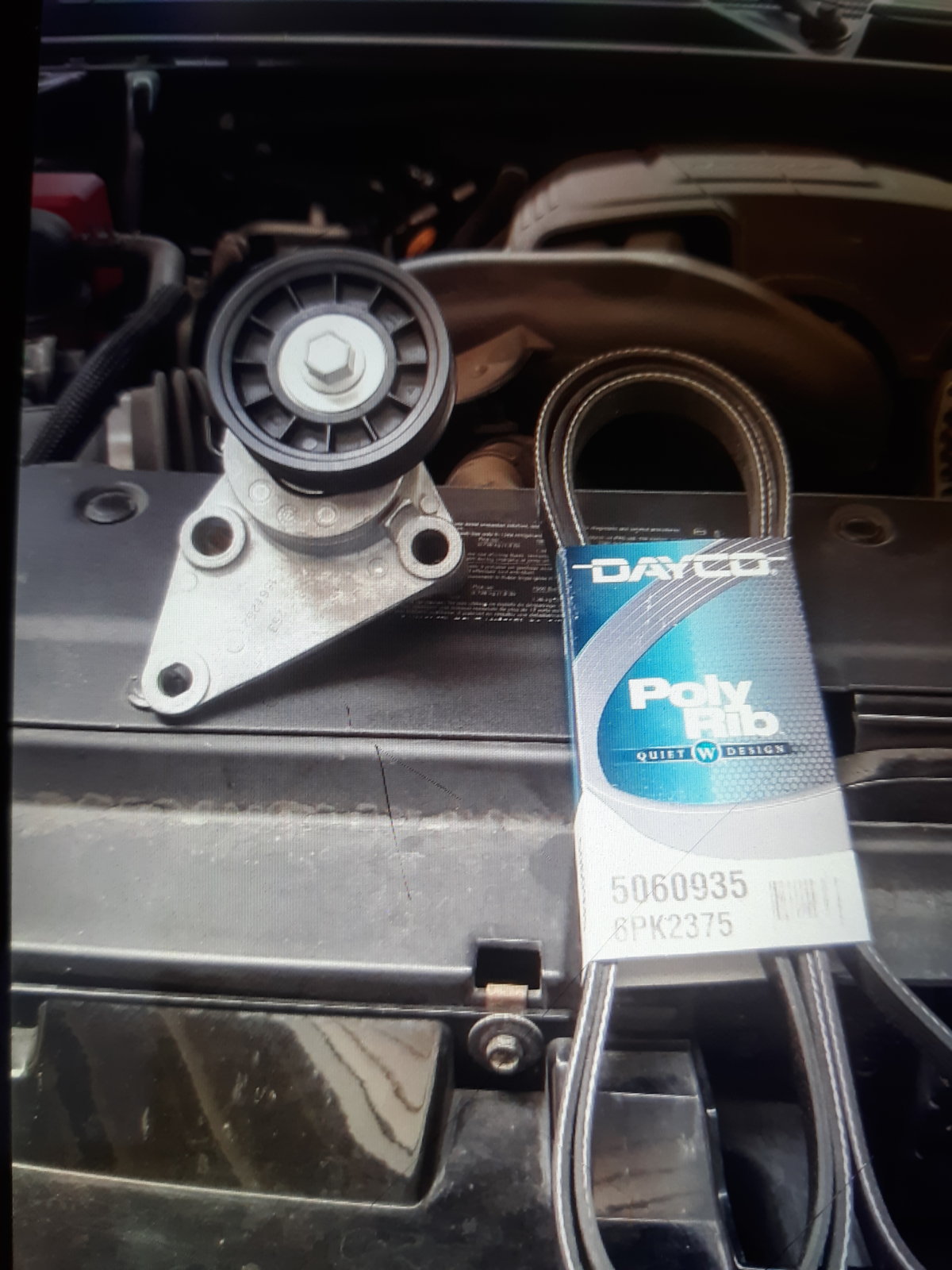

Will this toss the timing off? The pulley exploded and now dhe run rough! Any thoughts? Anything I should do after I make the repairs?

Thats just a serpentine belt fir your alt, water pump pwr steering. Will not affect timing at all. Timing chain is under a cover under water pump. Prob running rough bevause alt not turning and computer is confused as to what is going on and water pump not turning, prob a ***** to turn also. Dont run it too long or youll drain the battery and overheat the motor from no waterpump

At least its an easy diagnosis and fix...new tensioner (or just pulley if being cheap) and belt and done.
Yeah I was going to replace belt and tensioner. If this one blew up should I just replace all the pulleys that are plastic? Any idea why it blew up?

Age, time, etc.... it happens, it may have just been on its way out and you never noticed....When the belt is off just spin every pulley by hand to make sure every spins free and makes no real noise. You wont be able to spin a few so after belt is on eyeball and listen to be sure it sounds right. Your prob good, it just may have been time for that one to go. Good luck

Also manufacturing defects. They could of made a bad batch. Bearings go bad all the time. No need to replace them all unless they all making noise, but that’s very unlikely scenario.

easy fix, you just grab that with a 15mm socket (I believe that's the size), twist and get the belt off then just R&R, probably run $35-40 at the parts store

@Wambliokiye, I'm not sure if I'm seeing this correctly, but shouldn't the tensioner have a grooved pulley? It looks smooth in your first post.
I can’t remember if the tensioner goes against the back side of the belt, I think it did on one of mine in the past, but I can’t remember which model/engine. Thus no grooves.
It was running on the bearing that the grooved pulley has inside of it. This is the new stuff.

Wow! So I hope you got the picture! Lol sorry, dont know why it sent so many.
