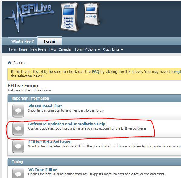

It looks like once you get to the forum page you need to get out of the Help forum and go to Software Updates and Installation Help.

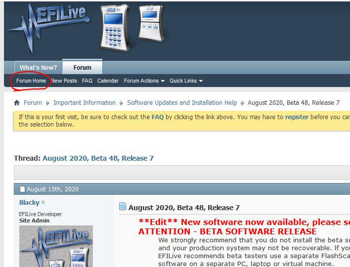

Click on Forum Home:

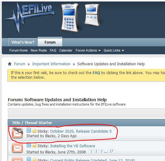

Then:
And:
Once you're in that thread there are links to V8 and V7.x to download.
