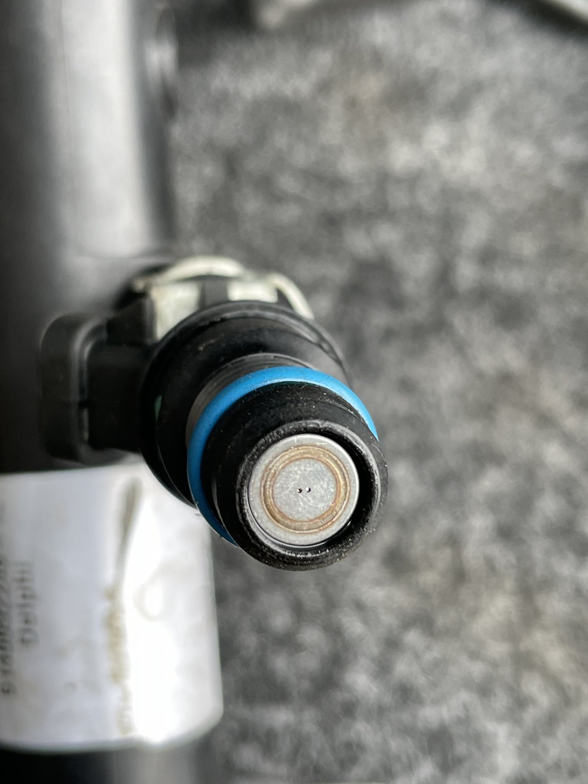

Sending off all 8 injectiors to this cleaning service. Comes out to about $10 per injector. They don’t give flow rates or anything special but have good reviews and I’ll update if my LTFT improve from the -10 through -3 I’m currently seeing once they are clean and reinstalled.

Received my cleaned fuel injectors back with new upper and lower O-rings although I had to replace the lowers with the originals as the O-ring they included were just a little bit too big and I couldn’t get the injector all the way in the intake.
The place I used only charges $9-$10 per injector after shipping so they don’t include flow rates.
My injectors do look much cleaner and they replaced the screens inside the injectors and the lower plastic caps.
After all this, my fuel trims are now taking away even more fuel, -12.5 at idle but -3.5 to -9.5 driving. I’ve only driven it once since resetting the computer as the battery was unhooked for a few days.
Suburban runs the same. Will see if there’s any fuel mileage improvement, but I would assume the injectors were dirty after 170 K miles and 20 years.
