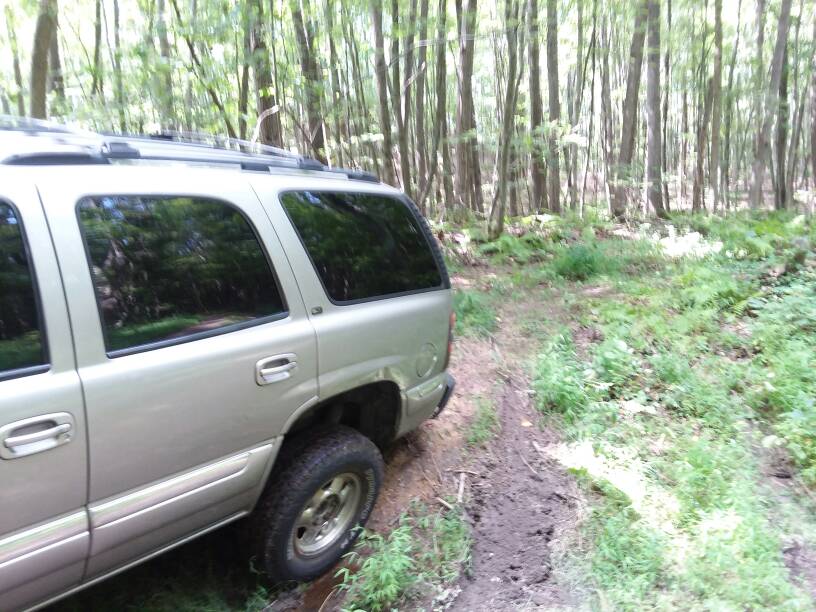

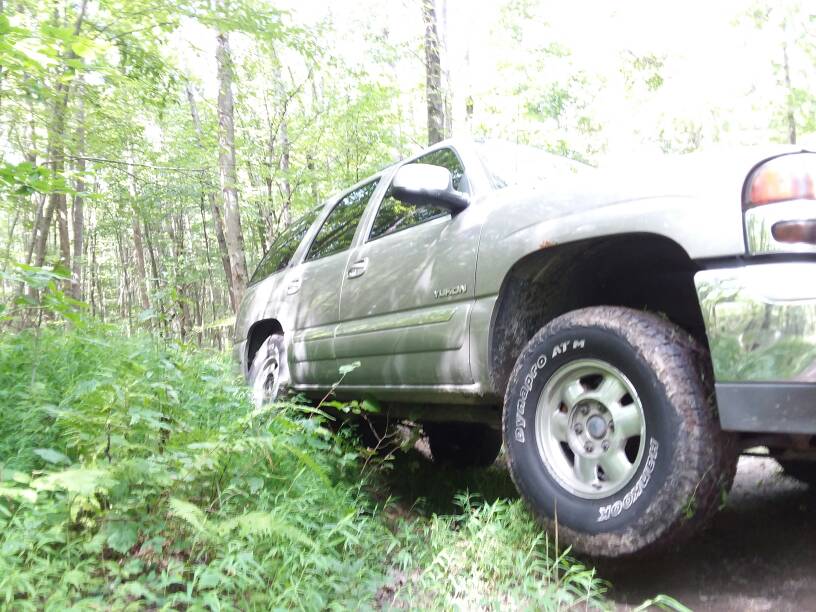

Awesome lol. I tried taking mine off-road (it's stock) and through some mild mud, rocks, etc. It was way too easy in 4x4, and made I made it fine with very little spinning when I tried it in 4x4. Once I put some mud radials on it I think it will get plenty of traction.
