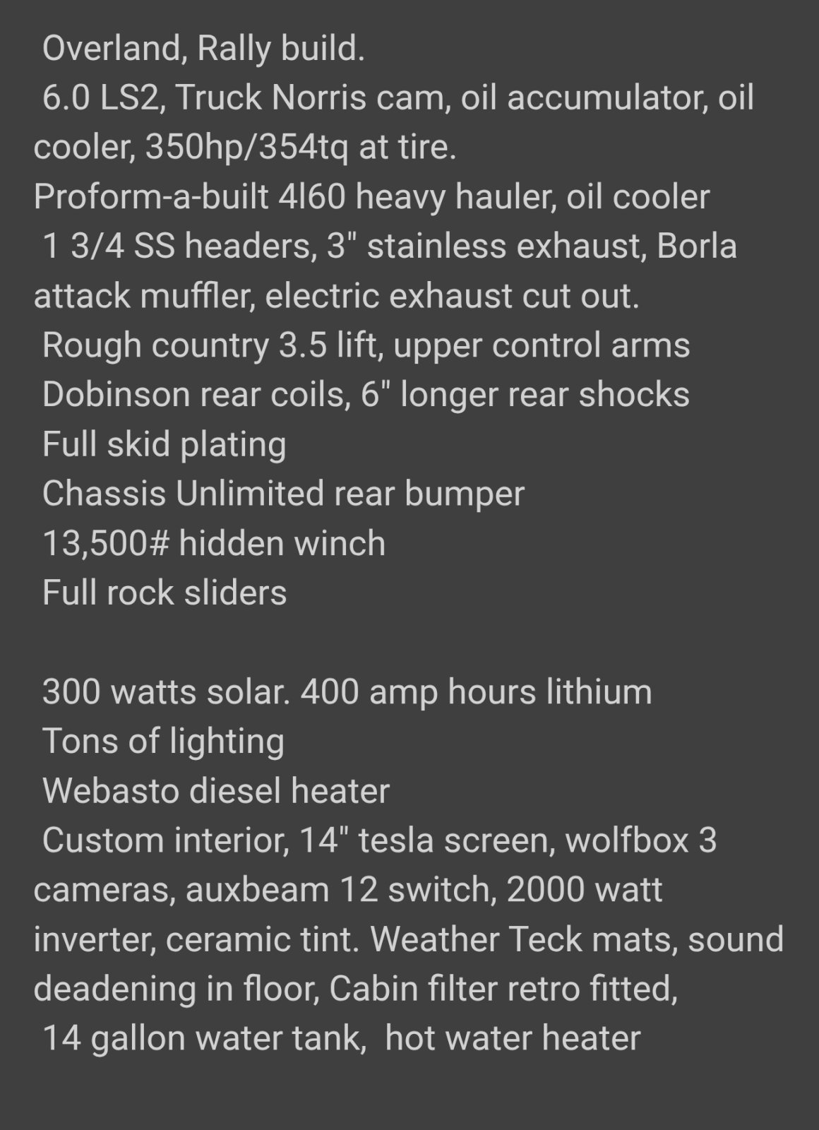

The big stuff that's done so far. A thousand little things that don't make the list.

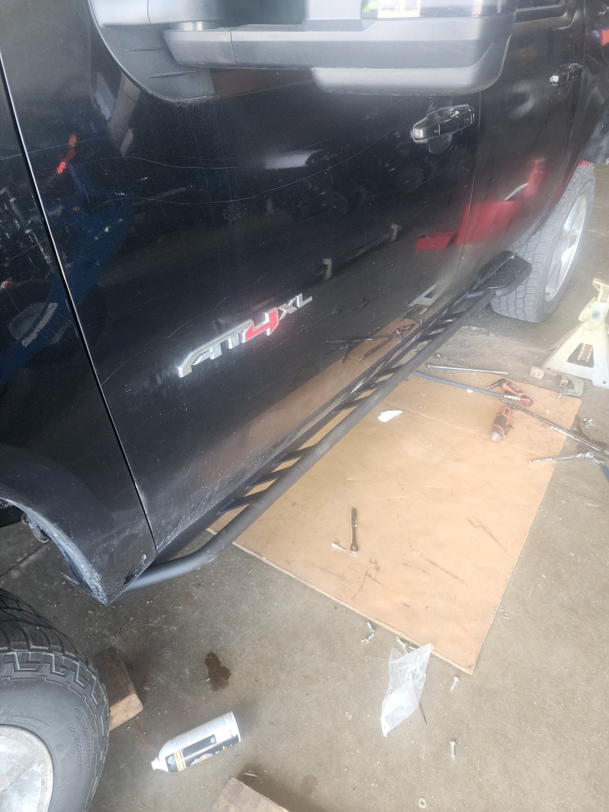

Wow, thanks! I will check that out.
A SAS doesn't meet the luxurious requirement. If I was building just a hard core trail rig I would go that route but I like to travel and won't trade off the sweet highway ride and handling.
A retro AT4 is vibe I'm going for. I've already re-badged it.
Dirty looks
Dirty looks
Dec 5, 2025
140
228
The wild part is how often people think it really is an AT4 and ask me where I got it.
I just tell them it was an early prototype, probably the only one in existence.
