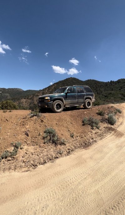

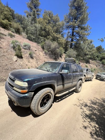

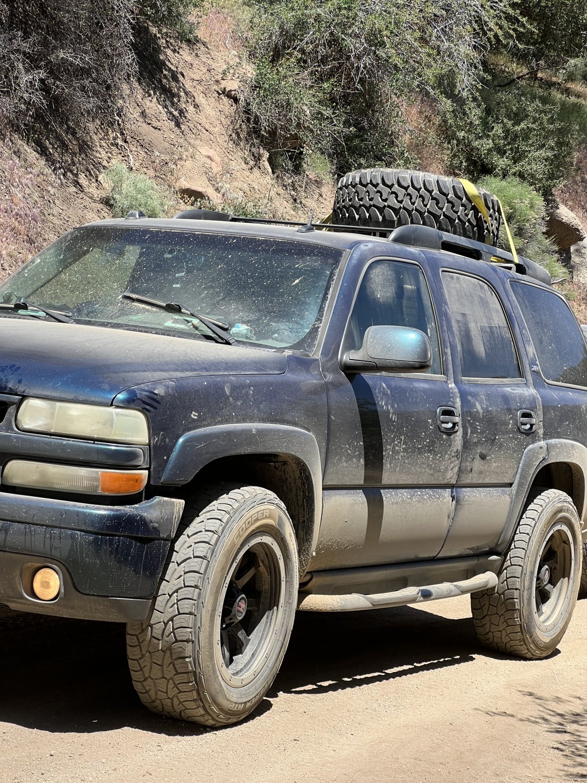

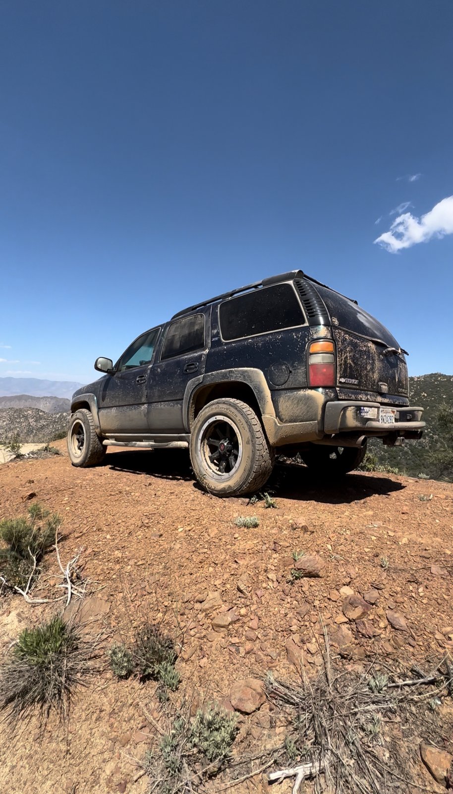

My 2005 Z71 Tahoe 4x4 currently has an open differential due to my stock g80 grenading leading to a junk yard swap.
I want to add a locker but am crossed between the eaton truetrac, Detriot locker and the Yukon Locker.
I need the locker for some occasional moderate off roading/snow wheeling but still want to be able to use the vehicle for daily driving and on highways.
Any suggestions or experience with any of them in particular?
Im also running larger than stock 275/65/20 all terrains
