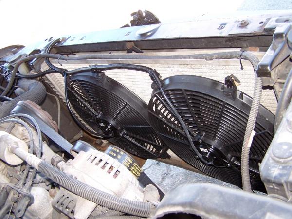

Same size radiator, I'm running dual 16s on mine too:

Mine are not Flex-a-lite fans, they are procomps off of ebay. I got the metal from my local building supply place, they sell pipe and all sorts of cool shit. :D It was $30 for a 3x3 piece or so ... I cut it out with an electric grinder with a cut off wheel ...

... I got the metal from my local building supply place, they sell pipe and all sorts of cool shit. :D It was $30 for a 3x3 piece or so ... I cut it out with an electric grinder with a cut off wheel ...
Damn! That's some nice work! I like it.
That may even inspire me to get off my ass and do something like that to mine!
