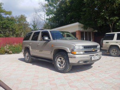

Get my Tahoe LT 4WD 2006 this June.
Solved a lot of problems already (thanks to this forum too!) and still happy to drive this big SUV.
Right now I really need an advise from experienced users.
Once I bought my Tahoe the gas mileage was just perfect- I did 20-21 (11ltr/100km) on highway and around 15 in city.
Car was at stock 17" 265/70 tires and had 120k miles.
Does it sound real, btw?
Then from month to month my mpg began to deteriorate SMOOTHLY.
Now it is around 14 mpg on highway (WTF!).
Month ago I installed 33" MT tires, but that is not the main reason 'cause mpg was ****** already even with stock tires.

It would be easier to diagnose your problem if you had not already changed your tires. Did you change your wheel size as well? Did you lift the vehicle as well to fit those tires. Regardless, those 33” tires with an aggressive tread pattern aren’t doing you any favors. What size motor do you have? I’m guessing you have 4WD. If you were getting 20/21 before, you must not have had much traffic and didn’t drive over 60 MPH. One other thing to consider is after you changed your tire size ( wheels?) Your odometer is probably off. Did your have your vehicle realigned after the tire swap?

As I mentioned before - bad mileage was already there even with stock tires.
Regarding to the lift - just changed rear from LT Autoride suspension to Z71 (shocks and coils), and aftermarket torsion keys on the front just to keep the front height at the factory defaults (old keys were almost fully engaged, especially at the driver side).
LM7 - is a 5.3l, and yes it 4WD. Drivetrain is 3.42 btw
Wheels were realigned properly not a long time ago after changing tires.
About my driving style - yes, I could say - granny would be proud :))
