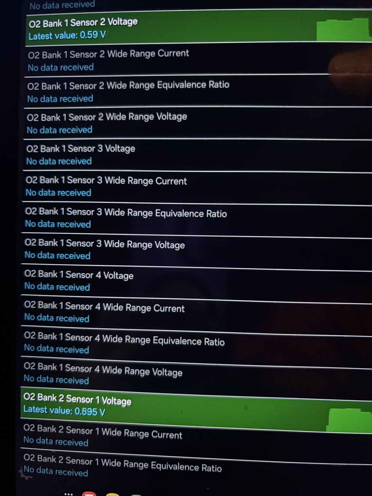

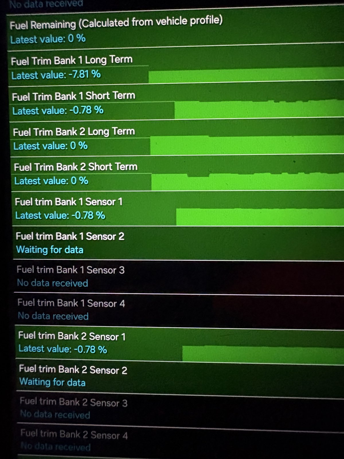

This is what I got
Walkercraig01
Walkercraig01
Jul 3, 2015
517
105
This was after about a 10 min drive at which I got p1516 reduced power twice . I cleared it and it ran back to normal and could drive normal speeds . That's at idle aswell

When the code is present a capable scanner can look at the freeze frame data, if it's there. Capturing that might help you see what's causing it to set. One thing some owners have had to repair is the throttle body harness within a foot of the connection to the TB. The wires underneath the insulation get compromised and typically a new pigtail is installed. @89Suburban did this, I think. YMMV
Check the diagnostic path here, but verify your vehicle info first, then navigate to the correct page:
Expand the Testing and Inspection link, then the P Code Charts link, then scroll down to P1516 and see the documents underneath that link.
