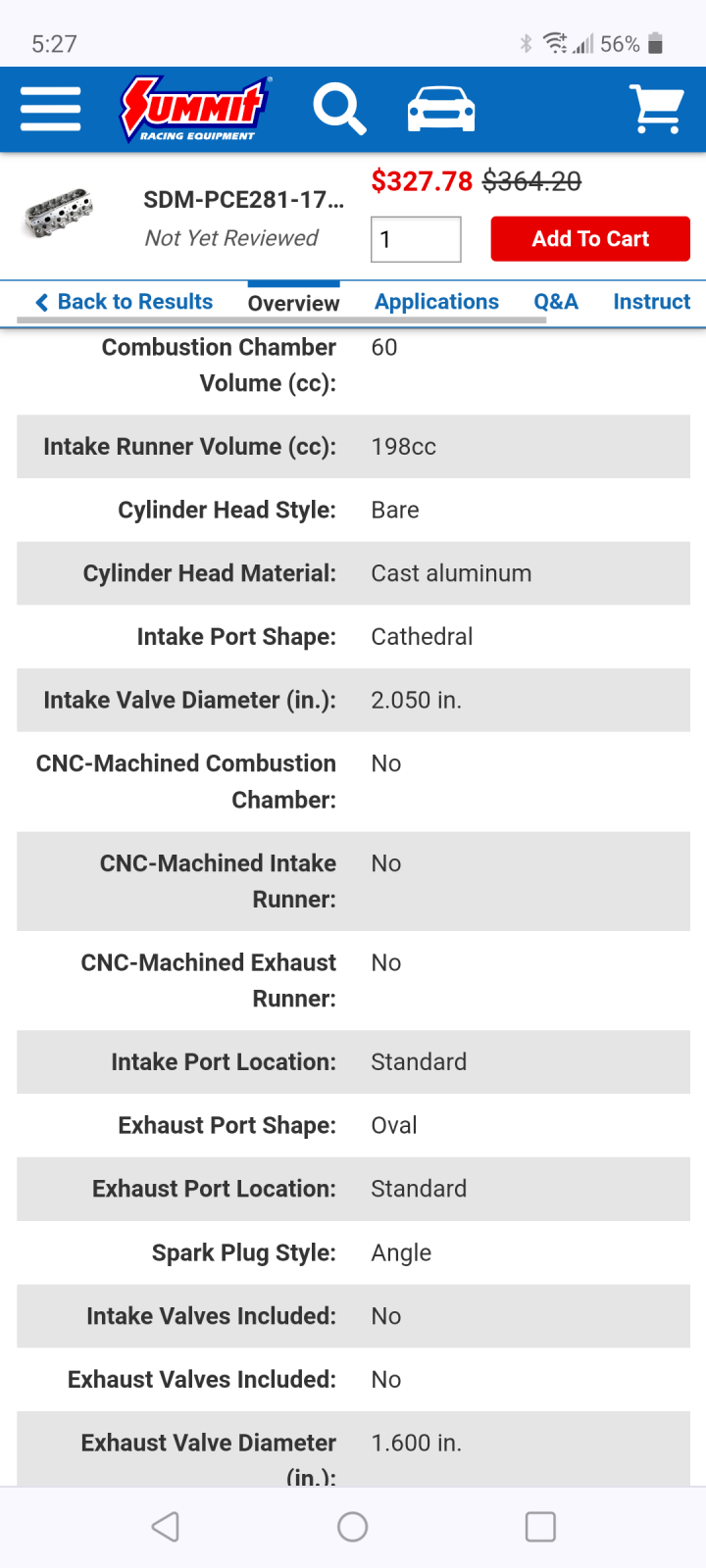

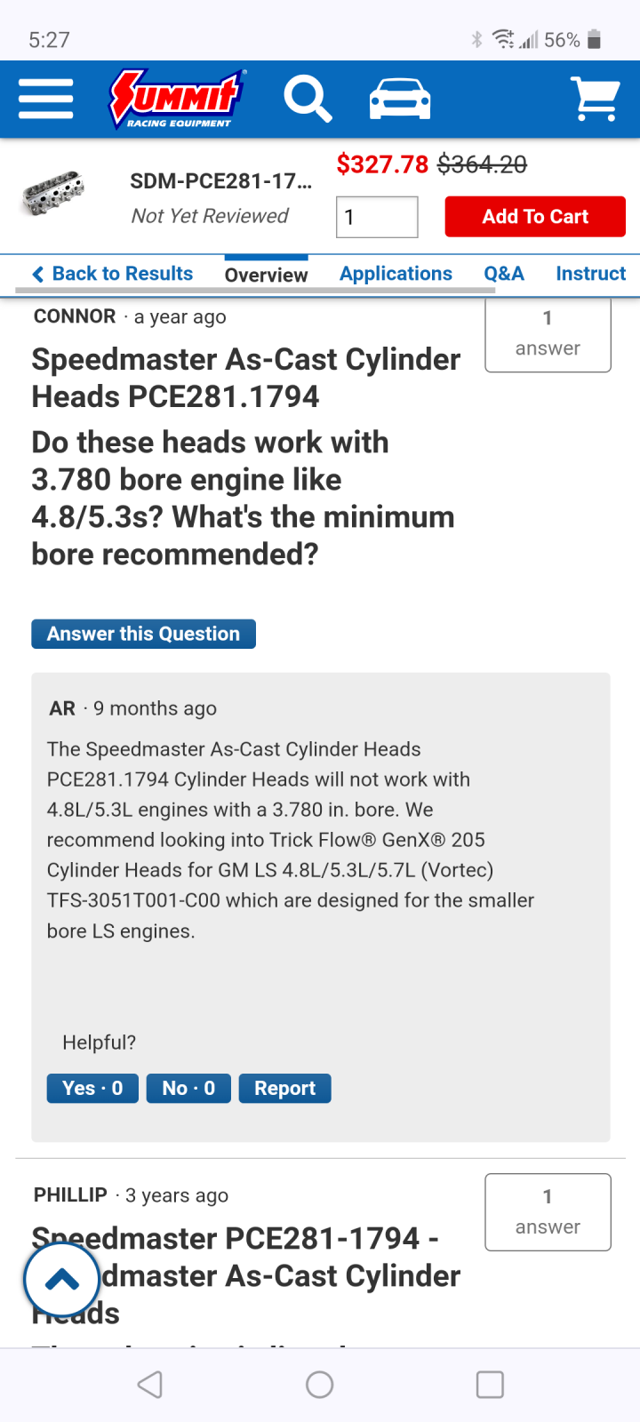

Im looking at making my cammed lm7 breathe better, but my brain hurts trying to understand cylinder head politics.. Can some one please explain, why i can run 5.7 243 heads on an lm7 hassle free..or machine my 862s to fit a 2 inch intake valve.. Yet, according to summit..these heads pictured wont work. I want these aftermarket heads, because they are cheap, have 202 intake valves, and have smaller cc combustion chambers.. I feel running 64cc chambers with 2 inch valves will hurt compression.

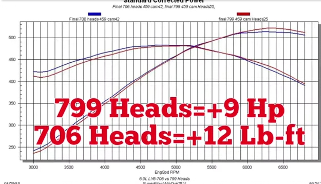

Remembered your other thread. BTR 3 cam. Just use the heads that are on the engine. Every other heads is going to trade a decent amount of torque for a minimal gain in hp where you will rarely use it. And in the end your rig will be slower because it weighs so much that the few extra ponies that you get are offset by the minimum 15 lbft you lost.
Even the 799/243 heads on the aluminum 5.3 in the Silverado lose 12lb ft of torque over the 706/862 casting in a back to back test.
Here is a dyno graph from Richard holdener. Engine is a 6.0 with the comp 54-459-11. That cam is BIGGER than the BTR stage 4 TURBO cam, and in cam terms vastly larger than your BTR 3 truck cam.
The 799 casting is the same as the 243 without the lighter valves for the Corvette.
If I get time later I may see if I can find a graph from the truck cam line. But I think this should point you in the correct direction.

243 — '04-up LS6 / LS2 aluminum center bolt 5.7L; also some '05-up trucks: 64.45cc
799 — '05-up 4.8L / 5.3L truck heads; basically, 243 heads (L33): 64.45cc
706 / 852 / 862 — '99-up 4.8L / 5.3L truck heads: 61.15cc
The above is correct, so far as I can tell.
Those are the heads most of us are better off using.
If the combustion chambers are OVER 65cc, the compression LOSS effectively costs torque production under 3000RpM, which costs MpGs.
The vast majority of our engines spend the vast majority of their run time UNDER 3000RpM.
Choose heads and cam and roller rockers and valvesprings with that understanding.
