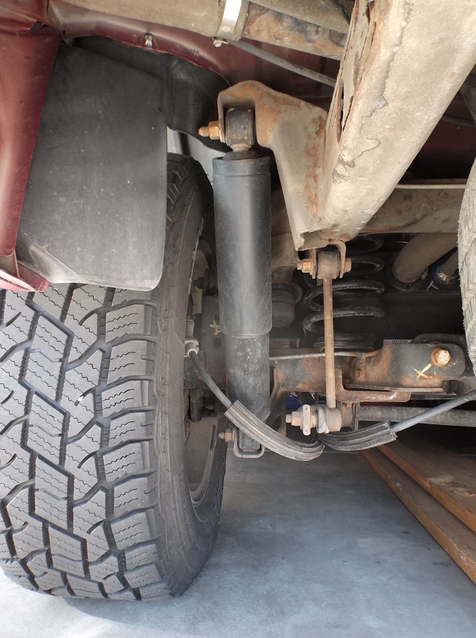

The Nivomats are fairly fat (girthy, LOL) compared to a conventional shock; here's a pic of mine on my '04. Same experience as @mattbta, mine are still doing great and re-level after adding weight and driving a block or two.
The G65 code is for the Nivo shock, and the ZW7 springs are softer than Z71 or standard springs.
I replaced my front shocks to the specified Gas-A-Just model (KG5040) from KYB and haven't really noticed a difference. Stay away from the cheaper KYB Excel-G; they don't have very good reviews. Check the catalog for model numbers if you're interested. https://www.kyb.com/
EDIT: you can test your rear shocks by measuring the bumper height, then adding 200-400 lbs of whatever to the rear. Measure the sag, then drive a few blocks to let the Nivomats adjust. Then re-measure the height at the same place on the bumper to see if they came back up to your liking. They are manual adjusting so they take a little "work" to recover.
