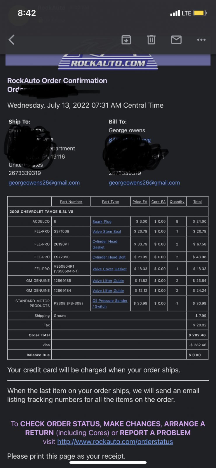

Rockauto just can’t seem to find the lifters

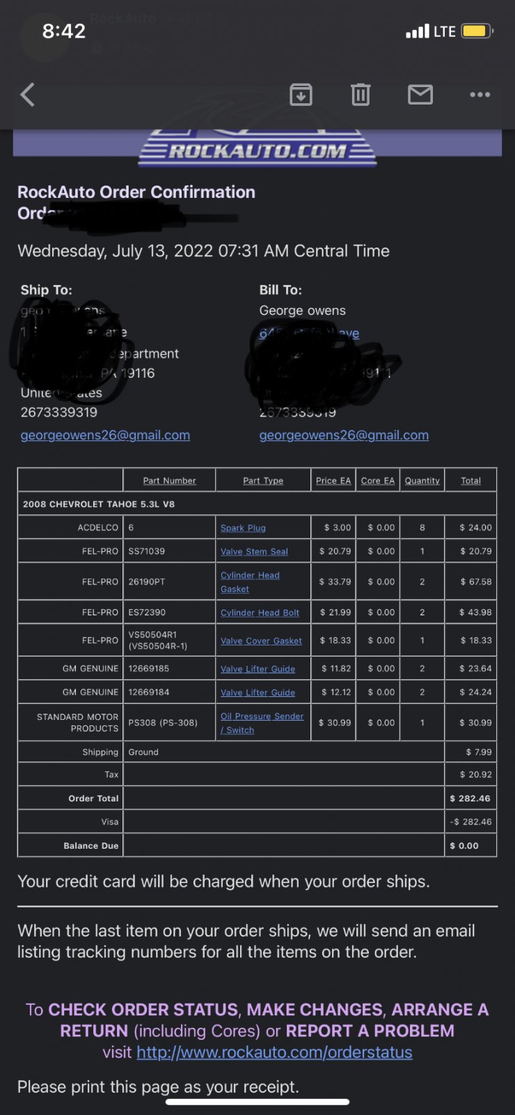

Just put this order in, may have to look elsewhere for the lifters and vlom, valve cover etc
