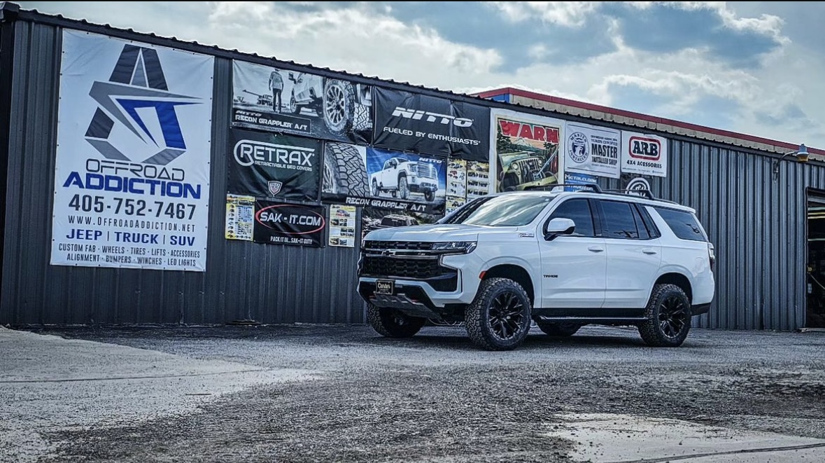

Just leveled my 21 Tahoe Z71, 2 in front, had to add 1 in the back. Mounted new KO3 ATs on Z71 20" Rims. Very happy with the look and more importantly the ride, which changed minimally (for once)...
Do you have any additional photos, showing it from further back. Looks great, how are the KO3's, ride and noise?
