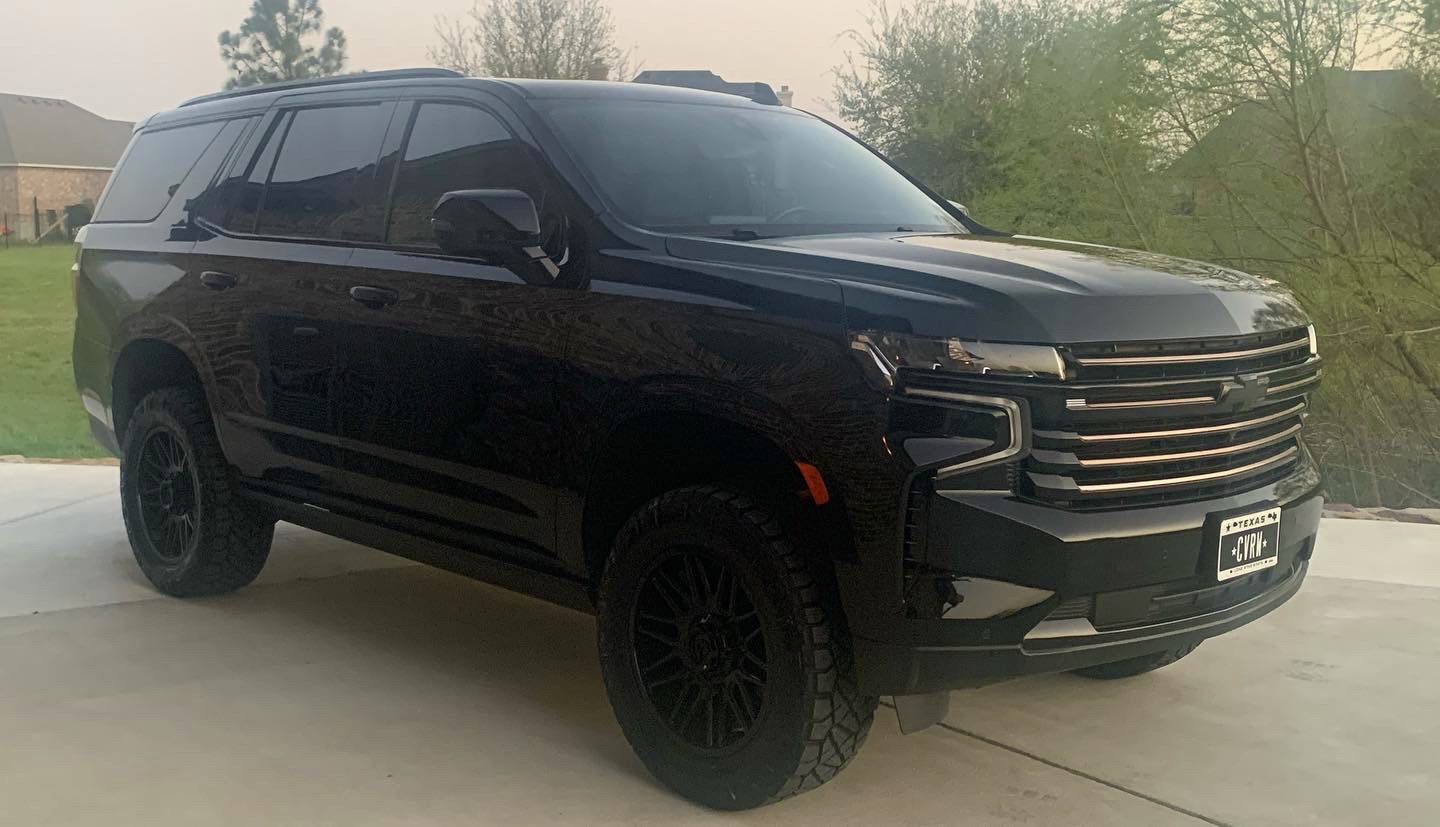

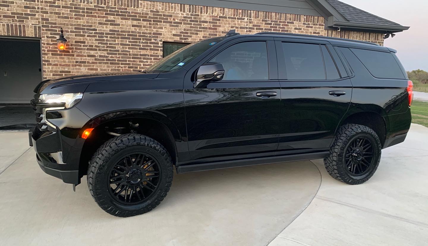

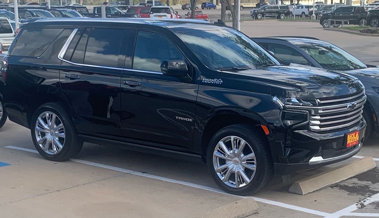

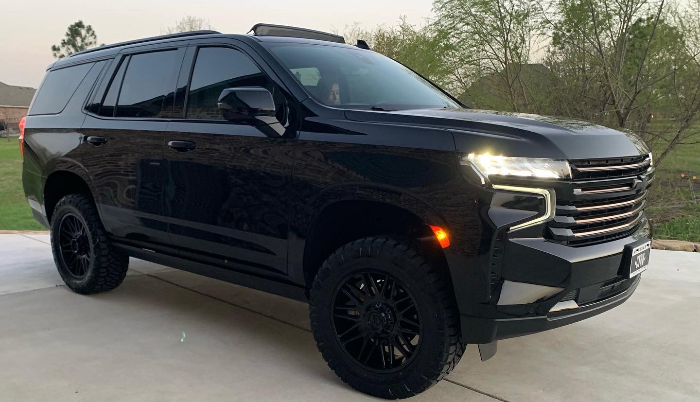

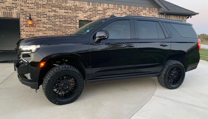

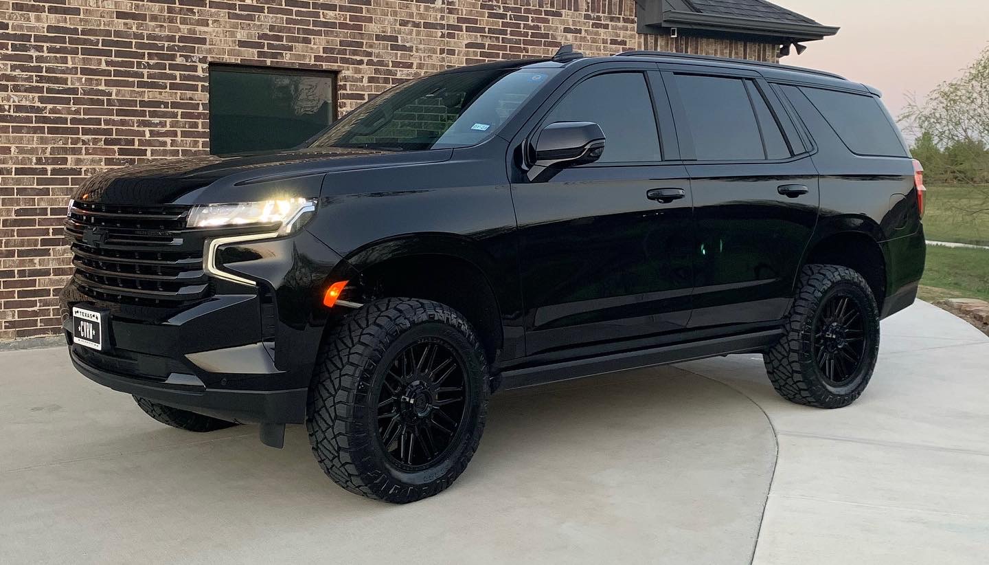

A new 2021 4x4 2021 High Country with 22s for wifes xmas present.. I wanted something a bit different but she wanted another one blacked out, minus the bronze on the front grill and bronze painted calipers. Now on a set of 20x9s, 3.5” lift and 285/60/20s. Full front, side mirrors and rear PPF, and finishing up the sides. Corsa sport with blacks tips sitting in the garage. Need to black out the side marker lights and rear, lower reflective lenses.

Bad ass.

NICE!!!!
What technique(s) did you use for blacking out the chrome?

Wrapped gloss black. That way it's easy to replace if/when chipped or any piece starts to peel. Then, bought some over priced OEM black emblems.

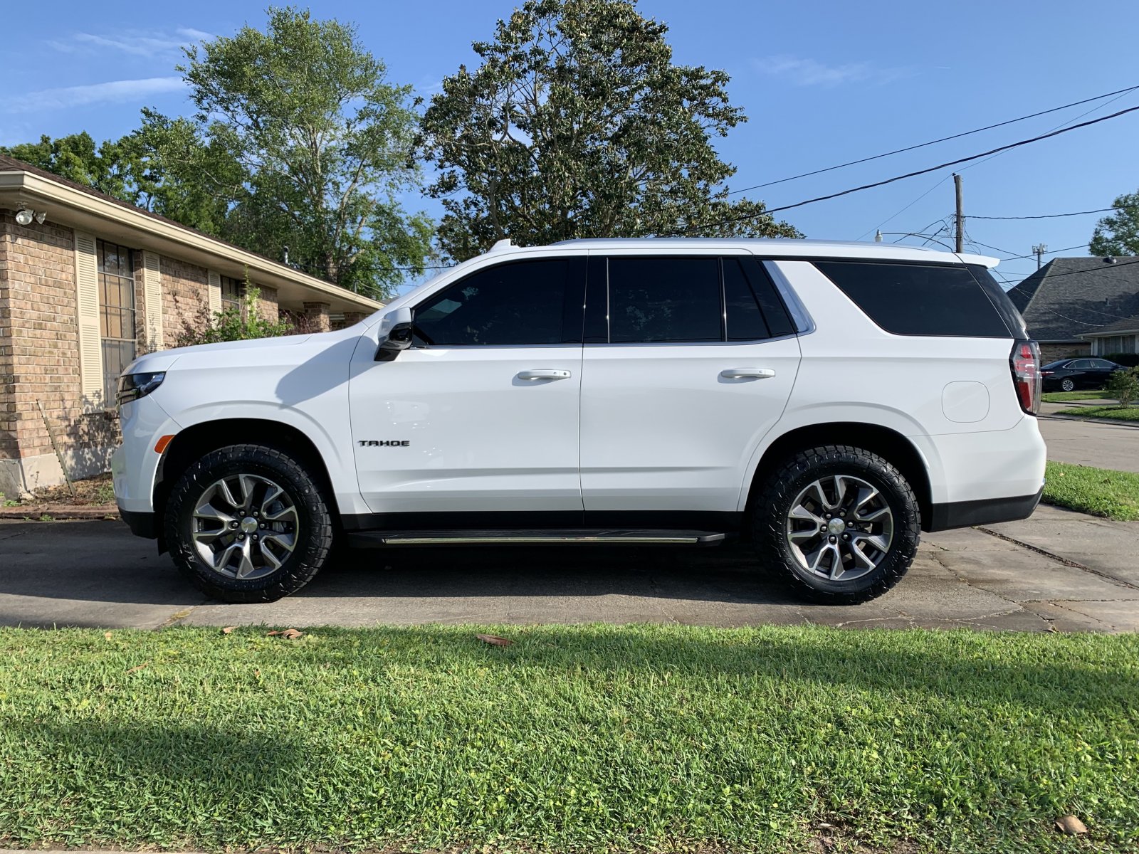

1" Motofab "Level"
285/60R20 Toyo AT3's on the stock wheel
No spacers, no rubbing, no trimming
I wanted to go with the 3" Readylift SST kit and a little bigger tire, but the wife needs to still be able to get into parking garages. We really like how it came out.

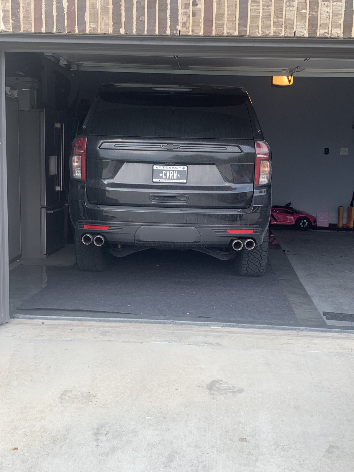

Looks really clean! I was thinking the same thing after measuring about 6 times in our own garage, and then just said screw it… guess she’ll be parking outside lol. I think we’ve got a couple inches to spare. Hopefully it still gets in parking garages.

Which wheel are those?

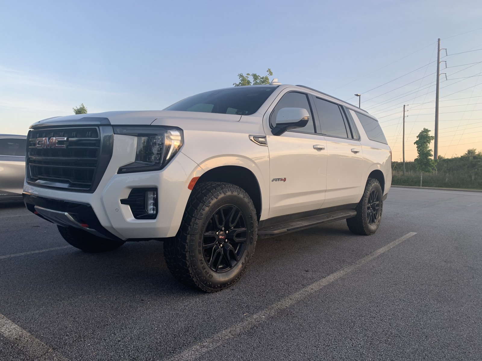

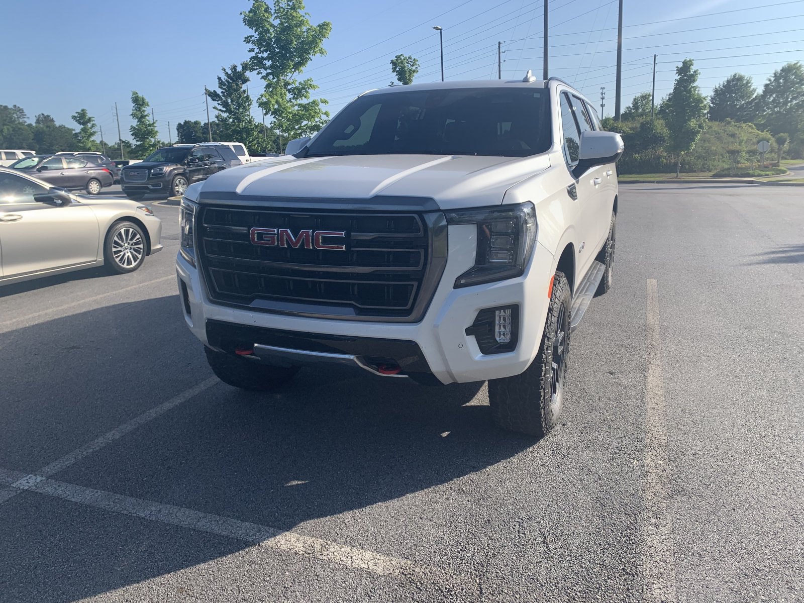

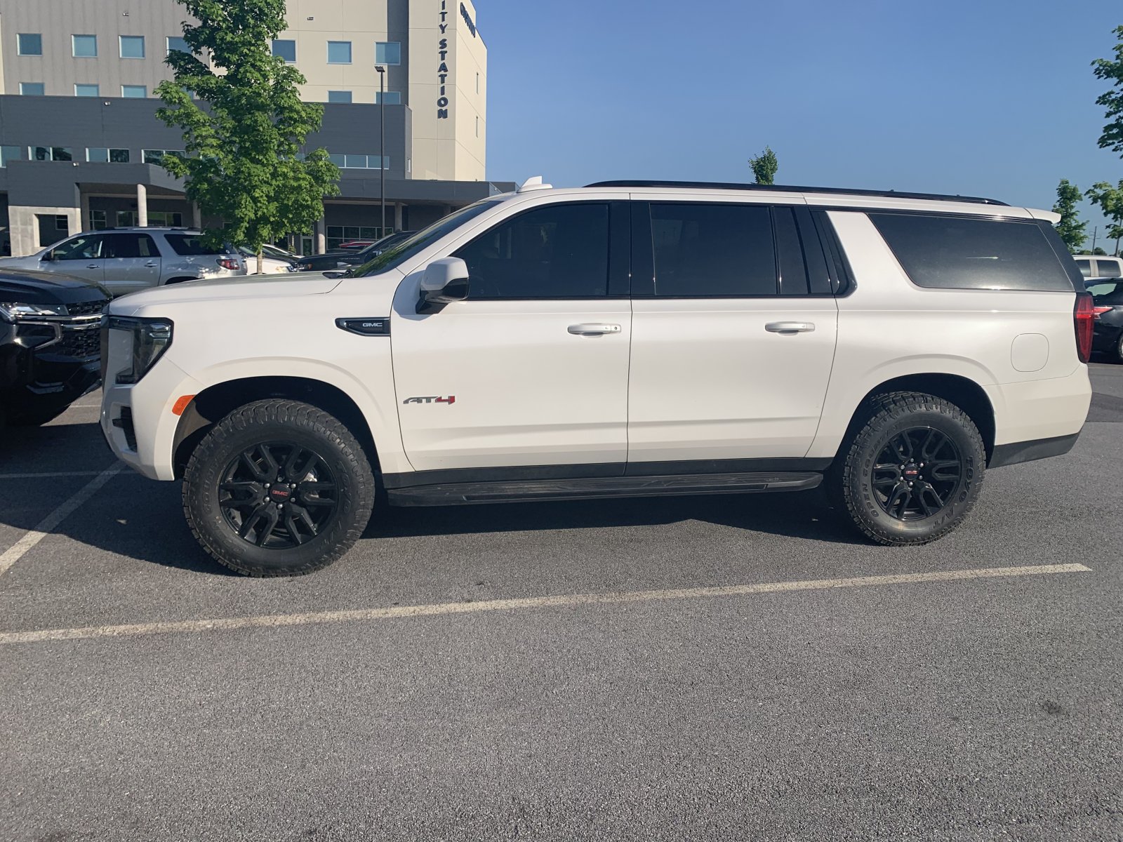

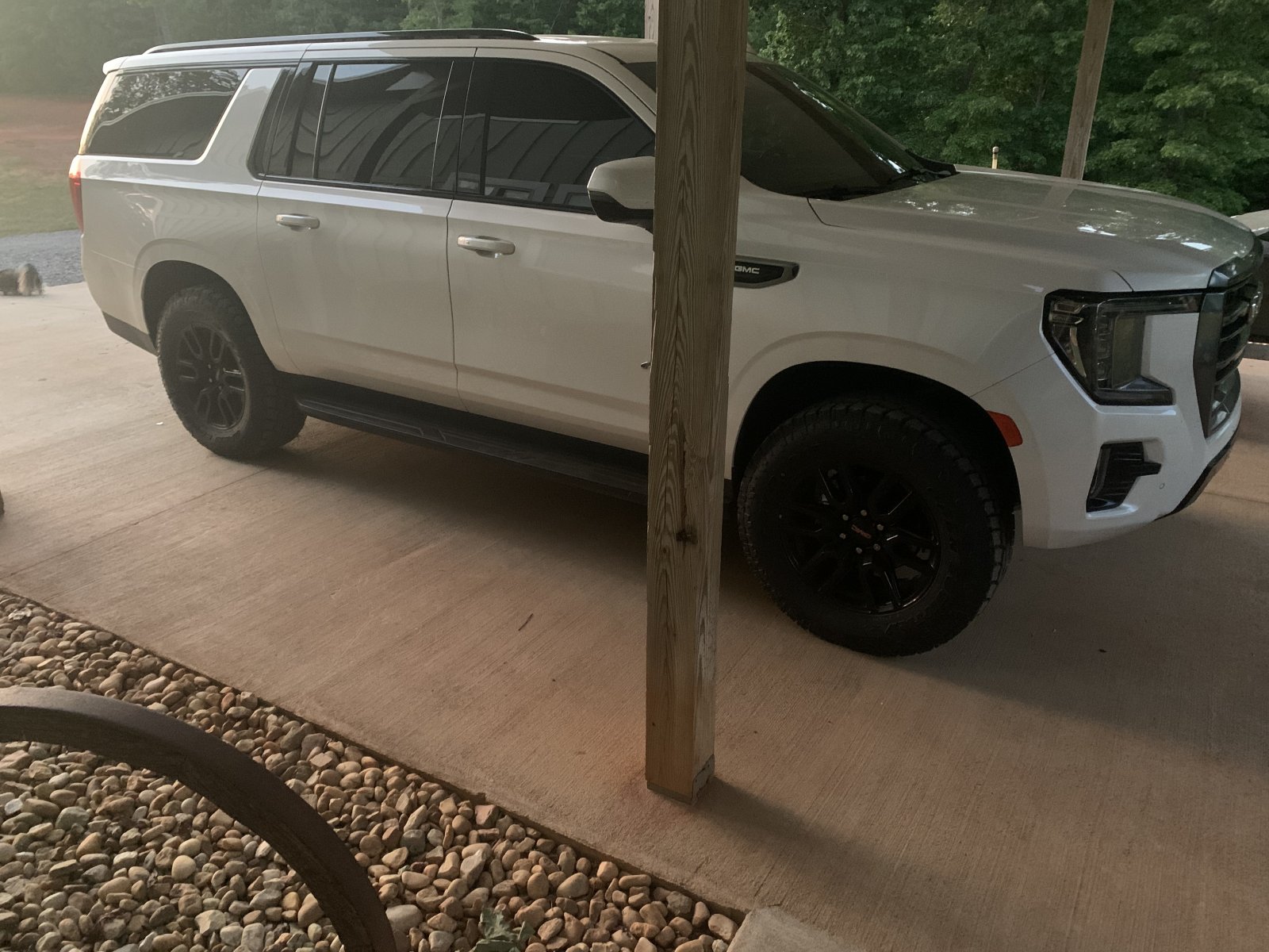

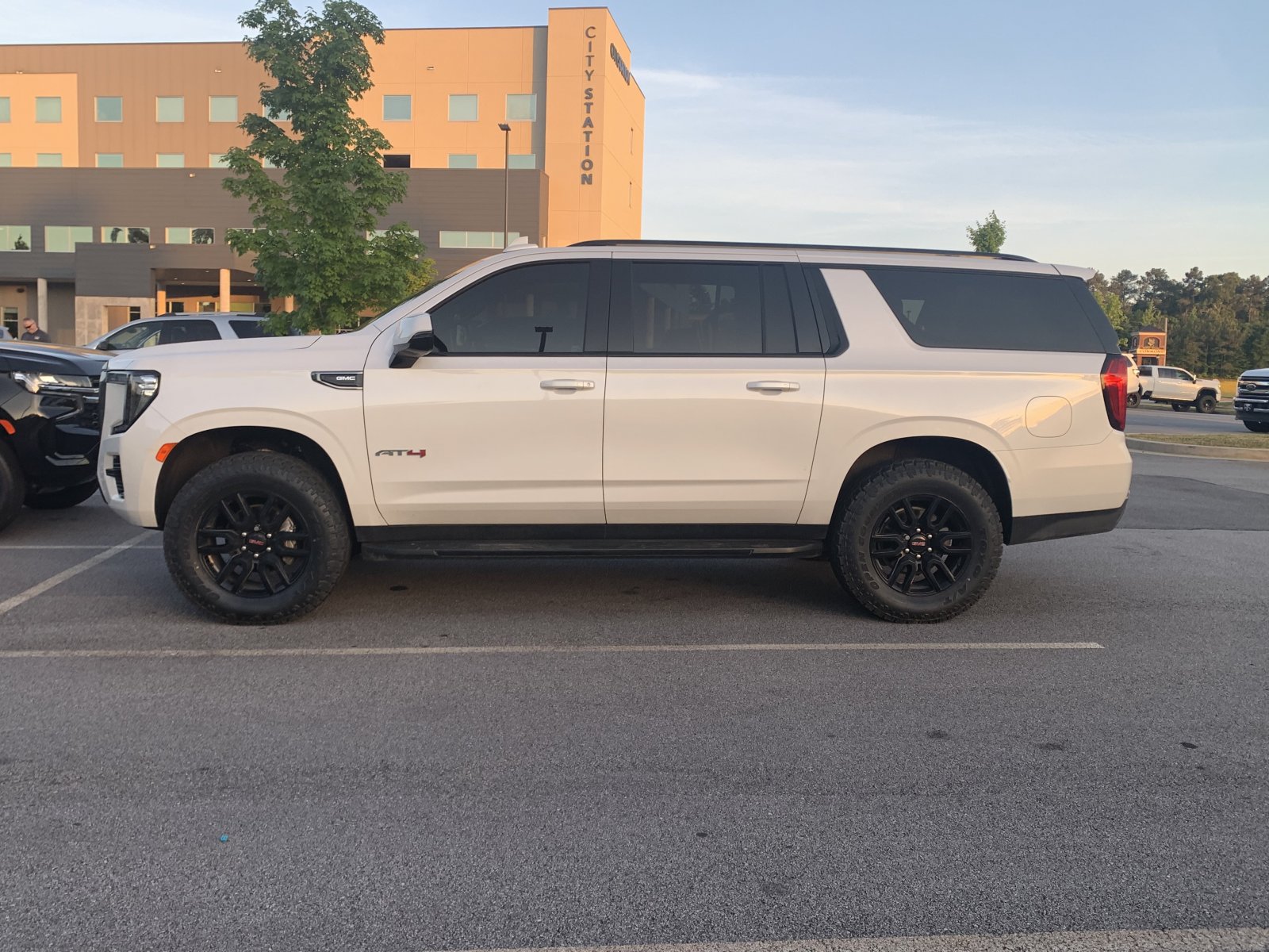

Alright. I’ve stalked this page for years and never actually posted any pics of our previous leveled vehicles. Looking back they were all white with black wheels. Not much changes I guess. Suspension maxx 2.5 front with new uca and 1.5 in the rear. Tires are 295/65/20 Toyo at2. Yes it’s tight, yes it required trimming and some more to be done this weekend. The grocery getter will definitely be set apart now.

Nice. Maybe run a bora spacer?
I’m thinking maybe a one inch spacer would have it setting exactly like we like it. I’m going to measure this afternoon and make sure we can clear one

Looks perfect!
