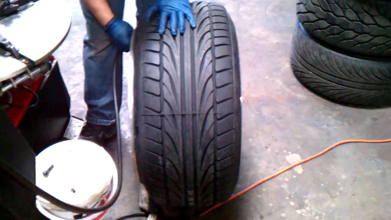

I'd stick to 10" wide if it was me. But if you really want a 12" wide rim it would work, since it's only an inch wider than the tire. You're only really gonna start to see major stretching on like a 14" wide rim with that tire size. The picture is of a 275 wide tire on a 12" wide rim, so not too bad, and if you want a stretched look then I think you'd be alright with it.

Forgot to mention that tire is 275/35 meaning the sidewall is 35% of 275mm, while the tire you picked is 275/60, meaning it's 60% of 275mm tall, which is why it's a 33" tall tire, so it may not look as stretched at the one I posted, but will still stretch a little bit.

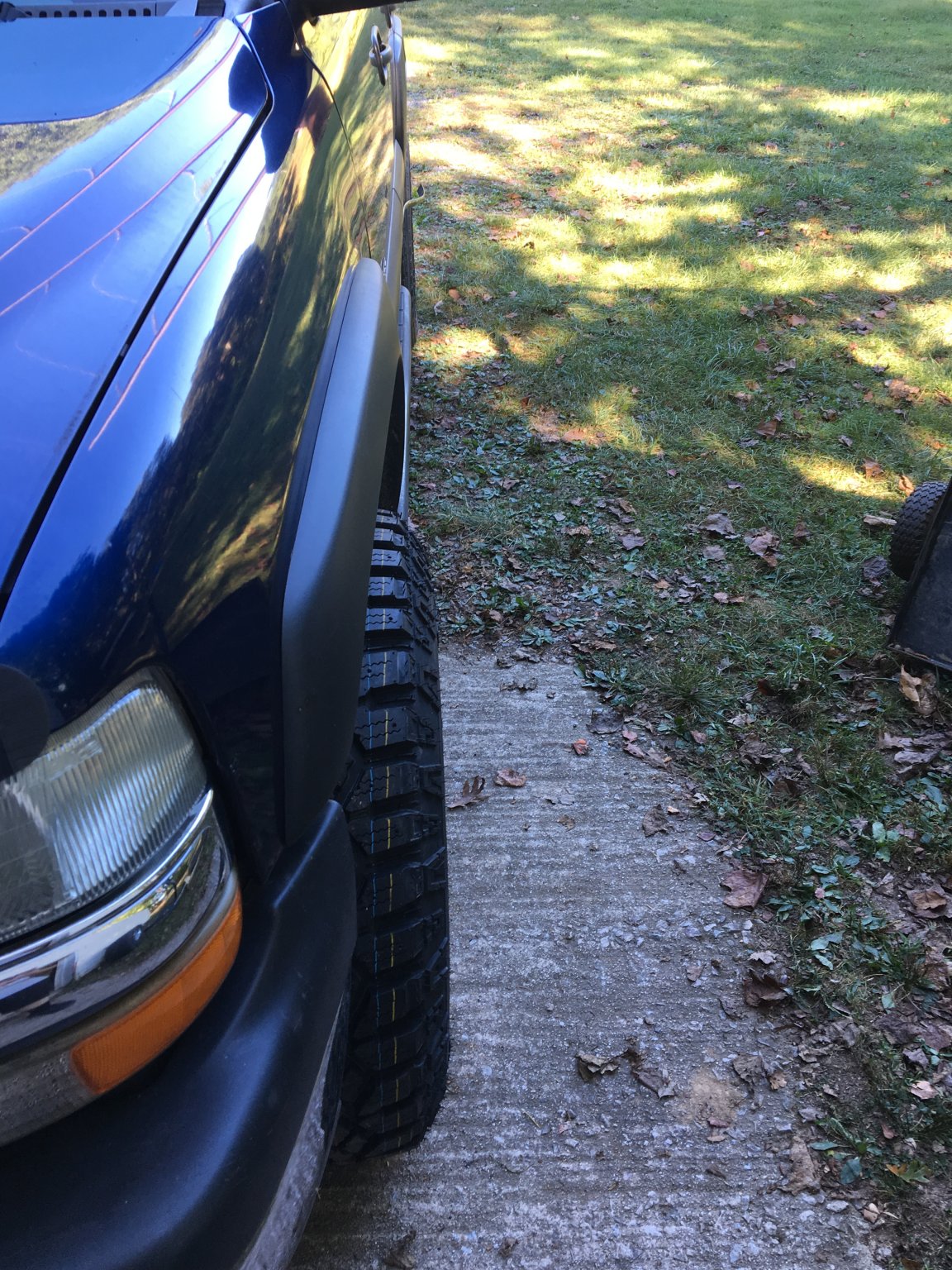

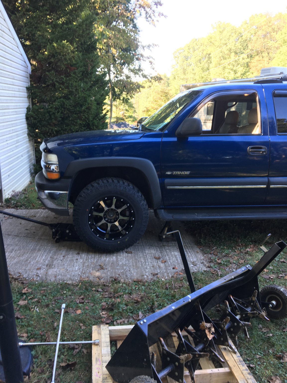

I finally got the new wheels and tires, I went with 275/70r18 on an 18x10 wheel. I haven't put the lift on I just put the wheel on to see what it looks likeView attachment 67032 View attachment 67033
Looks really good man! The tires don't look at stretched at all, and the aggressive sidewall on them just makes the look even better! Proved my thoughts wrong, and got an amazing look out of it. Hope you're happy with the outcome.

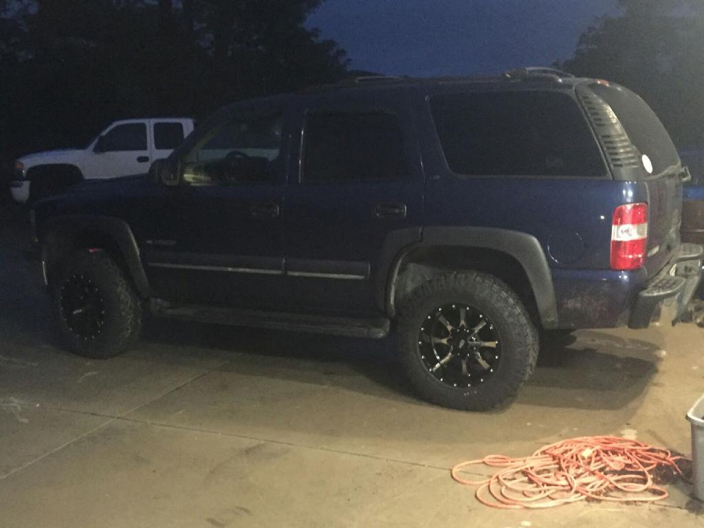

I finally got it lifted, I'll have better pics by tomorrow

I haven't gotten it back yet, I just dropped it off tonight and my mechanic sent me the pic so I can answer most of your questions tomorrow. The tires I got were Kanati trail hogs. With these tires they stick out about an 1 1/2" and that's with the factory fender flares and no spacers. The old wheels and tires I had were 16x8s with 285/75r16 and I didn't crank the stock keys and there was no rubbing so there shouldn't be any rubbing with the new tires. I'll let you know tomorrow about fender heights. 325s would look badass with 12 wide wheels and you would get a good 2 1/2 - 3 inches sticking out which would look awesome. But if you only have keys and spacers you might have to do a good amount of trimming.
