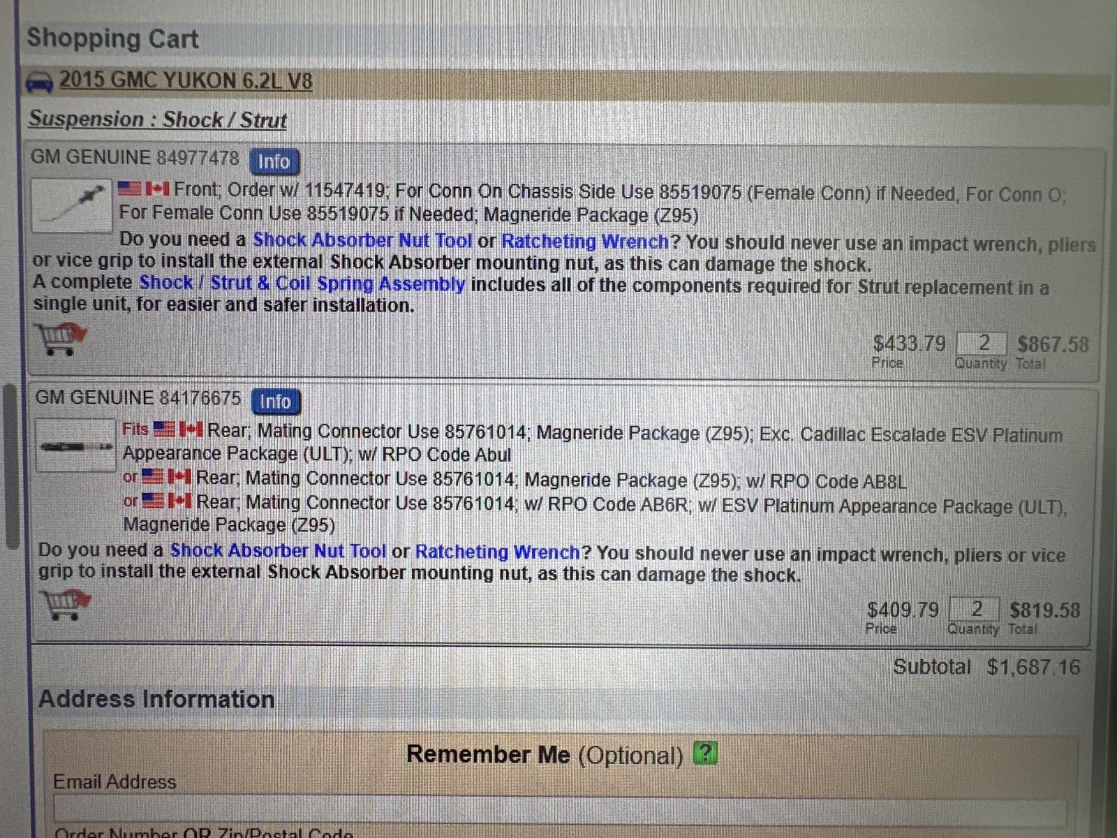

Ok - finally going to replace all 4 corners of my busted magneride suspension.
I have a local shop I trust who will install parts that I buy myself.
Is there anything else I need to get from RA other than these shocks/struts?

I’ve been back and forth on this; a lot. The compression is really just a little beyond my experience/comfort level. They’re charging $600 for all four. I might start with only the struts however because the shocks are in much better shape.

As @Doubeleive states, if you do any wrenching at all, you can easily replace these struts/shocks yourself, except for perhaps, changing out the strut inserts, which require compressing the strut's springs.
I was not comfortable with compressing the two front strut springs myself, so I removed the strut assemblies myself and took them plus the new shock inserts to a local trusted repair shop, and had them change out the strut inserts. It cost me $100 for them to do that task. Afterwards, I reinstalled the front struts into the truck myself. The rear shocks are a piece of cake to change out yourself.

I should revise my previous statement for clarity. For the front, you DO need to get the truck lifted onto jack stands with the floor jack, as the struts (springs) do support the front of the truck. For the rear, the truck is supported by the springs, which are independent from the shocks.
To be honest, I did not think that a YouTube video was needed for this, as I've been wrenching for well over 1/2 century.
For the front struts, you disconnect the brake line hose holder on the lower side of the strut, remove the electrical wire at the top of the strut, remove the 3 nuts holding the top of the strut to the strut tower in the engine bay, remove the 2 nuts and bolts at the bottom of the strut, and the strut assembly literally falls out.
For the rear, disconnect the the electrical wire and the air line at the top of the shock, remove the top nut and bolt at the top of the shock, and remove the nut and bolt at the bottom of the shock.
