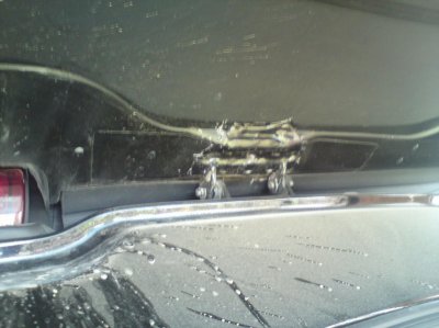

Yeah I had a feeling that might be the case. This gap is hideous and driving me nuts. Can't see much but that's the hinge. The way it's made is kinda asking for trouble. Just glued and it has all the pressure from the gas lifts.

Yeah, that looks like it might let water in, too... :eek:

I had the same issue with the right hinge as well. It's just glued to the glass with this black junk. Sooner or later on hinge will brake out. It started with mine the same way like yours looks now and then the hindge came more and more out.
I took out the tailglas and cleaned up the area around the hinge and reattached it with JB weld. No problems with it since than anymore. This is how it looks right now.
I did the same as you but I cannot get the holes to align to slide the glass back in. Any tips?
