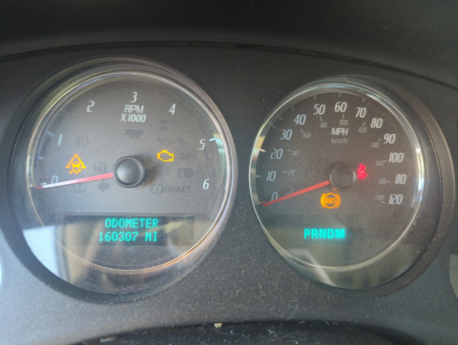

All of the switches on the driver's door quit working while running errands in town. When we got home I looked at the wires in the hinge and noticed the black one had been patched with a solder-less crimp connector and had broken at the edge of that connector.I disconnected the battery, cut the connector out, and soldered the wires together. When I re-connected the battery (it was maybe an hour due to multitasking) the dash errors were still present along with "Door Ajar" as I expected, but also "Park Assist Off."
I thought that was weird so I went to start it and the car wouldn't crank, start, or otherwise respond to my attempts to start. I thought maybe the trunk being open was a culprit but the trunk wouldn't close either.

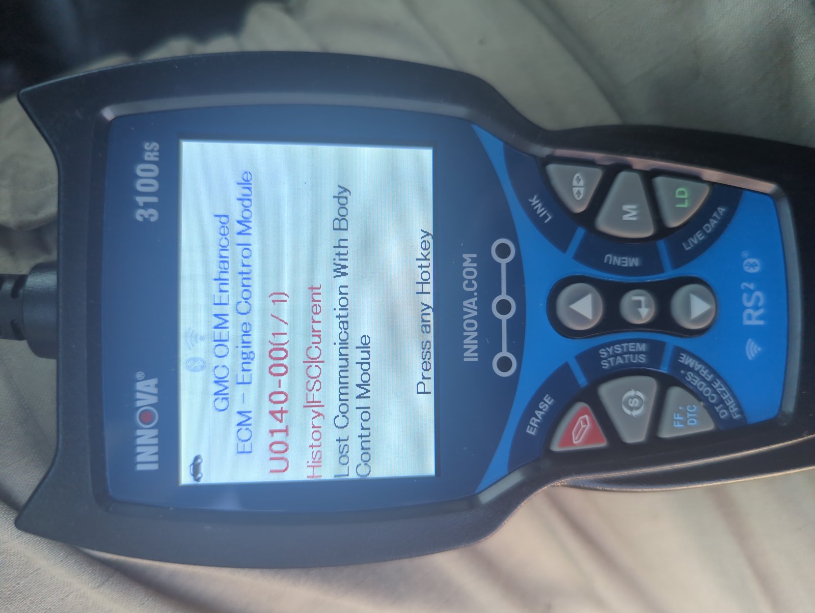

I got my code reader (Not Tech2) and it said "U0140-00 Lost Communication With Body Control Module" which explains why it won't crank or anything.
I've seen lots of people posting similar issues, but only a few that I really felt was my issue. I suspect that somehow in fixing a wire for my driver's door and/or disconnecting and connecting the battery... I fried my BCM? I see a few who agree that this is a thing that can happen, but did it happen to me?
I traced fuses for the modules in question and replaced them all, removed my BCM, cleaned contacts, and re-connected. I unplugged my battery, touched the cables together, and let it sit for an hour. No change.
Attached are pictures of all error messages on my dash as well as my code reader.

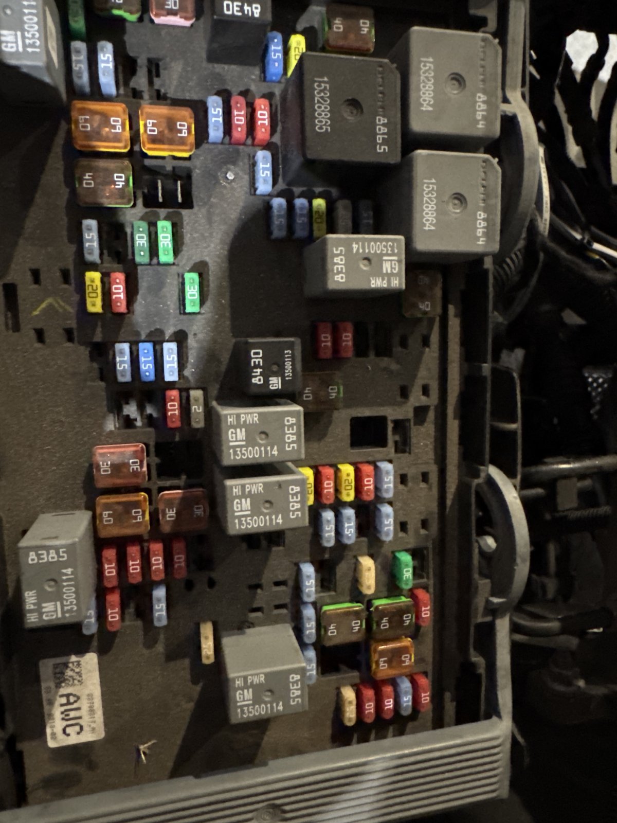

Look for a 2amp mini fuse in the engine compartment fuse box… That fuse is a ignition fuse and it will cause the truck to not crank… Give me a few minutes and I’ll run over to my truck and tell you what the fuse is called and location…
Izusu472
Oct 26, 2016
19
15
Fuse 35 2amp and it’s DLIS

I just replaced that fuse even though it didn't look blown (I have a huge multiplack just for this car). No change though.
Since I was there I ran every other section of my code reader to see if I could get anything different to narrow down this issue. While I was there I noted other oddities.
Every 2nd time I turn the ignition switch on, only the check engine light comes on for the first 5 seconds, then every other light comes on and the car dings.
While the ignition is on I thought I heard a fan blowing, but it was actually the speaker above my head buzzing constantly even with the stereo off.
I also read codes under ABS and SRS:
ABS 1/2: U0140-00 Lost Communication with Body Control Module
ABS 2/2: C0561-71 System Disabled Information Stored - Invalid Data
SRS 1/2: B0081-71 Passenger Presence Module - Invalid Data
SRS 2/2: B0090-71 Rollover Sensor - Invalid Data
The ABS is new with this issue but my traction control light being on has been pretty standard since I got it. Part of my stabilitrak issues. I'll look for that module.
