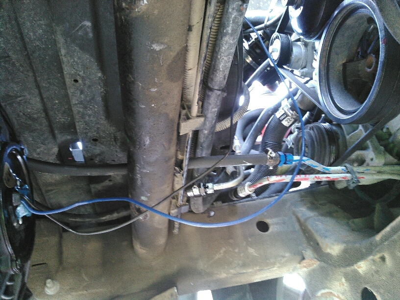

Geotrash
Dave
Feb 16, 2018
7,849
20,430
Richmond, VA
This confirms what I experienced as well. As I was approaching the peak temps during a few hill climbs, I could feel something electrical engage, and the coolant temp would come down 10º-15º on its own, while still running hard in the climb.

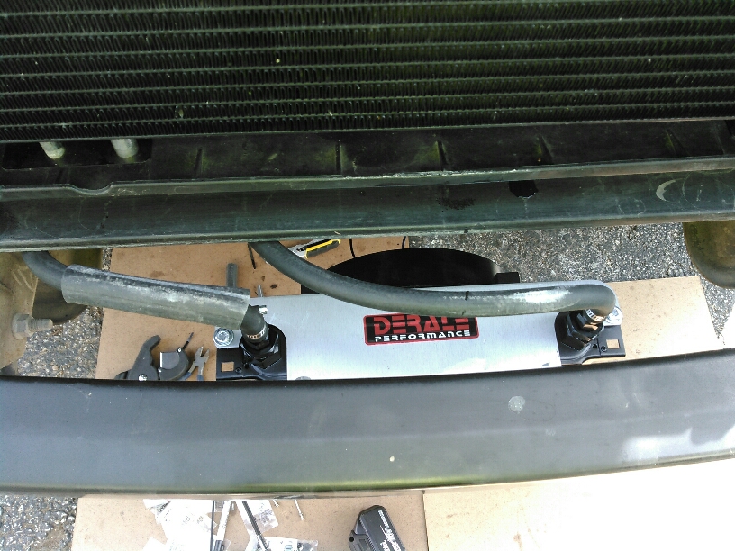

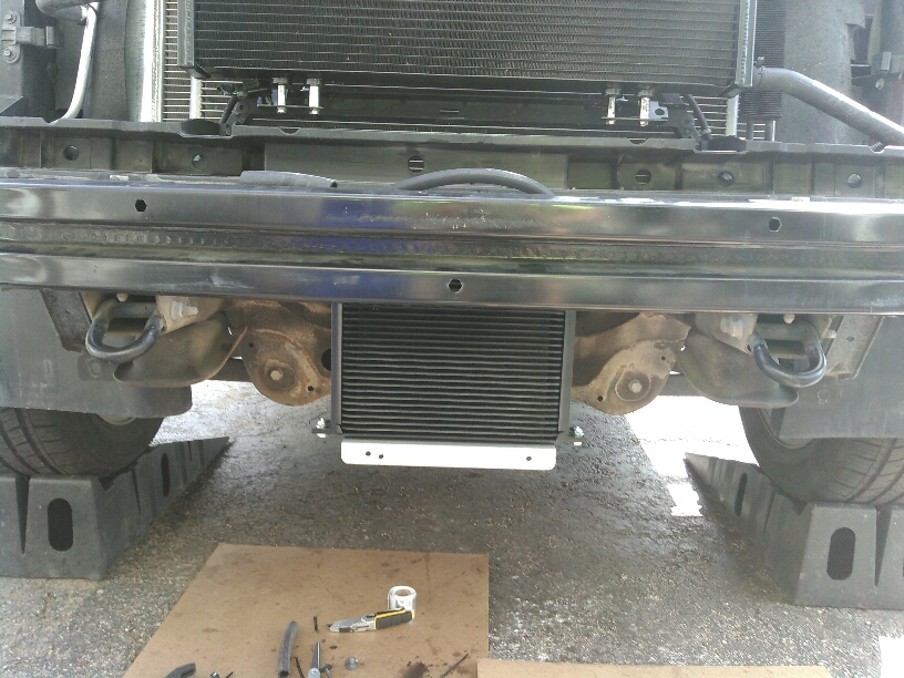

I'll get a couple of pics of the install in next day or two with the derale
installed behind the front bumper
Awesome man. Looking forward to seeing it!

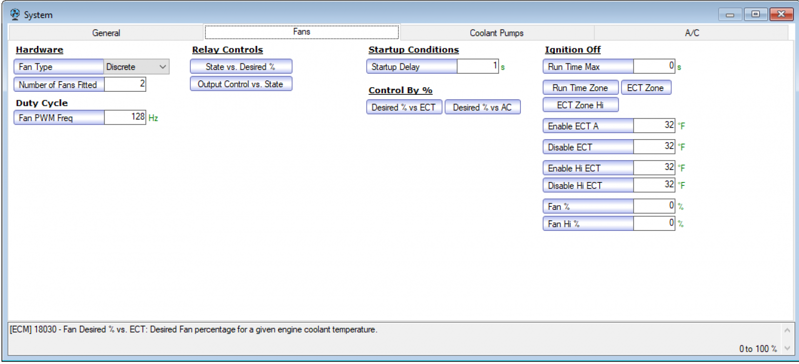

I figured I would chime in here since you guys were getting in a pissing match over the electric fans... @03_GMC is 100% correct and everyone else arguing with him is wrong. On these trucks, at least with the E38 controller, the electric fans are only triggered on or off based on ECT and AC pressure. See the pic attached from HP Tuners. There is literally NO handles to turn the fans on or off based on MPH. Discussion over...
Yes thank you! All this time I wish I would have gotten this picture when the truck got tuned!

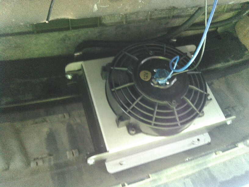

I had not done the wiring yet as of these pics.. I grounded the fan directly to
the round frame bar that holds the splash shield. I replaced one of the top bolts
with a stud and used 2 nuts .. It grounds just fine...
The positive wire is ran into the cab to a switch, then to acces power. So
I can manually turn it on when needed. I didn't use the inline thermostat switch
that came with the derale kit.
I removed the OEM aux trans cooler and spliced into the lines.. Thats why
they are marked .. the blue is the return to the trans - the coldest !
It has not been hot here yet and I haven't towed yet... but I did drive it around
my suburbs and got the trans temp to 165*.. I turned on the fan at it dropped
down about 20* so I know it works.
