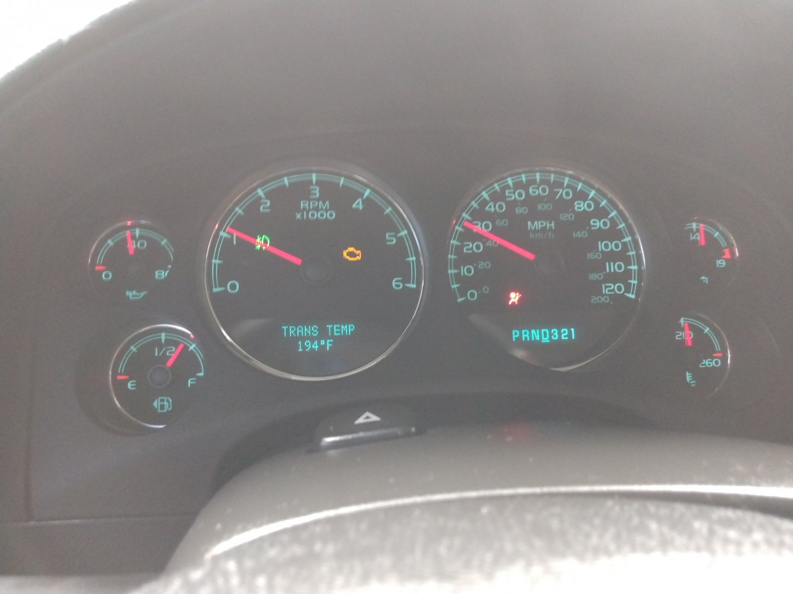

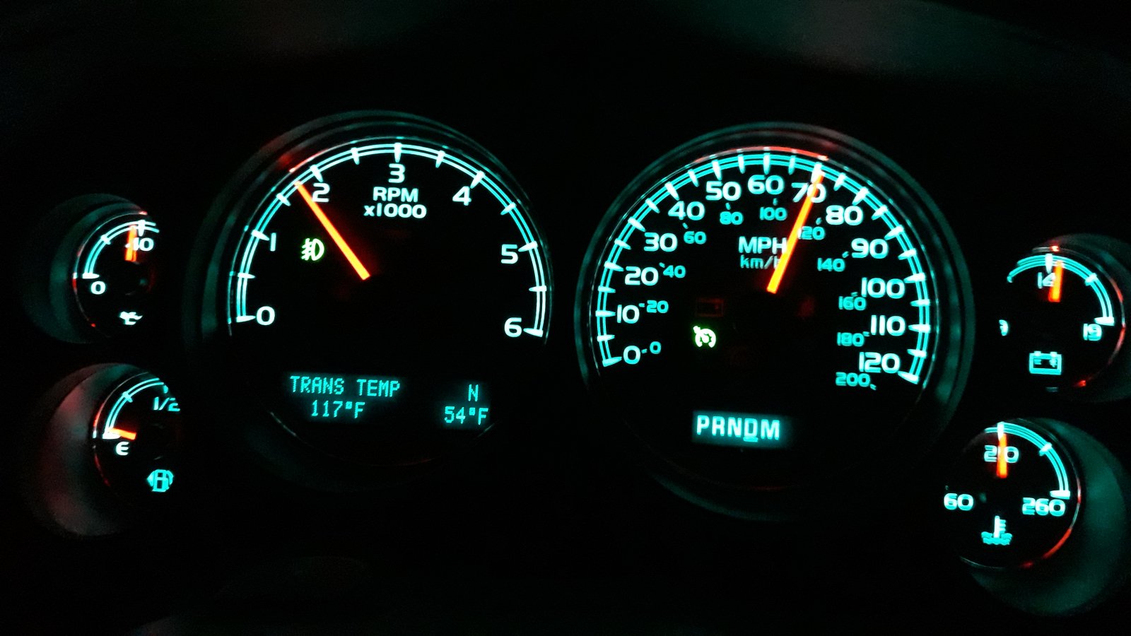

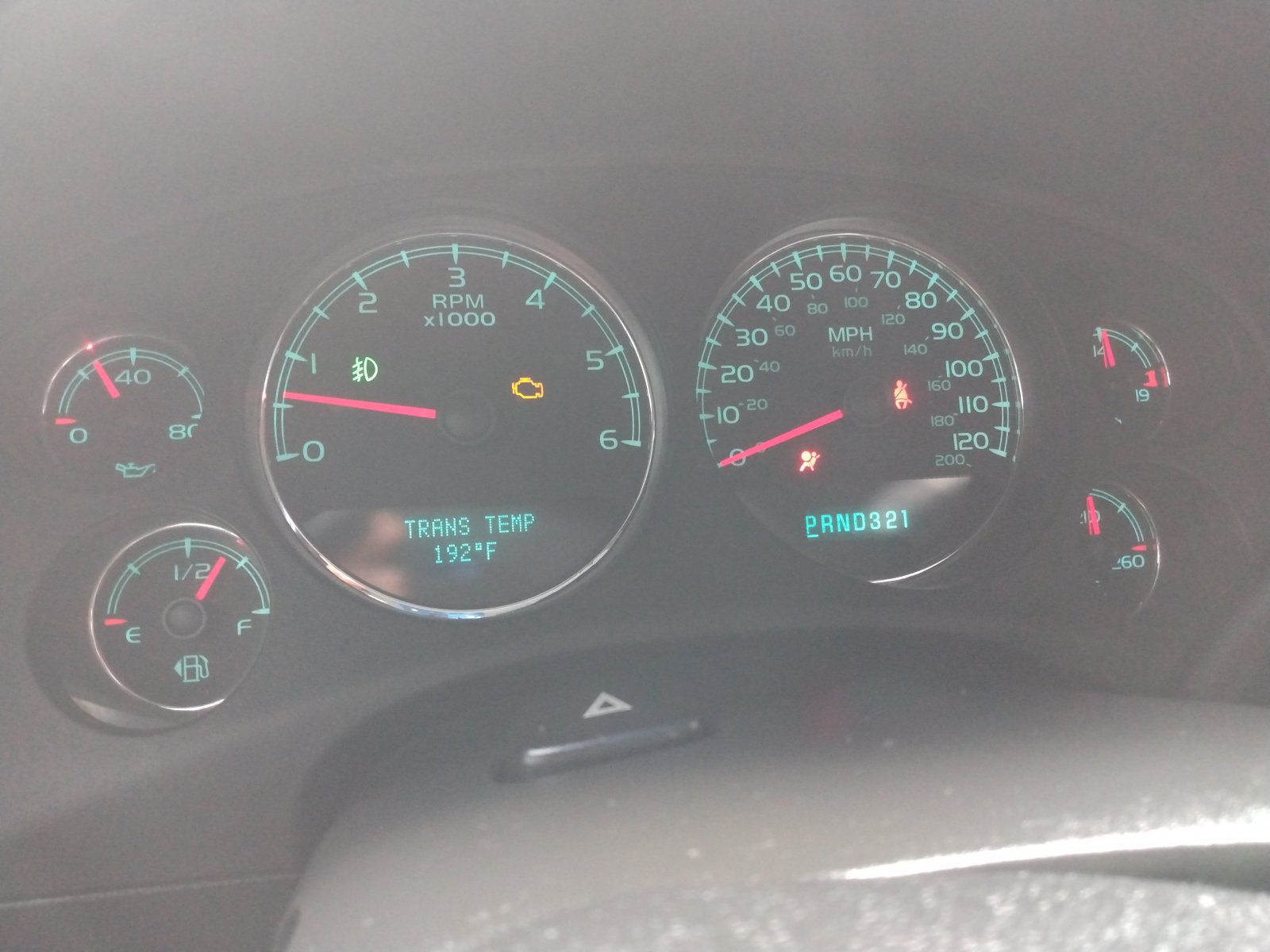

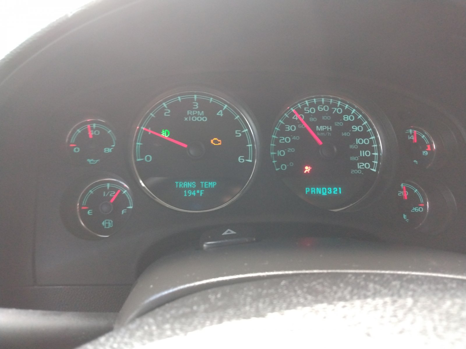

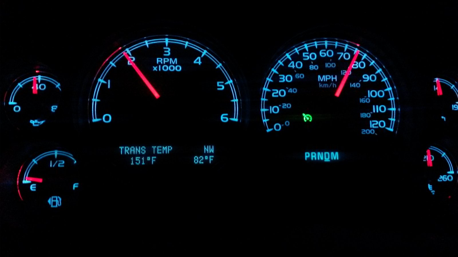

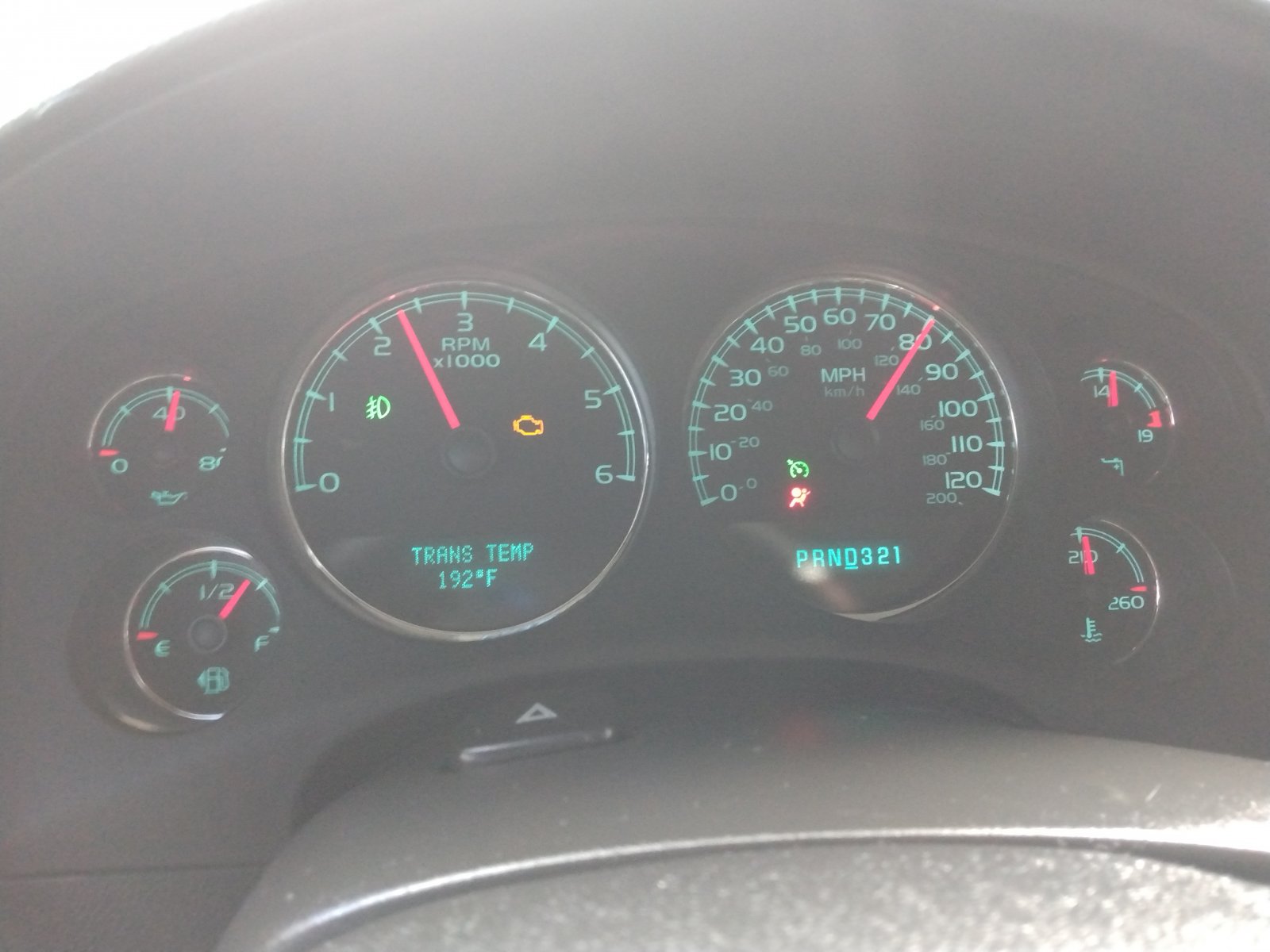

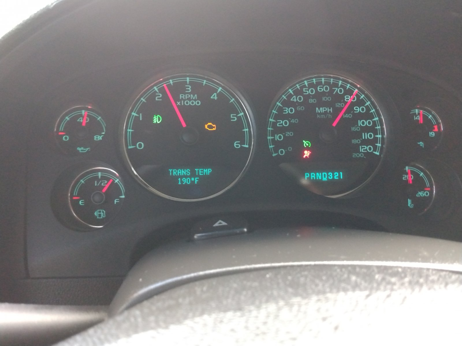

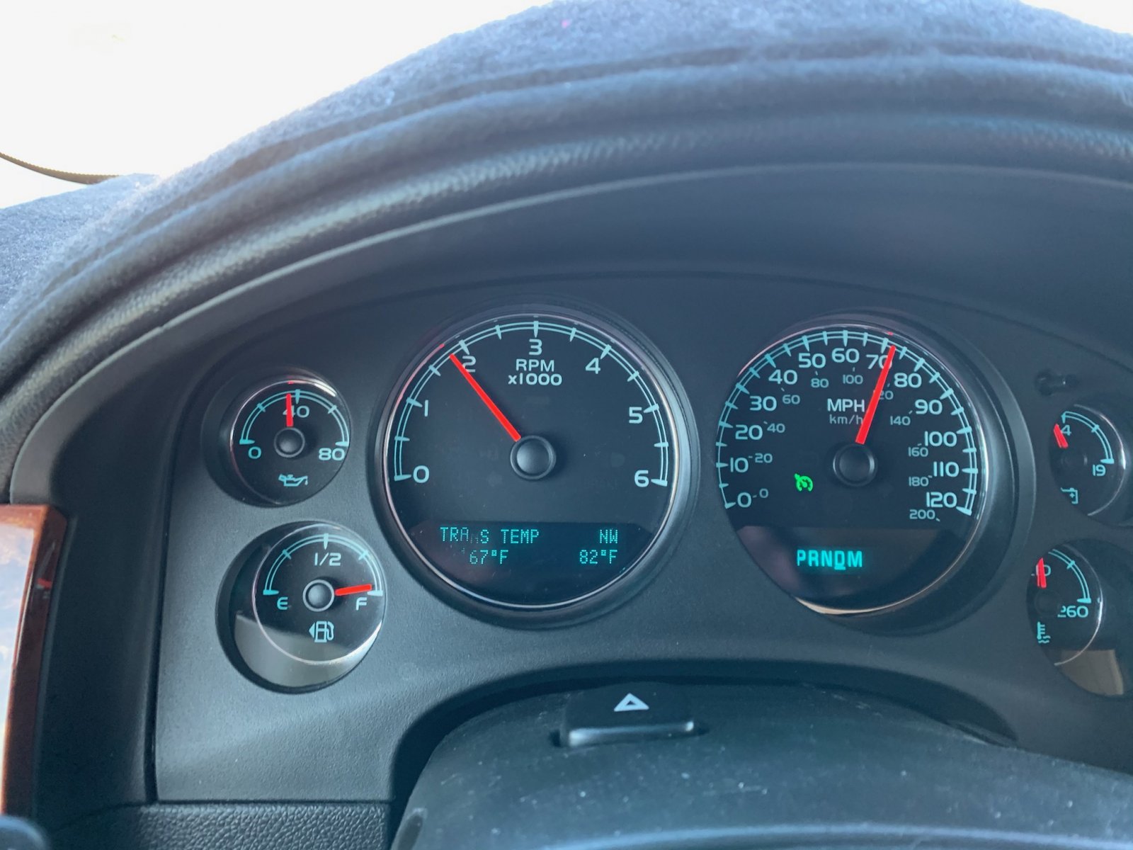

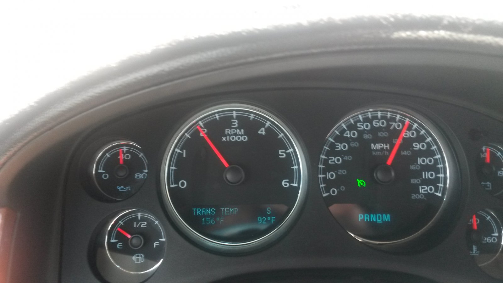

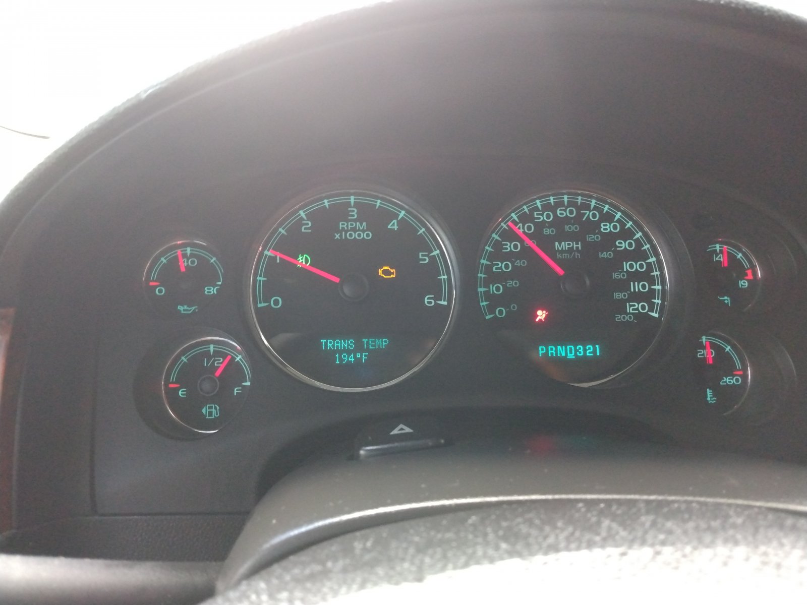

Here are photos from mine from 2018-2020. The last one, she was towing a lightly loaded 12-foot U-Haul trailer. Today, at 218K miles, she runs about 5 degrees hotter in the same temperature and she's at the end of her fluid change interval.
20180612_131420.jpg20180612_214018.jpg20190807 - Transmission and Outdoor Temps.jpg20200229_215736.jpg20201221 - 10.jpg
These photos are taken after being at speed on the highway after about 30 minutes.

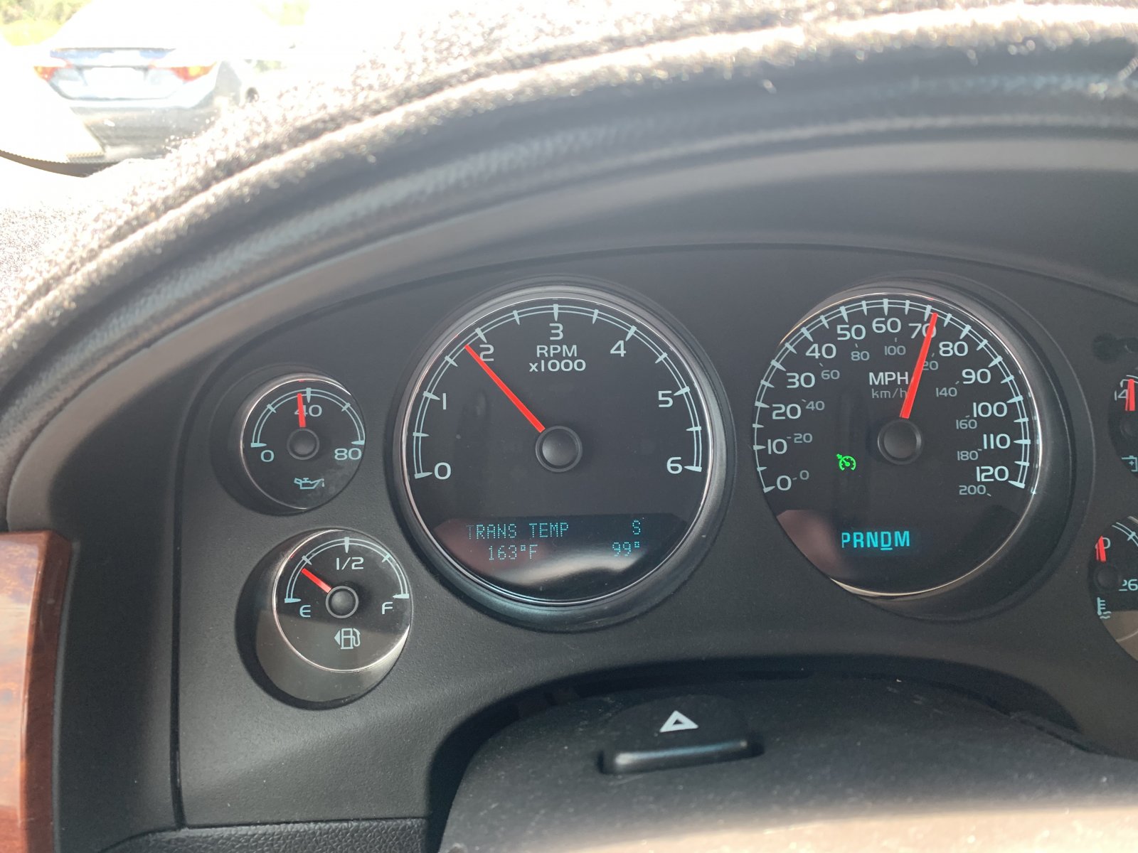

My RPMs used to be below 2k like yours anywhere between 70 and 85mph. Ever since I did a trans drain/fill and filter service 7 months ago, i'm over 2k. My oil pressure made the same jump from just under 40psi to just over. It didn't start doing this right after the service. It started after I made a 300 mile trip the following week. Transmission temp is in the 180s to 190s around town and up to 215 after driving 1hr+ on the highway under 70mph. Picture is after 10 minutes on the highway then getting off. Before the service I never saw it above 175.
I thought something got loose in the fluid change and was causing a restriction so I went back to the shop that did the service. They checked and couldn't find a problem. They said there is TC lockup and no TCM codes so nothing they could do. Truck drives the same albeit a little rougher due to the higher RPMS at those speeds so I keep it at 65mph now, which is just about 2k RPMS.
My CEL is P0430/P0420 for both cats. I'm not sure if that is related since i'm going on over a year with them on. I plan to swap them out next.
