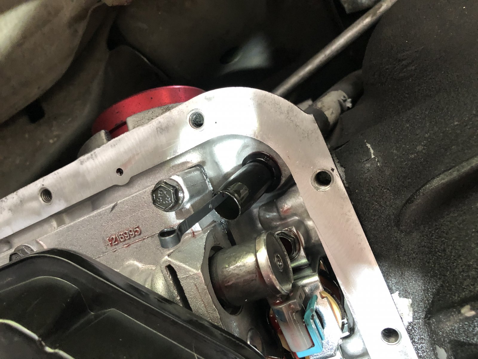

That’s pretty good I can only get about 3 1/2 quarts swapped through my tube. Also saw on a video that @Rocket Man posted that the oil level inside the pan should be at the gasket mating surface and that most factory dipsticks full marks are wrong. So they say anybody who drops a pan check that full mark location and fix it while the pan is off.
Interesting. I take the oil right to the top of the fill line when the temp is 190. I know anywhere is ok within the checkered area but it’s my OCD I guess.
I just changed my filter and checked the dipstick hash marks at the same time. As far as I can tell it looks pretty close, top of the hash mark appears to be at the gasket line although it’s hard to tell because the seal for the dipstick hangs down so I couldn’t get a clear sight line. But I always run a quart or two over the hot line just to be sure. There’s plenty of room to run that much over.

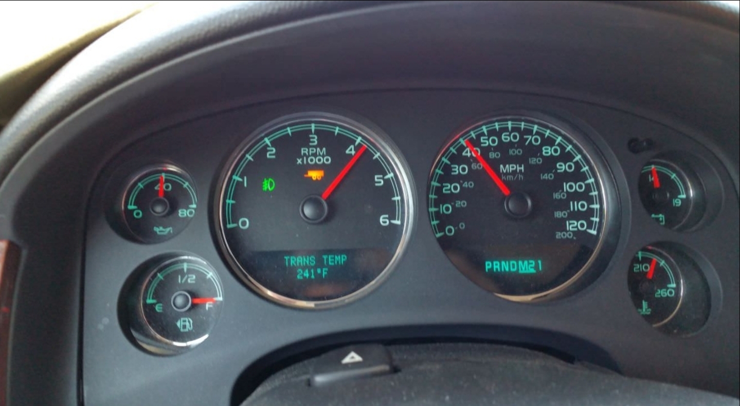

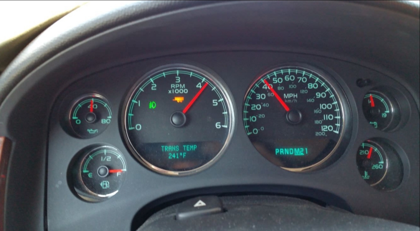

240 is not good. 220-230 is ok. Tru Cool 40k is what I would be looking at.
This was truly THE worst case. Running the Ike Gauntlet, at 16,300 lbs. Silverthorne to the Eisenhower Tunnel, cresting at over 11,000 feet in altitude.
I just like sharing this pic to make heads explode. Original trans, 207k miles, 30k at max GCWR. Stock coolers.
