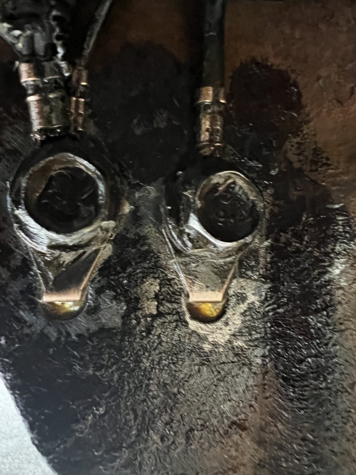

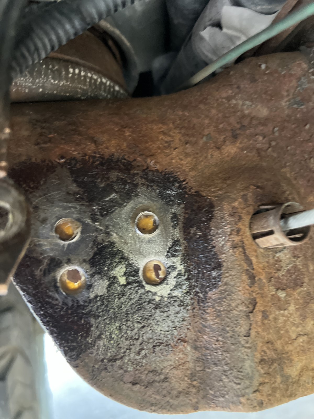

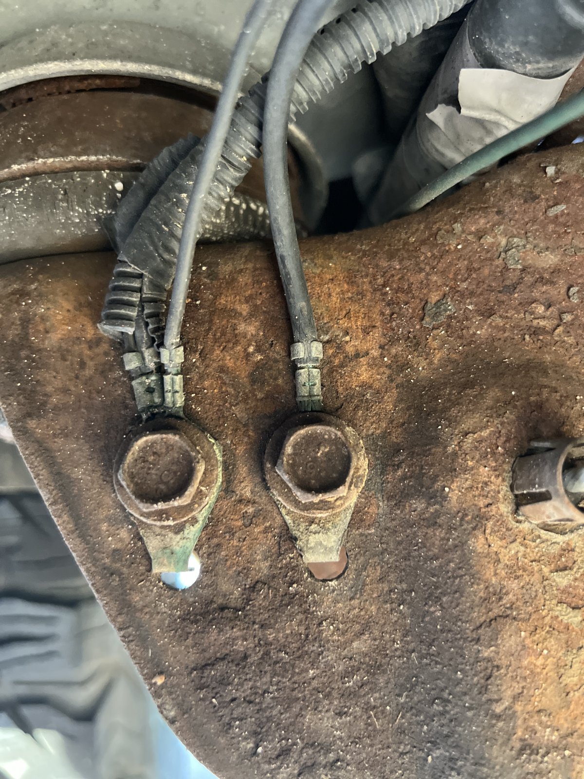

Had random heated seat activation on my 03 Z71. Heated seat gremlin would manifest itself after a rain.
Finally tracked it to the front frame ground on the drivers side.
Removed, cleaned, greased and tightened. No further issues.
Might be something worth checking…
to rule it out.

@SnowDrifter
to rule it out.
View attachment 471157View attachment 471158
No kidding?
That's wild. I'll definitely check that! Once uhh.... It's not absolutely pouring rain. Ack!
