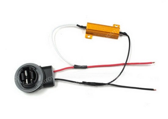

Would resistors solve the error problem? Can’t stand the incandescents, particularly in the reverse lights.

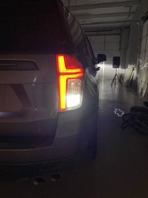

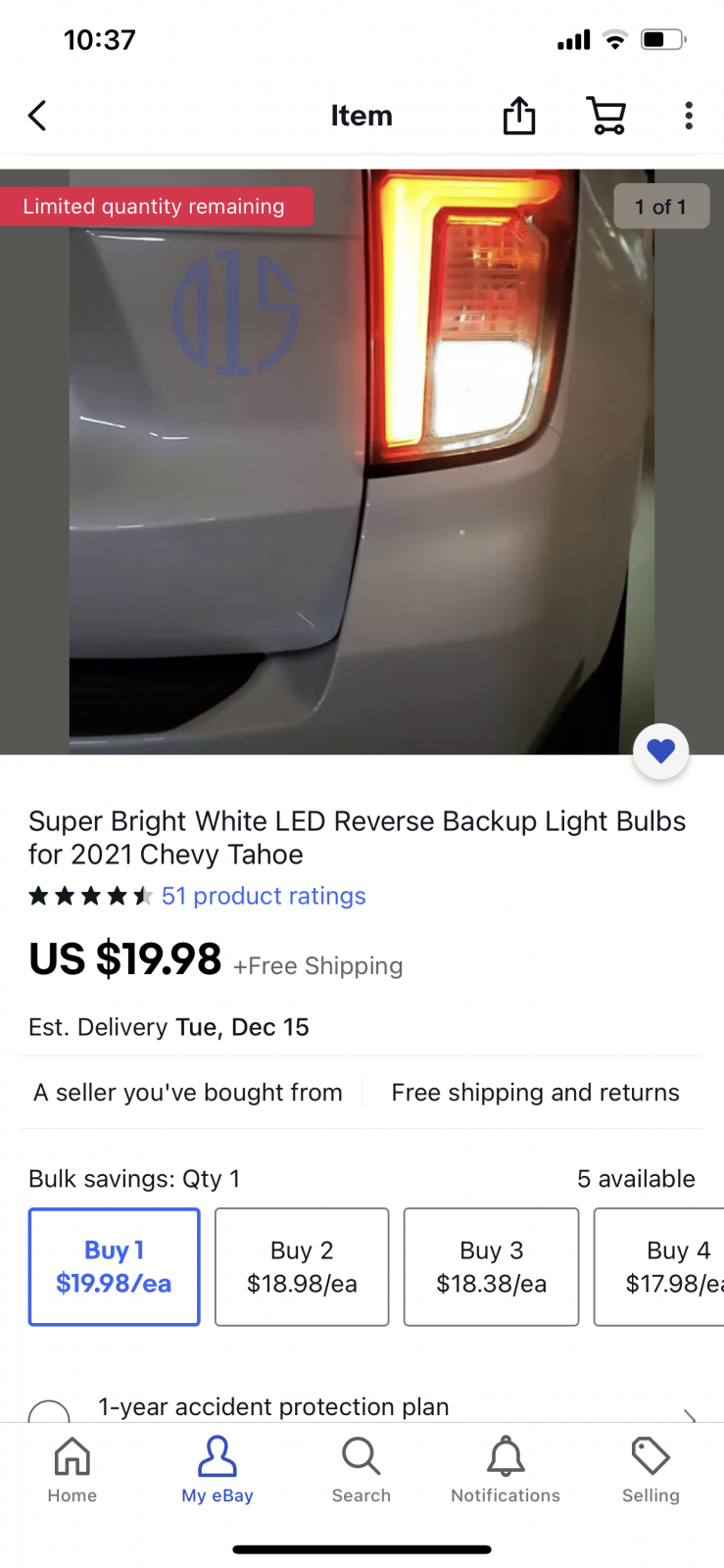

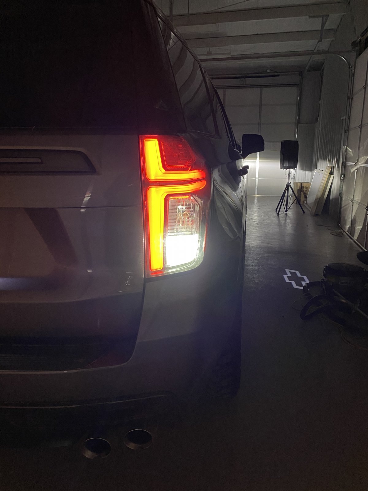

I bought some LED reverse lights off of eBay that included resistors that work! The first set resistors I tired must of been too small. The LEDs are pretty bright too.

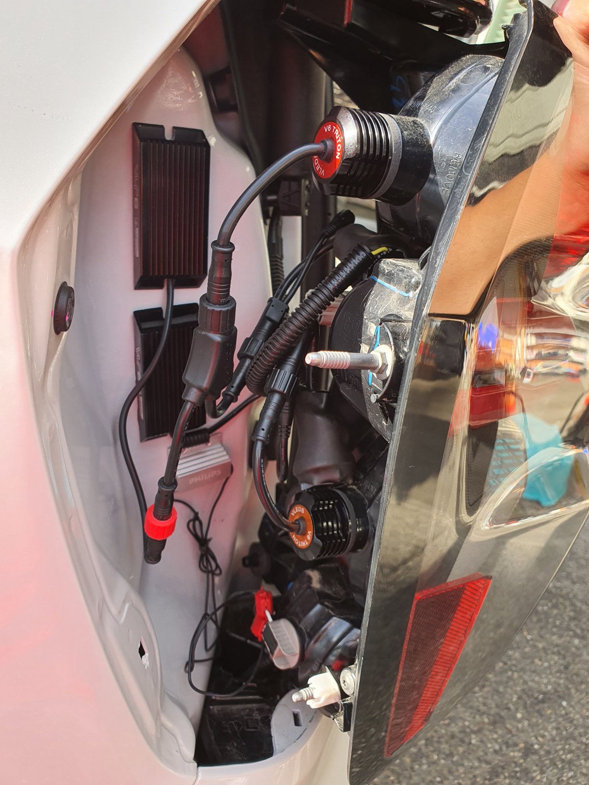

Pretty tight behind the tail light
assembly. where did you put the resistor?
There’s plenty of room. I just zipped tied the resistor to the wire loom. Reverse lights don’t stay on very long so there shouldn’t be a problem with them getting too hot.
