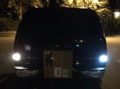

Brightness: Photo shows factory tail on driver side, new light on passenger side (not properly wired yet) for side by side comparison of 'running light'. The camera exposed for the street light, so this gives you a better idea of the comparison between the red tail lights.

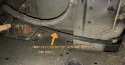

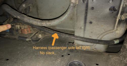

Wiring passenger side:

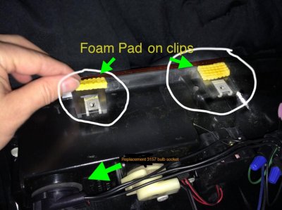

See photos for reference, In the last photo of this post... I'm pointing to where the harness plugs in ( above the exhaust pipe). As you can see there was no additional slack to be found. I bought a new three wire bulb socket from local auto supply store which had about 8 inches of wire, and spliced into harness giving me the additional length I needed. So now all the sockets fit into light fixture nice and snug.

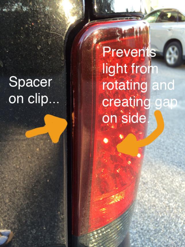

Fitment/gaps:
(See photo 2nd photo) I realized as I tightened the screws holding the light in place it created a yaw effect, rotating the light toward the back gate and away from the quarter panel… thus the big gap highlighted in the photo earlier in this post. (Did this on both lights). So, the easy fix was to add a spacer where the light made contact on the body panel the screws go through.
I added spacer on the screw clips (see first photo). I tried a few materials before settling on small pieces of a foam yoga matt. ( Not shown in photos is I just wrapped electrical tape around the foam to keep in place on the plastic.) I ended up using two pieces of foam on top 'clip' and one on the bottom clip.

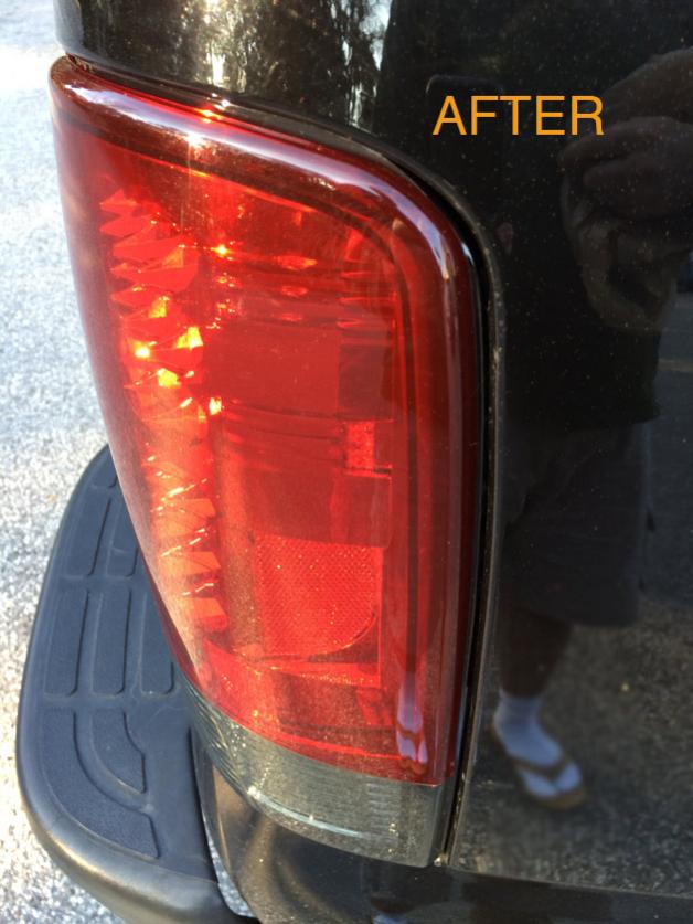

Simply set light into opening, lined up with guides into quarter panel, tightened screws and success! Notice the 'after' photo, there is NO GAP at all, where as before I could stick a pencil in the gap!
Now we are rocking! Thanks to everyone for feedback and ideas. I hope if someone else has these issues they'll find all this helpful and tell us about their experience.

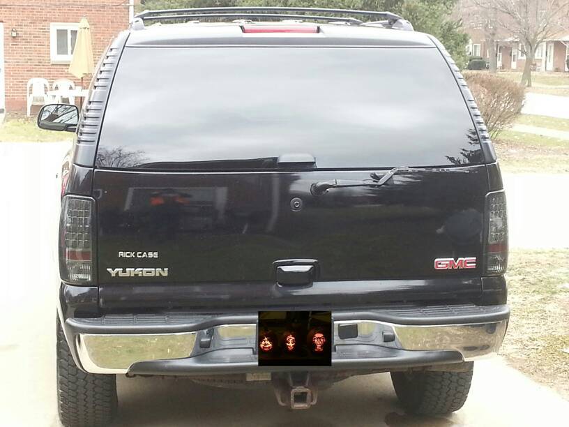

Just installed my smoked spider/sonar tails today that I got from Amazon, and also threw in some 3157 led reverse lights too. I didn't have any fitment issues, but I did run into the short wire(on both sides) problem. All I did to resolve that was firmly pull(not yank)the wires for the plugs and they gave me what I needed and then some.
No hyper flash either, don't know about cruise control yet but I'll update later,
Let me know what you think
