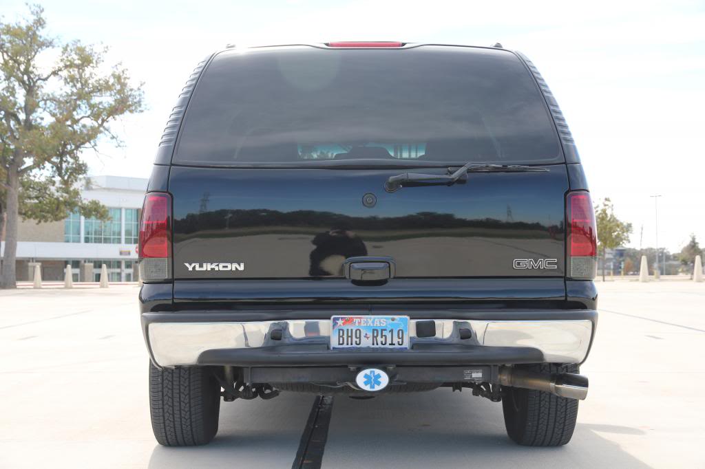

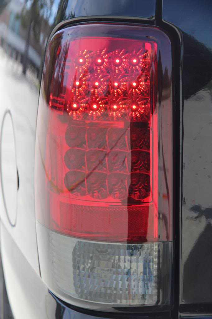

See my pics for the ones I bought. You will not have hyper flash as they have built in resistors. However you will have to put resistors on the brake light wires to not lose cruise control. I think mine were $130 ... and they are "spec d tuning" brand.

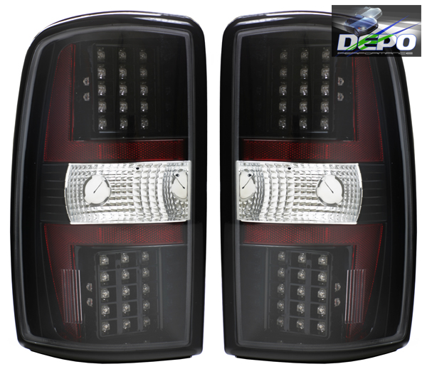

Has anyone bought or tried the Depo led tails for 01-06 tahoe? I'm pretty sure they come with built in resistors. I haven't seen alot of ppl with them on here, are they bad or just not up to ppl standards/liking?

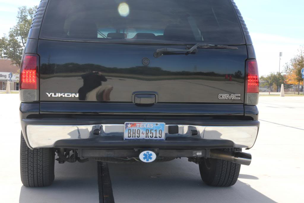

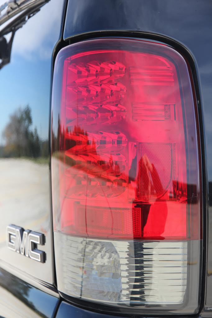

If its still worth anything to OP, here are the pics I was talking about, Top set of LEDs is brake, which has 2 stage for tail light and brake light. Second set is the blinker (hazards in pic). Didn't get one of reverse, but that is up to you as the bulb is not included. However, I suggest a BRIGHT LED. As in, on superbrightleds.com get the ones with 4 or 5 bulbs in relative brightness (believe over 140 lumens).
