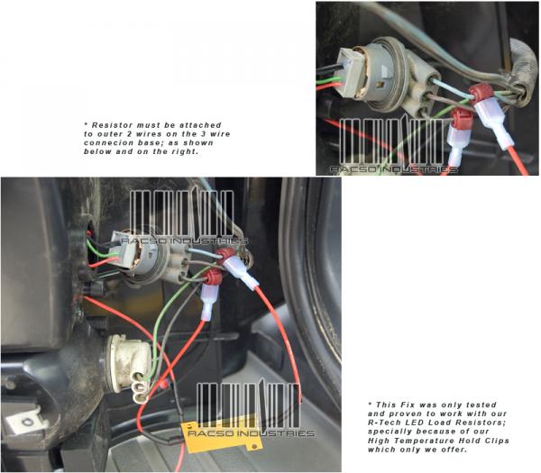

Ghost, HIDGUYS has agreed to send out resistor kits to customers who purchased these lights and are having the cruise control problem. The kit includes 1 resistor (for driver's side light) and solderless connectors. They emailed me an instruction sheet for the resister install and if you want, I can send it to you later today when I get home...or you can email them and I'm sure they'll email it to you as well.

As I understand it, both jem556 and ghostworks you have the red tail-lights and absrastic has the smoked tail-lights. If y'all have a shot of these lights in both colors from the rear in the daylight, it will help me decide which I'll order for my black hoe.
jem556 I'm curious as to what Hidguy's solution was concerning the resistor. In both previous cases where additional lights were added to the circuit, both instances were with the additional lamps in parallel (trailer lights, and additional brake lights under frame). If he recommends putting the resistor in series then you are creating a voltage divider circuit and the intensity of the LED bulbs will be dimmer. I suspect that his solution will be to put the resistor in parallel. Please advise and what size resistor.

As for the quick fix, I think its just a resistor pack that you plug in between the brake light and the harness on the driver side.

Here is the fix diagram sent to me by HIDGUY...
HIDGUY further stated that the resistor pak should be isolated from other wiring as it will get hot...

They didn't indicate the size resistor but it should be here tomorrow...maybe it will be marked and I can tell then.

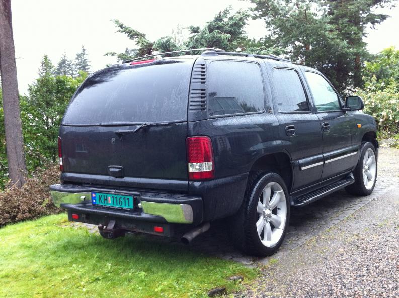

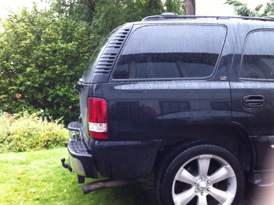

Here are two images with the lights installed

Thanks Ghostworks for the photos and the info from Hidguy.
Hello Abstrastic, do you have any daytime photos of your smoked tails as I'm curious as to how they will look on a dark vehicle?
TIA

Looks good!
Thanks :) I really like them, they are actually better looking than I expected. Hopefully I'll get the cruise control stuff sorted soon!

Yes, it is a 50W6RJ
I'm getting ready to leave town on vacation so it will be a week or so before I can install and try it out...
