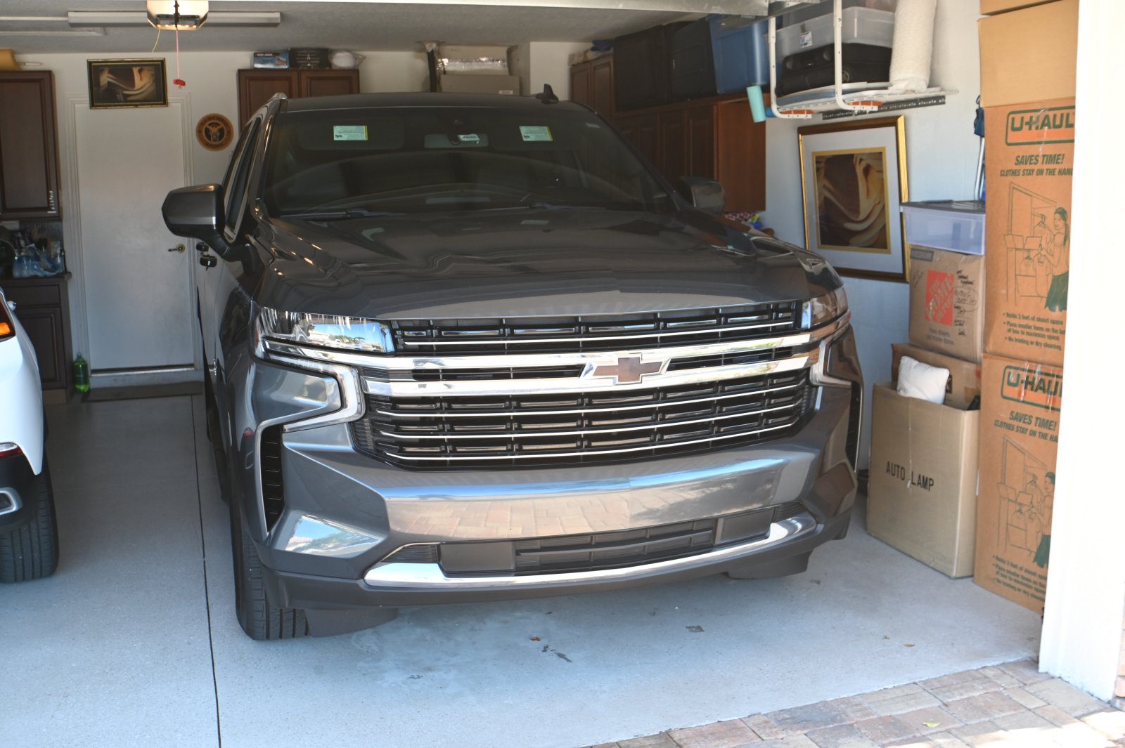

OK, my 21 Tahoe LT has the Led headlights.
I decided to adjust my headlights; they were too low. The passenger side adjusted fine with the adjuster... but the driver side would not. Turning the plastic "thingy" (Technical term!) resulted in it moving down regardless of which way I turned the white plastic thingy. So it was at its max height and would not go up to match the passenger side.
Anybody have this issue? Will I have to buy a replacement headlight and housing? Looks like the bumper will have to be removed to install a new assembly.

Is that area dented? Just wondering if it got pushed in so you it won’t adjust up. For the DFM I think since it can turn off any number of cylinders 1-7 it isn’t available to see like the previous AFM .

There was not damage, but the driver side headlight did drop to the bottom of the housing, complete disconnect from the adjuster mechanism. After more searching here, this problem seems to be quite common, after searching (headlight adjuster repair) I was able to remove the mechanism, apply liberal amount of epoxy and re-assemble. Seems to be holding after adjustments. Note... the warning of do not drop the adjuster mechanism!

OK, going back to the headlight adjuster issue. After two attempts with the epoxy, which has failed after time, I decided to do the other method used by several members.
I drilled a hole in the housing, cleaned up the excess old epoxy, and after drilling a pilot hole inserted a small screw being careful not to make contact with the black plastic
shaped ball that turns with the adjuster mechanism. The pics and descriptions from other members really helped with the process, and my thanks to all who contributed,
West 1, Tahoe Rob, New Guy, Bdbdzz and everyone else who posted info on this problem.
Too bad GM does not own up to this issue, and do the right thing.
