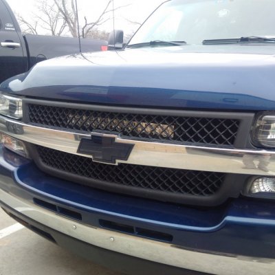

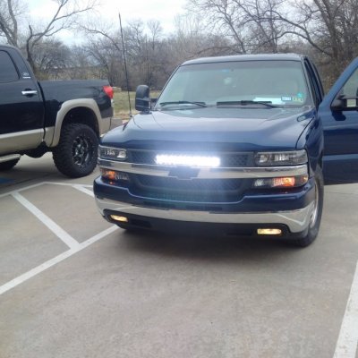

Just did this one today. Idk if you want one there but its a thought.

What size bar is that one and how did you mount it?
21in light bar and I just had some scrap metal laying around the shop I think it was 1in wide 1/8in thick and bolted the metal strap to the radiator support right above the trans cooler then bolted the light bar to the strap.
Exactly how I mounted mine... except I used 1" aluminum I bought from Home Depot. Fits perfect though, you could probably even go up to 30+", mine is 24".
Aluminum is probably better seeing as the radiator support is aluminum. Ill probably swap someday. Where are your switches?

Jut put a 24" behind the grill on mine...
EDIT: after driving with it on this morning in the dark, I need to adjust it a little. It's shooting downward just a tad bit too much. I want it upwards more, but may be blinding for oncoming traffic though.
How deep is the led bar behind grill? The heat sink on the back makes it look like they're almost too deep to fit, and is it better to get a curved one? What is the longest length bar you think will fit behind the grill? I know the ss grill insert probably allows deeper mounting than oem grill?
I wouldn't go any longer than a 21in. Curved probably wouldn't work the ones I've seen are too deep to fit behind the grill. Mine is a fairly snug fit.
I wanted to mount it in the lower section of the grill but the HD grille has a support plate that attaches behind the emblem and clips in just below the trans cooler, and I didn't want to modify that or take it off.
