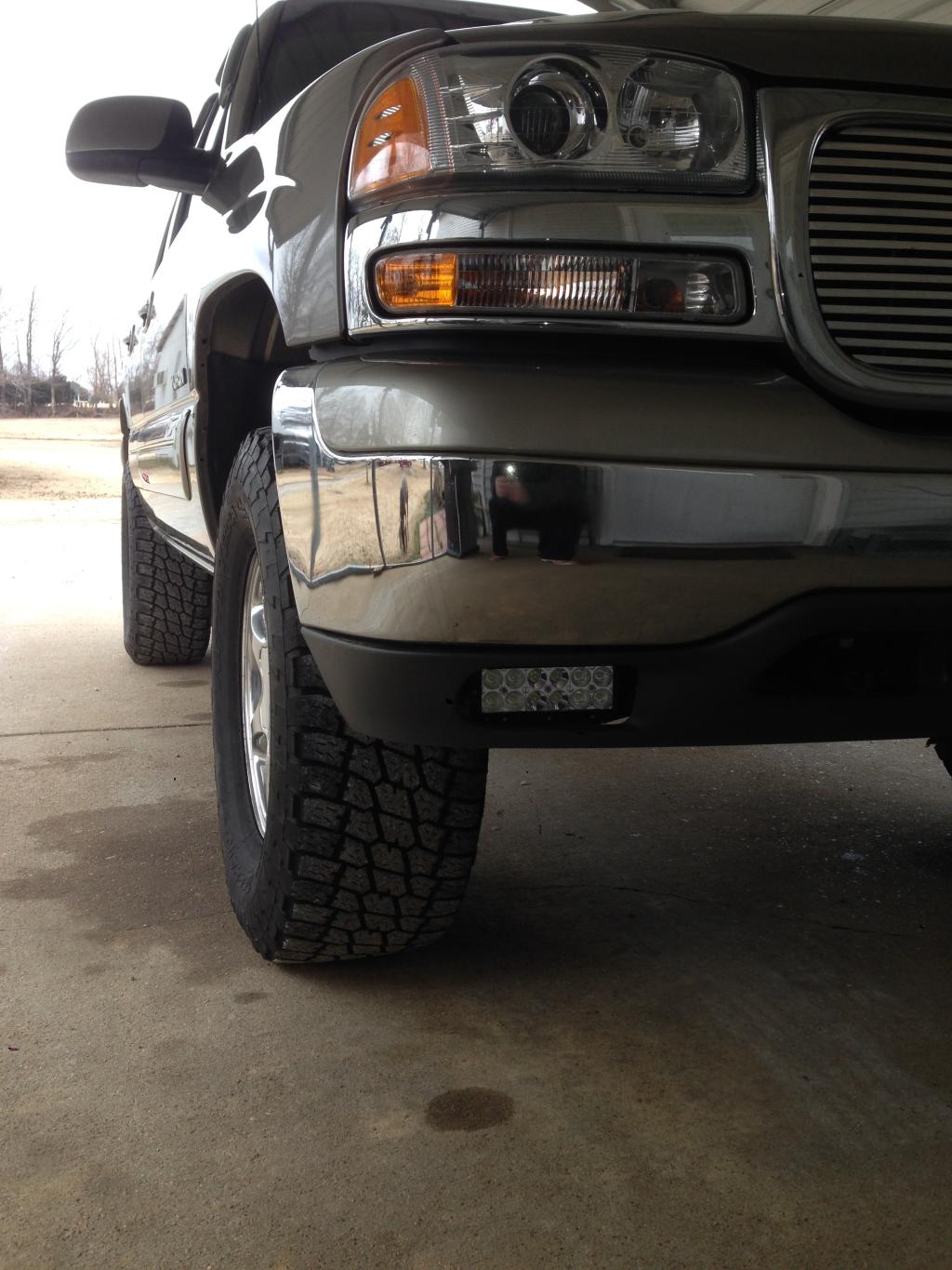

I don't run them all the time, only in conjunction with my high beams. And I originally wanted to do a double row, but I didn't want it to look crammed in there.

I got an 880 adapter, and used it to plug into the stock fog outlet. I used that plug as the trigger for a relay. I pulled positive power from the fuse block terminal through an inline 20a fuse, and negative from the stock ground bolt on the bumper next to the drivers side fog. Then I connected all the lights in series, soldered everything up, wrapped everything in black tubing and electrical tape, and ran it next to all the factory wiring up in the bumper.
I'll try to grab some pictures from underneath when I can.
EDIT: as far as turning them on, because the trigger for the relay is the stock wiring, the fog light button does it. But I've also done the HI-6 mod, so my high beams turn them on as well. And with the valence light, it's actually a HI-7 now, I suppose.

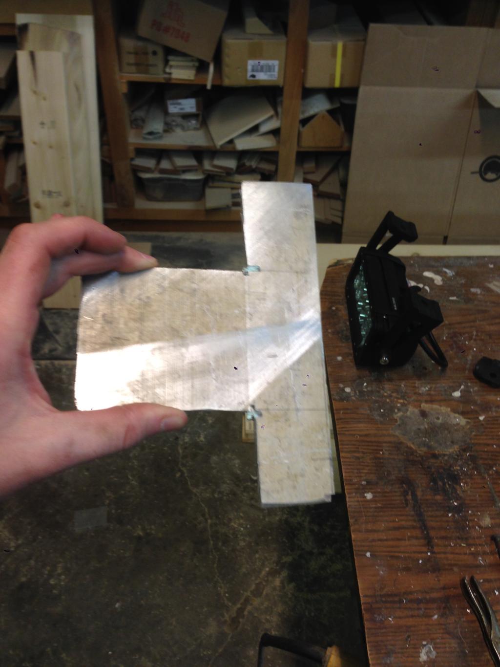

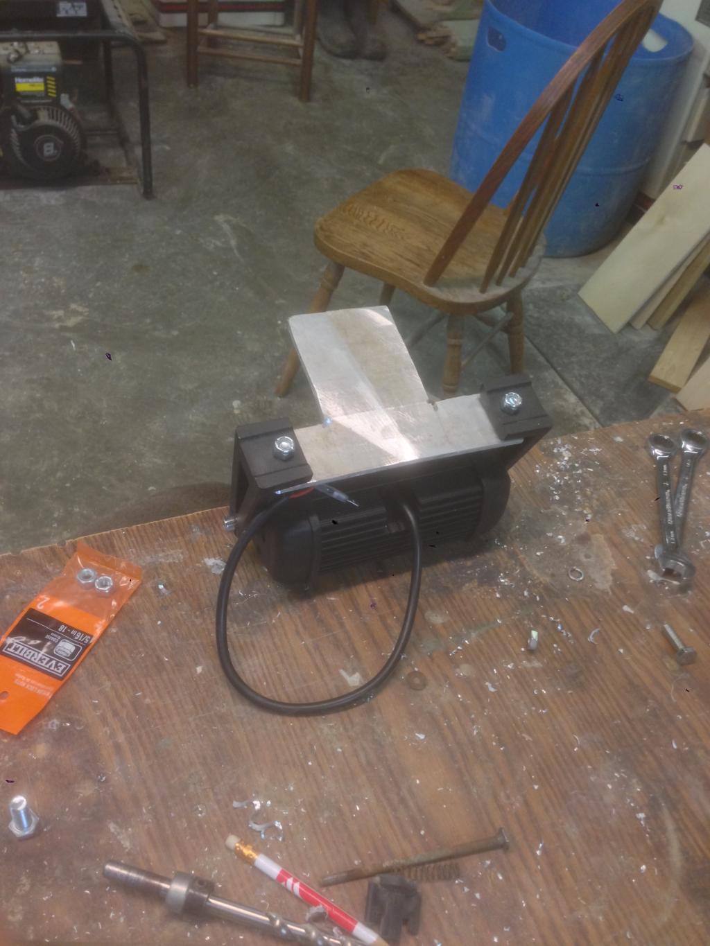

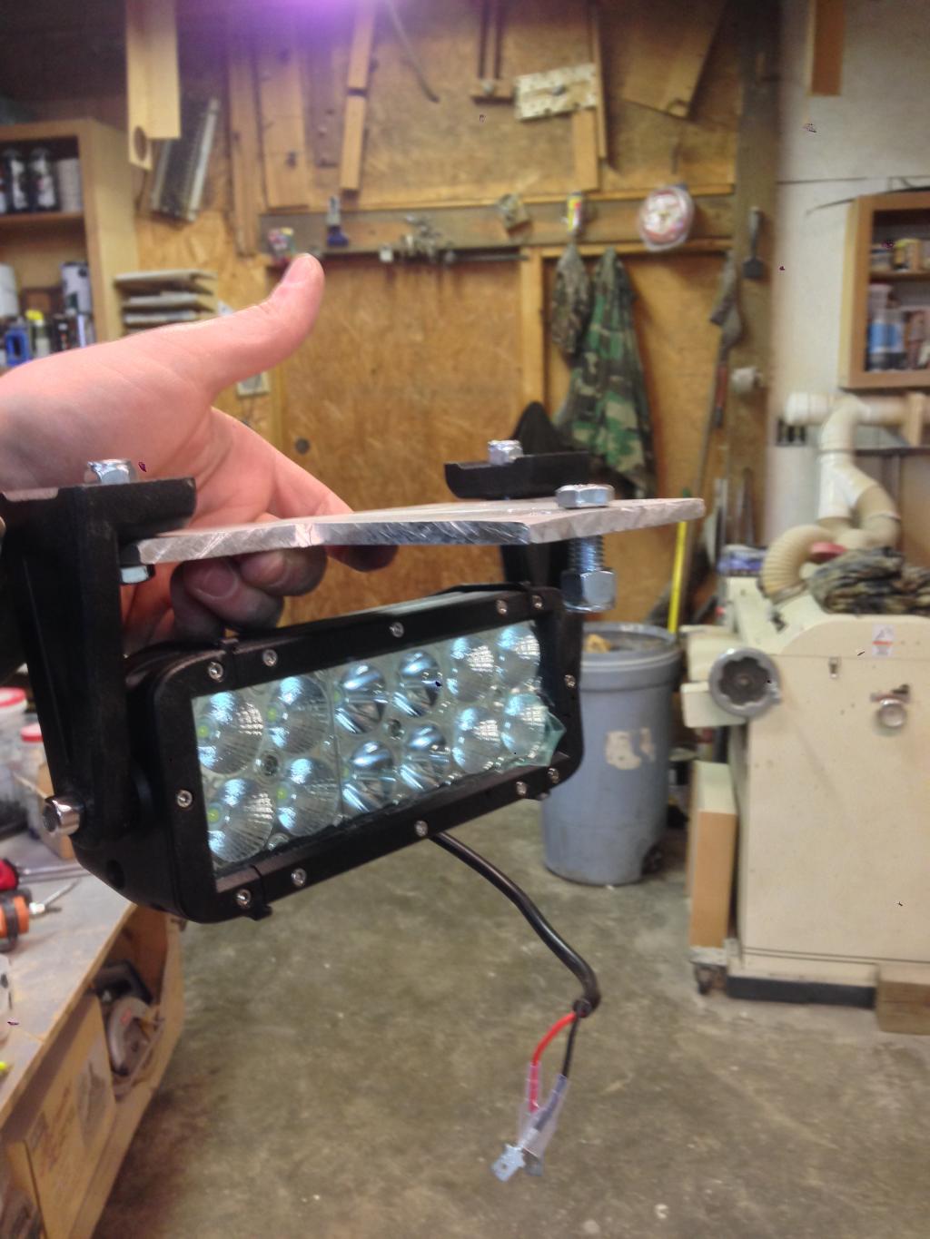

I made a T bracket 3in wide by 5in long
and heres a pic of it mounted

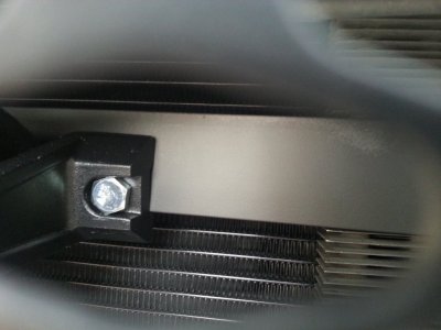

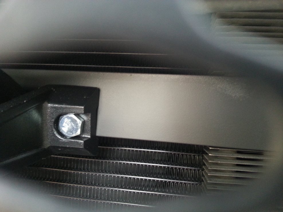

I bought a piece of aluminum bar at Home Depot, mounted that to the frame where the trans cooler is mounted. Then I just mounted the light bat to that. It sits just a hair below the center bar but not enough to where I want to cut it.
The adapters I ordered from Amazon, came in a set of 5, 10 total if you count male and female plugs separately.
My light bar fits right under the hood release.
This is the only pic I got after I mounted it. I'll try to take better ones if the weather permits. I need to put some adapters on my foglights anyways.

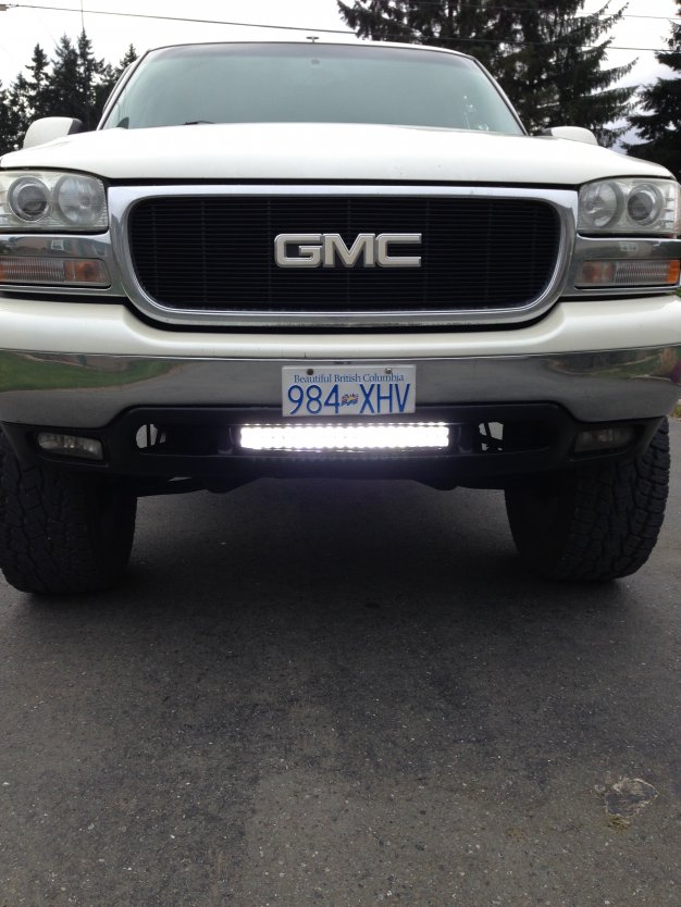

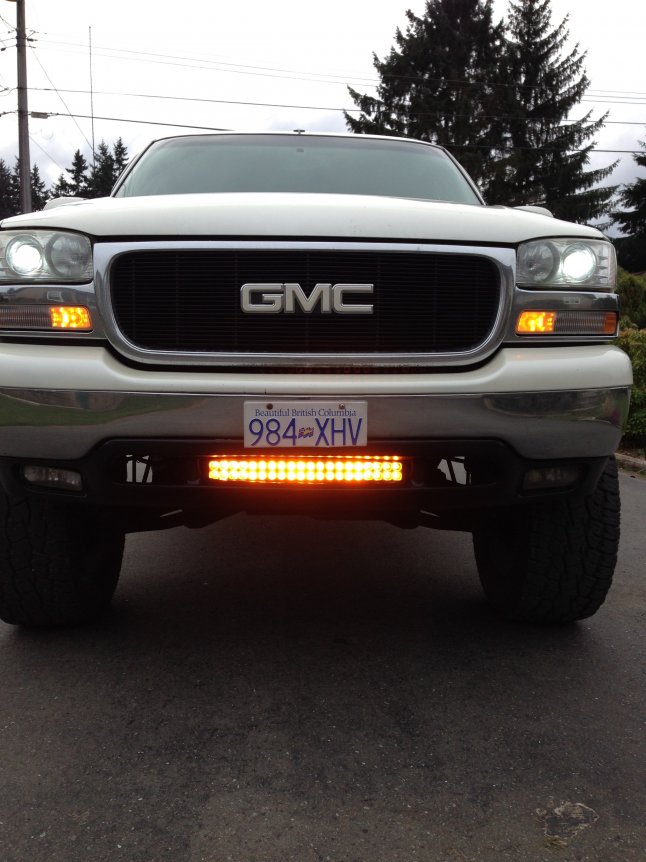

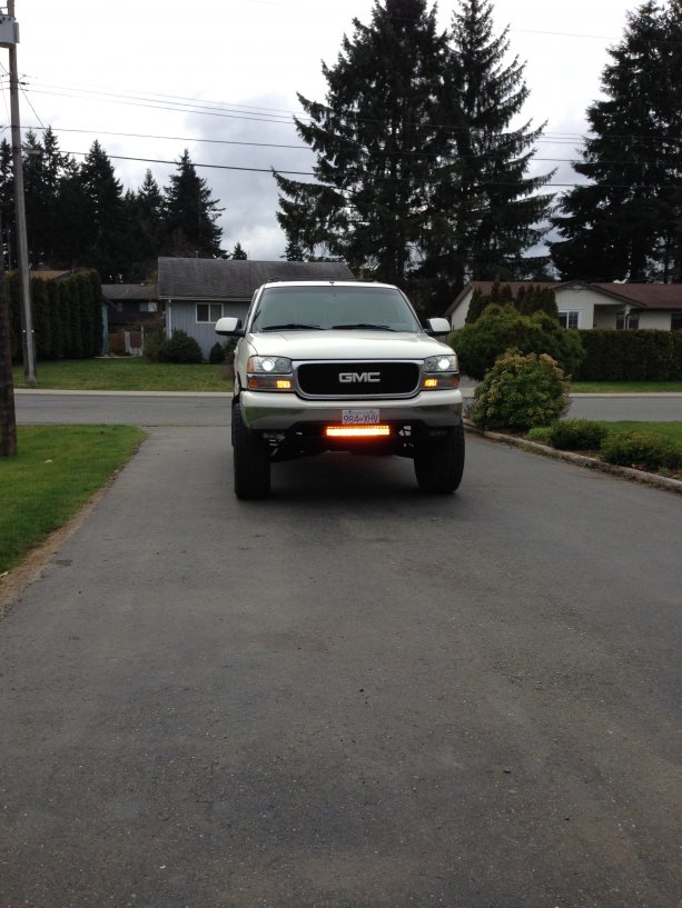

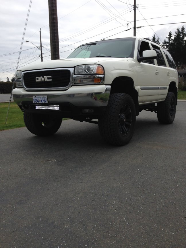

Finally got a pic with the led bar installed

Did you have to trim the lower valance at all? What type of bracket did you use to mount your bar? That looks like the same one I have and exactly where I want to mount it.
2003denali26
Jun 13, 2011
77
Campbell River, B.C, Canada
Yes I trimmed the valance, mounted it using two L brackets off the bottom of the bumper, take a look you will see two bolts on either side of the valance hole. also I trimmed just the bottom of the valance area made the hole bigger so the whole led bar could shine threw it.
Is that bar amber and white? I didn't know they made them with two tone diodes like that
Sent from my Galaxy Note 4 via Tapatalk for Android
2003denali26
Jun 13, 2011
77
Yeah, looks the same except the diode is dual. I bought it as a tester, the light bar is very cool. a switch for amber and a switch for white with a special dpdt switch. I am also looking at some osram 7" led bar's for the fogs now.
