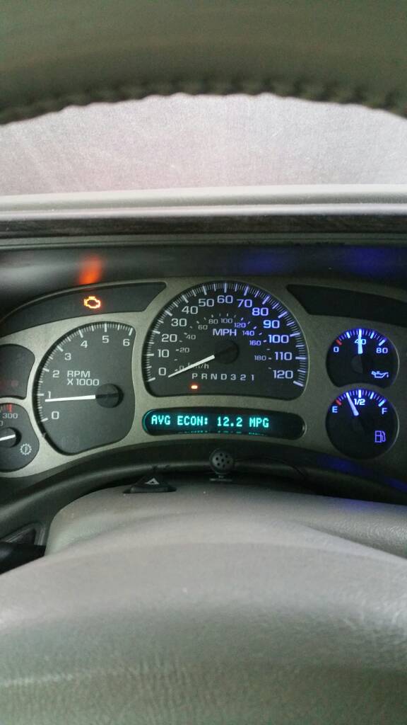

Did the LED mod for the cluster. Been over a year now. Some bulbs keep going out. I've replaced all the ones that go out. I still get 12+ V on the connector. Once in awhile driving one of them might flicker back on. Anyone been through this or have the same experience? I don't know if different leds will be better.

Yes I bent my metal tags towards the dash for better contact issue solved

I do I forgot what resistance bur they have been good it's only recently started finally got some pics of it going on off.

How long have they been in? Maybe they just need touched up again.

They been in for over a year. I took the old ones that were giving me trouble completely off and re did the less and resistors with one more worked. And most of the rest didn't. I still get 12v from it. Had the speedometer plugged in and the lights were turned on. I started moving them around to see if maybe the connection point was that it didn't seem to make a difference they wouldn't still just randomly flicker on and off.
