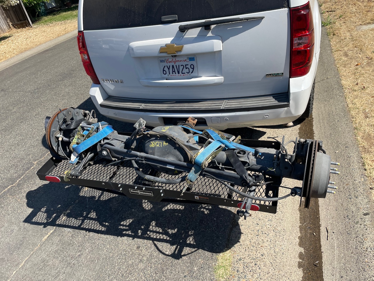

Looks like I will need a new cover seal as they probably cracked it open to drain the fluid. (I see a missing bolt in the picture)
But I will definately try and look for signs while there.
One of the reasons I want to go pick up instead of delivery in case something is bashed or bent etc.
The part is warrantied, so even if I find something wrong when I get back, I should be able to return/exchange it I suppose..
Here's hoping they allow for pickup.
They have the matching front axle, but it's listed at $940.. I thought front diff/axles would be cheaper, maybe not..

Looks good externally. I was mistaken, rear cover was not removed, and they paint pen'd a couple bolts, so im guessing still has factory fill. I will probaby put new fluid in, turn rotors and throw new pads on and send it. Looks like these little washers over a couple wheel studs.. Im thinking it maybe original brakes, and 62k miles maybe real. Ended up at $700 after tax and credit card fee. So far the only issue I could find was the ebrake boot is a torn up on one side..
