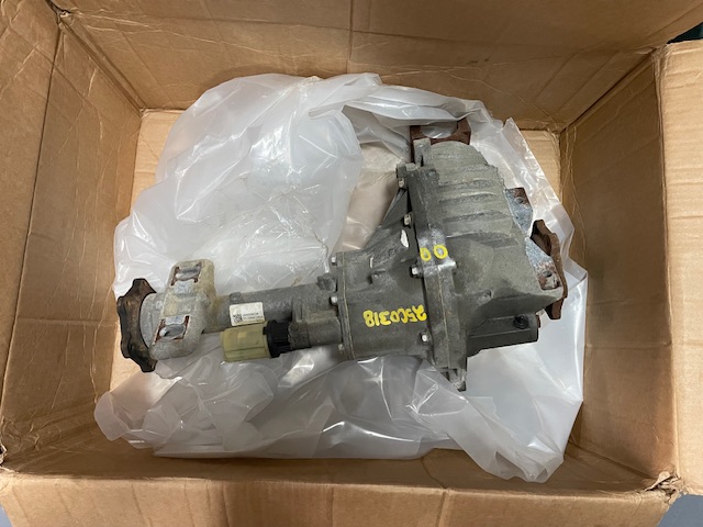

The replacement front diff is here. Turning things by hand feels smooth. Out of a 102k mile sierra pickup.
Maybe get new diff mounts and fluid.. Guess I better start pulling the old one out.

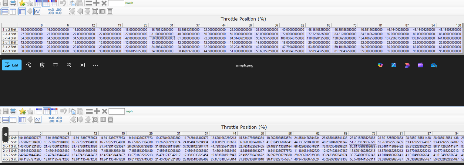

Have been driving around with different ratios (in 2WD!) and with updated gearing tune.
The factory tunes are near identical except 3.08 shift speeds are mostly multiplied by 0.900 for the 3.42 shift speeds.
Looking at factory tunes, it seems they started with the 3.42 tune and were working in km/h.
3.42 tune below with km/h on top and mph below.

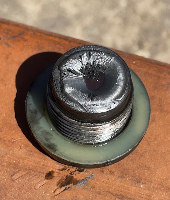

My rear axle was out of an Escalade AWD. (that really was 62k miles at auction). I ended up pumping the old fluid out of the fill hole.
Pumped out about 2.5 quarts and pumped in 2.75 qts of Valvoline synthetic 75-90.
Magnet didn't look great, I think my 220k mile 10bolt magnet looked a little better.
My 220k mile axle had diff fluid checked around 50k, quite possibly the magnet was wiped clean.
This 62k axle may have not had any service yet.
The metal didn't start standing up until I ran my finger over the metallic sludge.

That's just breaking in. As long as she's quiet, leave it.
My front differential mounts were toast and she felt good after replacing them.
