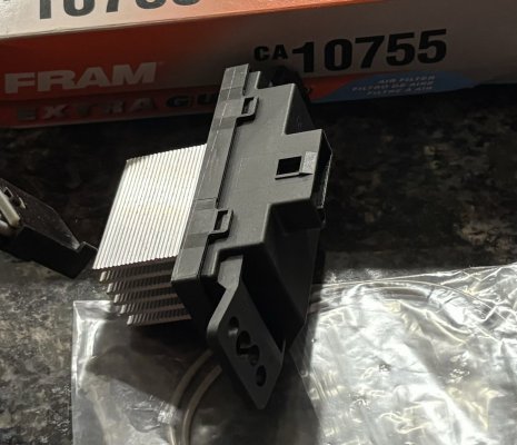

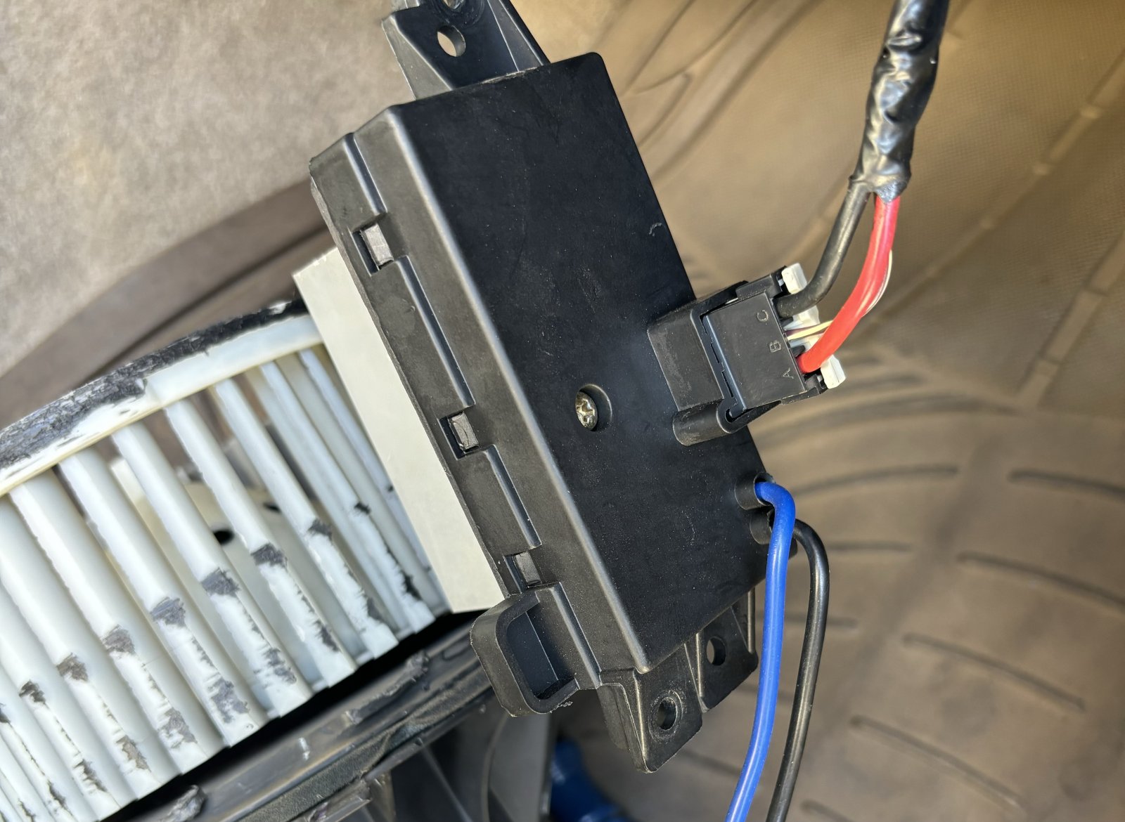

Did yours have a wire coming from the resistor to the motor?
current
and replacement below
current
Yes. Mine looked just like yours.
The new resistor actually has a female plug for the motor connector (I also had replaced the motor a few months ago with TYC 700164).

Sorry, I’m a little slow
currently, harness to resistor, which then has a wire to motor
what’s the new order? I see a female port in the resistor(5 prong) and the blower motor (which has a 2npromg connection)

Oh, I see. Sorry, I need to clarify: So my resistor came with wiring harness that plugged into longer connection. The black, red, and purple got spliced into the under dash harness (cut off the old connector). The other 2 wires coming out of the wide connector I think had a female plug there the blower motor connected. It came with clear instructions.
You resistor it sounds like didn't come with this harness? No instructions either? What resistor did you buy?
