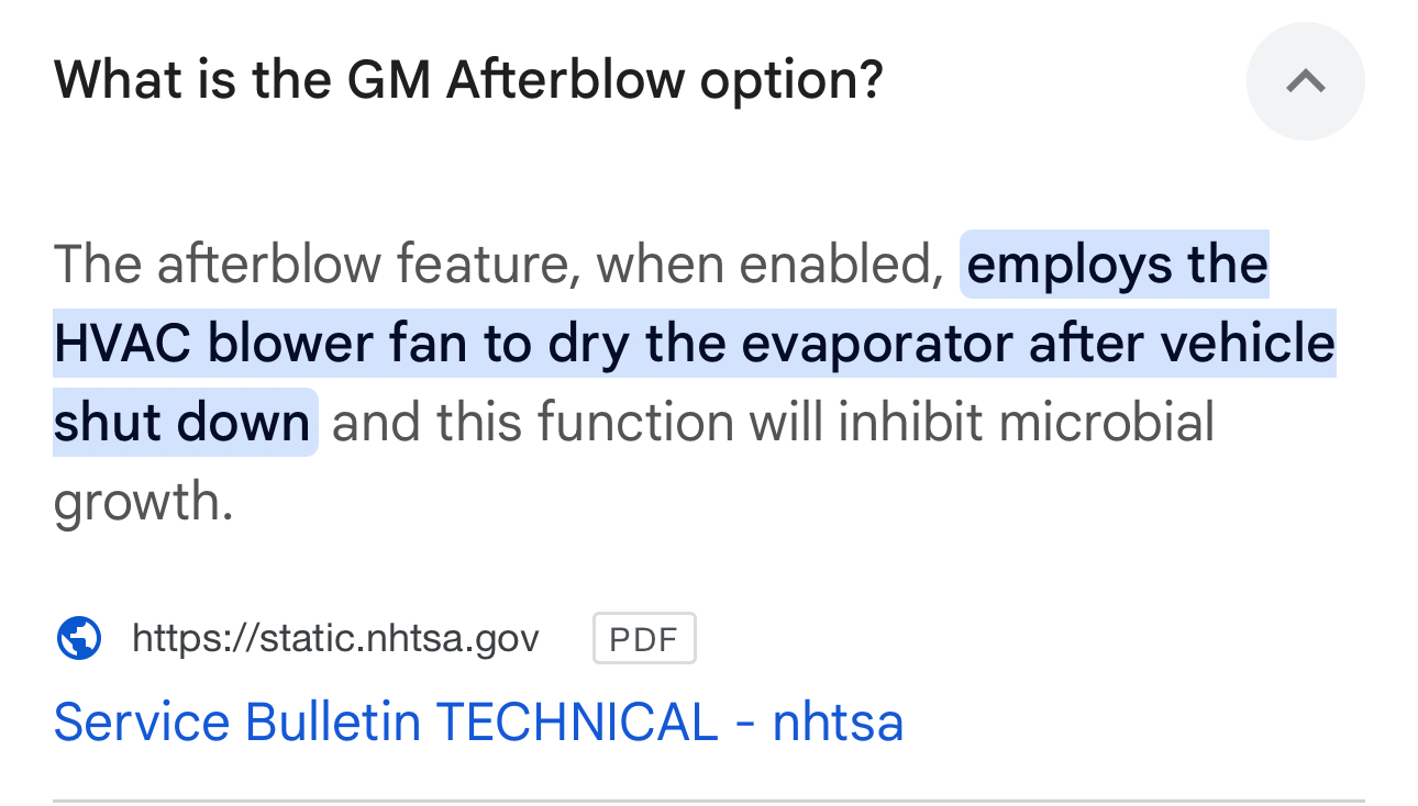

Go back out after 10-15 minutes and see if it’s off. There is something programmed in to keep the blower running to dry out the airbox so mold doesn’t form it’s called afterblow or something. You can take it to dealer to shut that feature off but it may have been turned on because the previous owner was getting a moldy smell

Damn... I had no idea... I only bought the Tahoe few months ago, and didn't know that was a thing. I'll throw the fuse back in it and check, but I don't think that's it due to the fan speed not changing when I manually adjusted it. That's good info though. Thanks
