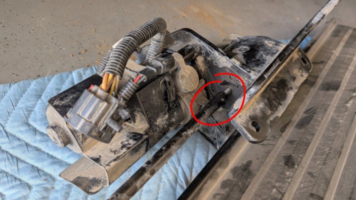

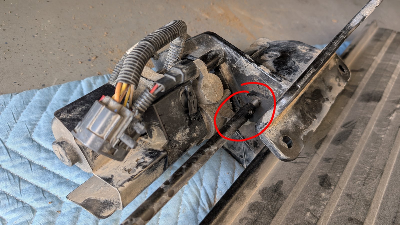

I believe my passenger side running board motor needs to be replaced but I'm having trouble removing the motor from the rod which connects it to the rear bracket. I need to somehow extend the bracket that the motor is mounted on so the screw is accessible. See pics.

I think the motor is on the left side of your photo (behind the electrical connector). It looks like one of screws is visible in your picture. I have amp power steps and have pulled the motors to lubricate them, couple screws and they pull right out. Mine do not have that rod, I assume it sends torque to the other hinge; mine only powers the forward hinge.

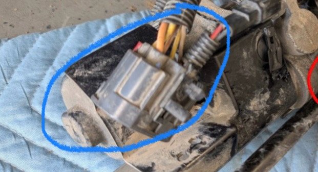

Not sure if we’re on the same page. Can you pop the motor out to see if it works? If so, something is binding in the gearbox.
In your picture I cant see which screw you mentioned is blocked, but what looks like the motor is circled in blue
