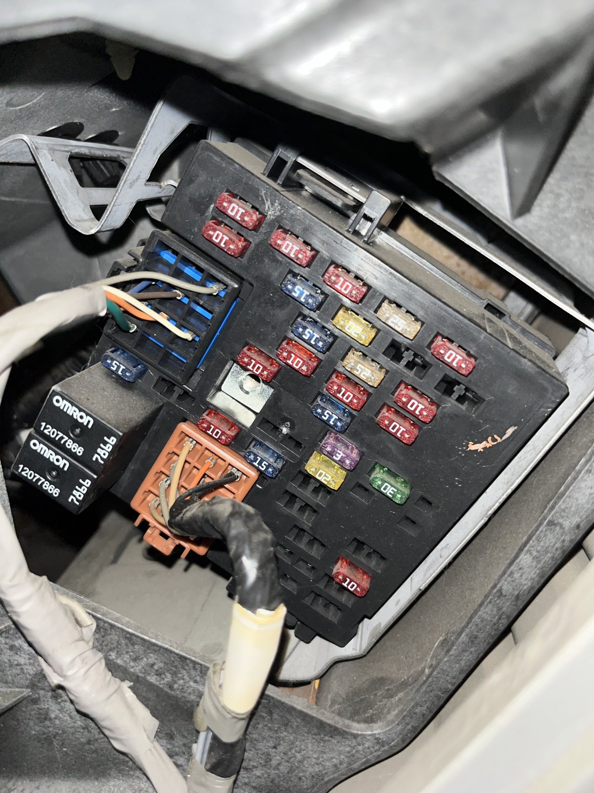

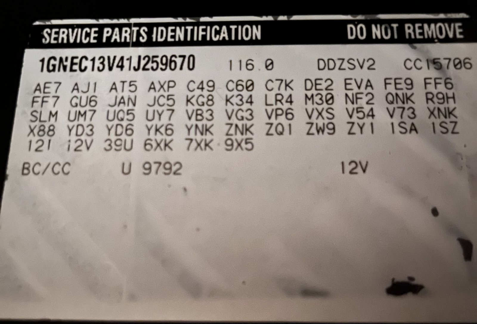

I can’t get the rig to go into the “Program” mode to program the fob.
I don’t see AU0 on the RPO sticker.
Here is a photo of the RPO sticker as well a the drivers side fuse block.
From what I see, I don’t think it’s equipped with Keyless Entry.

Decoded the RPO tag.
AE7 SEAT,FRT SPLIT,EASY ENTRY
AJ1 GLASS,DEEP TINT(REAR SIDE WINDOWS AND REAR DOOR WINDOW)
AXP VIN IDENT POSITION, MULTI- PURPOSE VEHICLE
C49 DEFOGGER,REAR WINDOW,ELECTRIC
C60 AIR CONDITIONER,FRONT,MANUAL CONTROLS
C7K GVW RATING 6500 LBS
DE2 MIRROR,OUTSIDE,LH & RH,DIRECT CONTROL,FOLDING,PAINTED
EVA TEST DVT, EVAP EMISSION REQUIREMENT
FE9 FEDERAL EMISSION CERTIFICATION
FF6 ARM,TORSION BAR SPRING ADJUST,LH
FF7 ARM,TORSION BAR SPRING ADJUST,RH
GU6 AXLE,REAR,3.42 RATIO
JAN PLANT CODE - JANESVILLE, WI, BOC
JC5 BRAKE VAC POWER, 4 WHL DISC, 7,200 LBS
KG8 GENERATOR 130 AMP
K34 CRUISE CONTROL,AUTOMATIC,ELECTRONIC
LR4 ENGINE GAS, 8 CYL, 4.8L, MFI
M30 TRANSMISSION,AUTOMATIC 4 SPEED,4L60E,ELECTRONIC
NF2 EMISSION SYSTEM,FEDERAL,TIER 1
QNK TIRE ALL P245/75R16 BW R/PE ST TL ALS 109S
R9H
SLM
UM7 RADIO,AM/FM STEREO,ETR,CLOCK
UQ5 SPEAKER SYSTEM,4,DUAL FRONT DOOR MOUNTED,DUAL EXTENDED RANGE QUARTER MOUNTED
UY7 TRAILER WIRING,7 WIRE,2 LEAD FRONT HARNESS,5 LEAD REAR HARNESS
VB3 BUMPER,REAR STEP,INCLUDES IMPACT STRIP(CHROME)
VG3 STRIP,FRONT BUMPER IMPACT
VP6 NOISE LEVEL CONTROL
VXS
V54 CARRIER,ROOF LUGGAGE(PAINTED)
V73 VEHICLE STATEMENT - US/CANADA
XNK TIRE FRONT P245/75R16 BW R/PE ST TL ALS 109S
X88 MARKET BRAND CHEVROLET
YD3 AXLE FRONT (BASE EQUIP) FOR SCHEDULING GVW PLATE
YD6 SPRING,REAR(BASE EQUIPMENT)
YNK TIRE REAR P245/75R16 BW R/PE ST TL ALS 109S
ZNK TIRE SPARE P245/75R16 BW R/PE ST TL ALS 109S
ZQ1 CHASSIS PACKAGE SMOOTH RIDE
ZW9 BASE BODY OR CHASSIS
ZY1 COLOR COMBINATION SOLID
1SA SALES PACKAGE
1SZ PACKAGE OPTION
12I INTERIOR TRIM GRAPHITE
12V TRIM COMBINATION VINYL, GRAPHITE (V) (99)
39U EXTERIOR COLOR,PRIMARY,BLUE METALLIC
6XK SPRING COMPTR SELECT FRT LH
7XK COMPONENT FRT RH COMPUTER SEL SUSP (7XK)
9X5 FRONT HIGH BACK BUCKET SEAT(CLOTH TRIM)

Given that it doesn’t have the RPO code for keyless entry, AU0, and no fobs were supplied upon purchase directly off a Chevrolet dealership lot, I am pretty much certain that this rig was/is not equipped with keyless entry.
I will be pulling the gage cluster out at some point and will look to see if the module is there or not.
